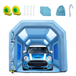

I've never used one or heard of it.
But 10 feet would not be enough for me to walk around a car with a spray gun comfortably.

Yes, that size would be small for me too. I just linked what came up first. They have much bigger sizes...

On the Vevor website. What I wonder about is how the solvents used to cut the spray paint would impact the plastic.

It seems that booth would be nice for the money and apparently impervious to chemicals, thinners, etc.

Being of Chinese manufacture, compatibility with various solvents is suspect and looking at it on the Vevor website, I see nothing in the blurb about compatibility with anything at all. Be a real shame to spray a vehicle inside and have it 'melt down' on the vehicle. Sounds to me like a sticky mess...lol
Cheap alternatives often aren't the best solutions.

Also I see where reviews are pretty high from people who have used one, 4.5☆ or so.

I agree with the guy's opinion: for professional use spraying many cars, buy a $10K+++ spray booth. For a few cars it's a good deal.

A vendor at work uses one. They typically do 1 or 2 panels on a vehicle and a lot of bumpers. Depending on the area he is working on he will offset the car in the booth to have more working room.
I am surprised how durable this thing is. It stays on site but it is inflated and deflated every day. After 14 months of daily use, there is no damage from deteriorating.
In the image, it was under an awning. It was there for 2 months, then was moved into a bay in the shop. So it is not in the weather.
Biggest advice I can give is use sandbags in the corners for breeze support, and make sure you use a dedicated circuit that is in good condition for the inflation fan.
If the circuit overheats and/or trips, the booth will deflate and lay on your fresh paint.
