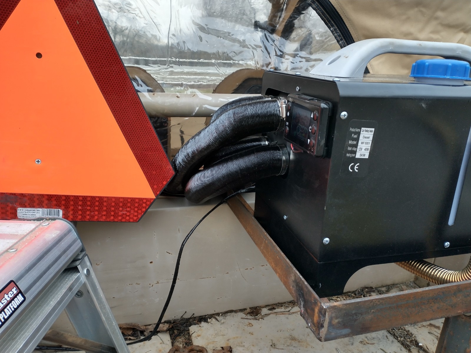

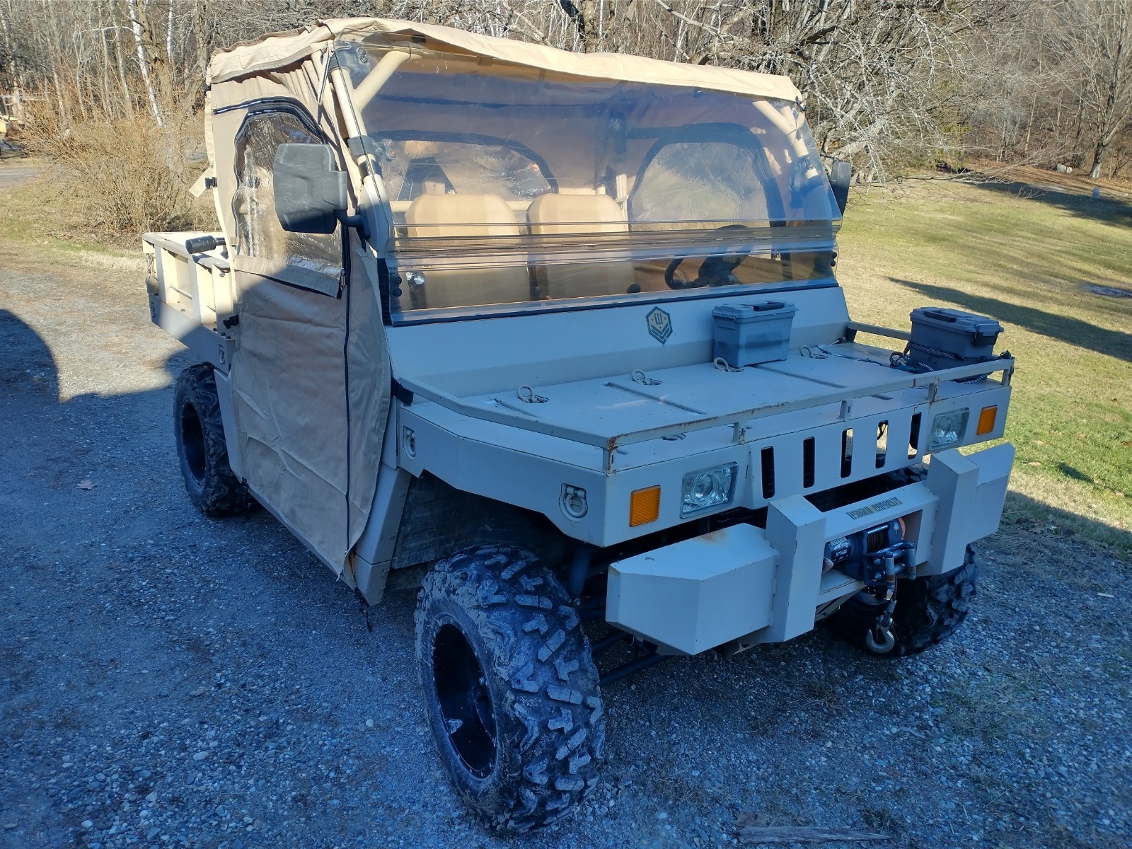

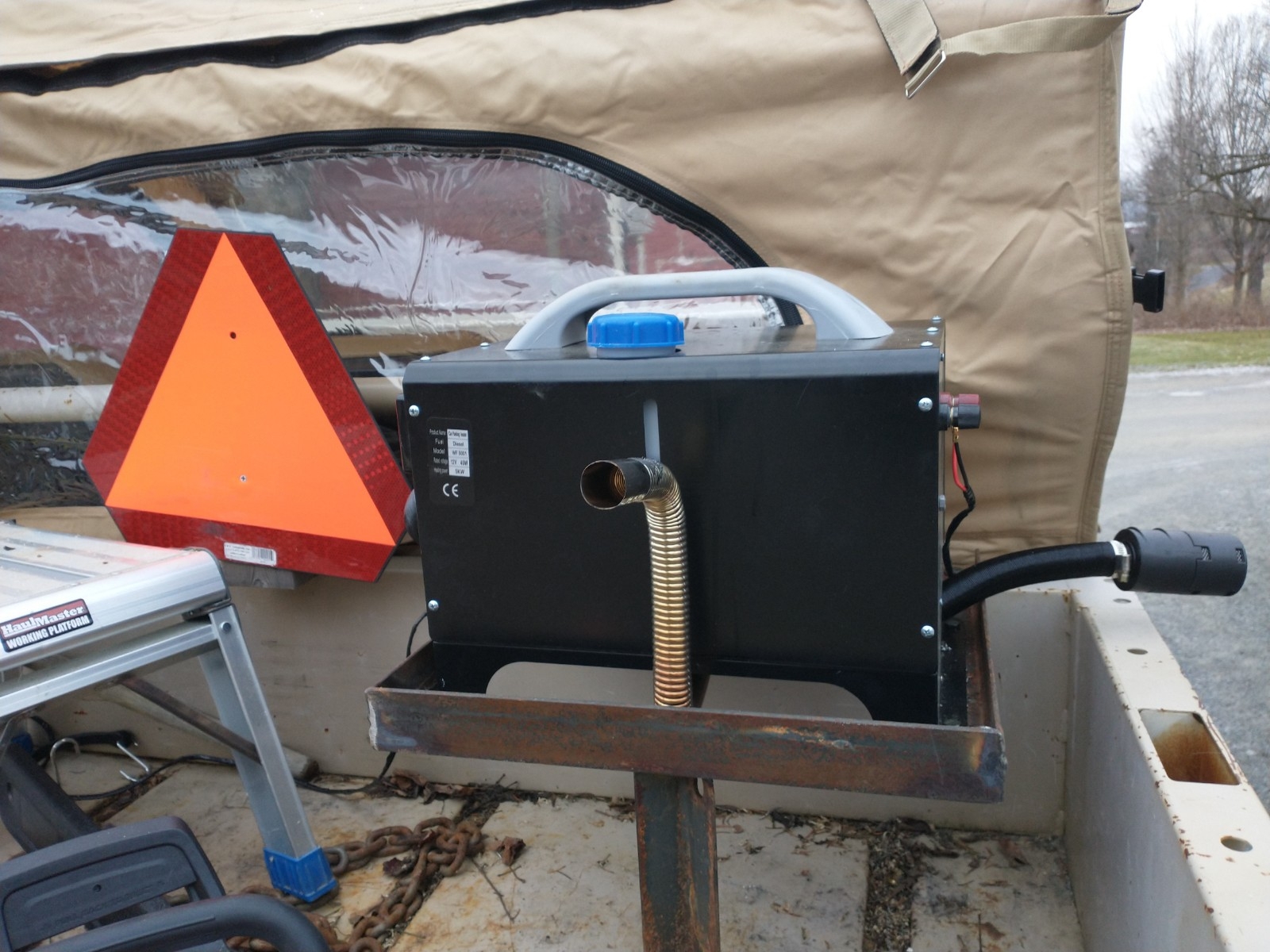

I actually have one that I used in my SxS last winter.
My nephew was doing some logging by himself last year so one of my brothers or myself would go up in the woods to keep him company and just in case. The heater would keep that cab area nice and toasty warm even with a window open .
I never got the controller really figured out but it was working and I could raise and lower the output.
I used 4 flexible ducts to distribute the heat, two up to each side of the windshield
and 2 down to the footwells on each side.
