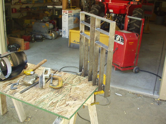

dbelisle: We must have bought the same welder at about the same time, I got mine in '67 and still use it regularly. See attached pic of the little Lincoln at work in my shop. Its AC only but sure does a good job on the mostly heavy things I weld.
The trick I've found is to keep the rods fresh and dry. I invested in an air tight container for my rods a few years back and have since seen a huge difference in bead quality and appearance. I also only buy small quantities so as not to have em laying around too long.
