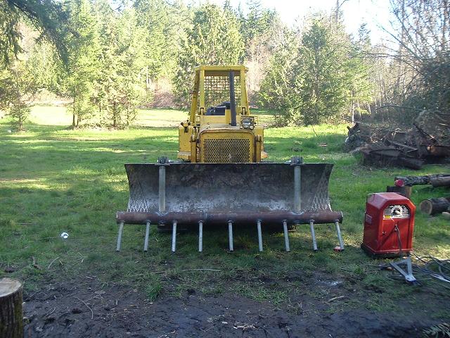

Hey that's my buzz-box! Or at least there must be about a zillion of them out there that all look the same. Years ago I took some EMT conduit and bent an inverted U for a handy handle on mine. Sure saves the old back when you need to move it around the barn to use it.
   / inexpensive 220v stick welder #24
Hey, that's my buzz box too. I have a cart but no handle. It is a heavy bugger to lift up into the pickup bed. Mine was free from a dead guy's garage, with the widow's blessing of course.
