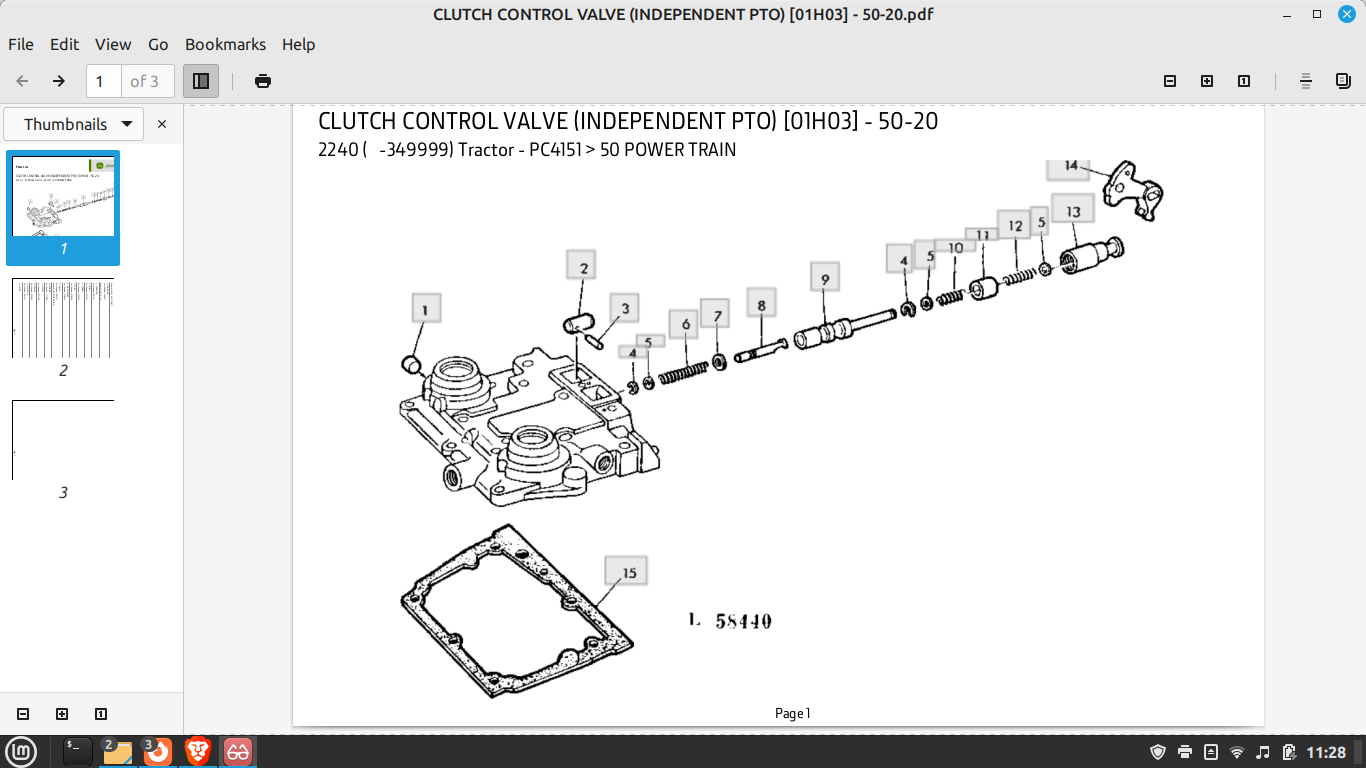

/ Independent PTO problem, JD 2240, 1978
My pressure gauge does not adapt down to the test port size and local hydraulic suppliers do not have an adapter. However, the port for testing pressure to clutch does have some oil pressure at idle, but it has oil when it is suppose to be off, too. What would you inspect for a failure in the diagram?

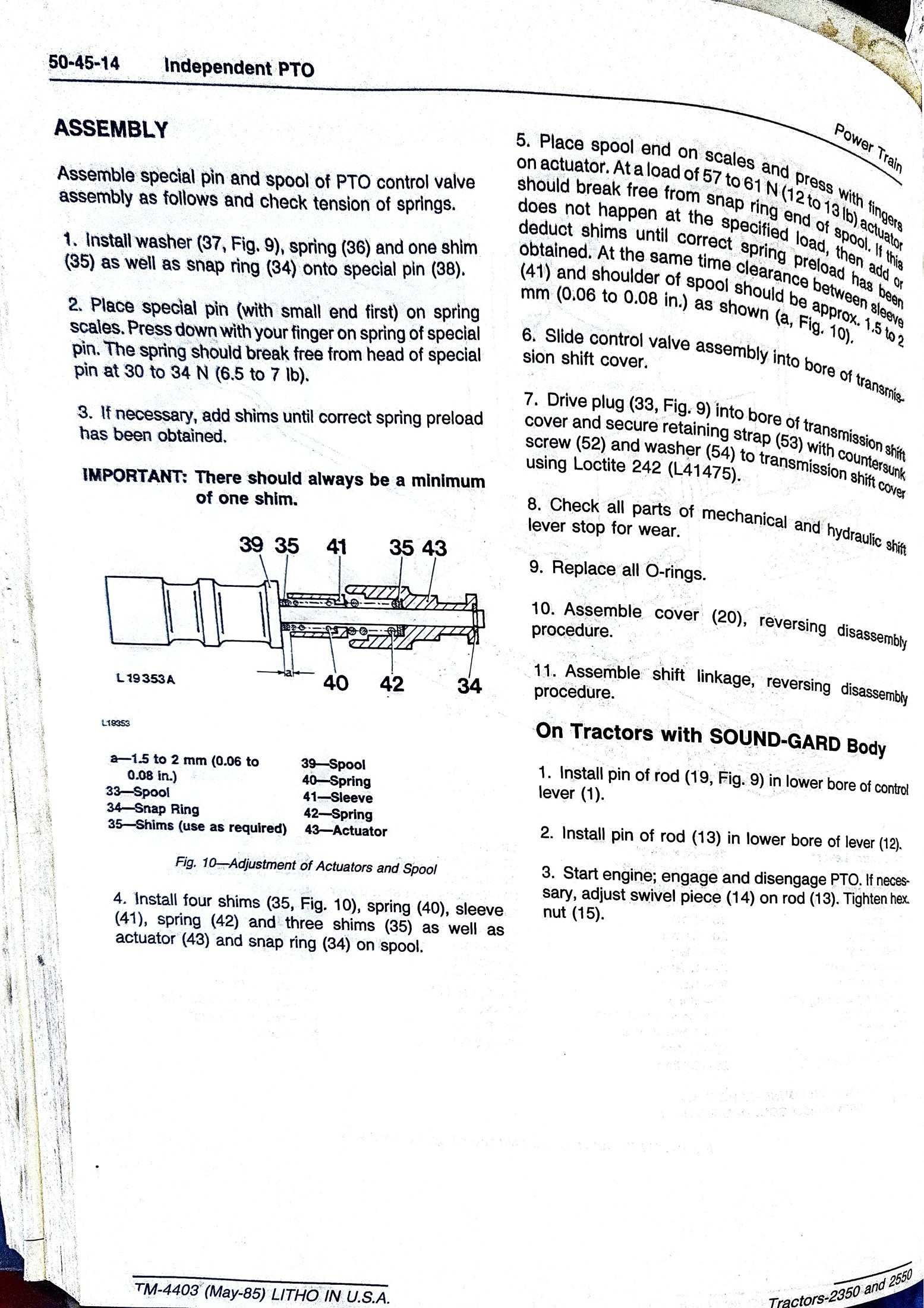

/ Independent PTO problem, JD 2240, 1978 #9
I suspect one of the gaskets as you say it quit working all of a sudden.
I attached pages from the 50 series PTO which is pretty much the same
\I suspect one of the gaskets as you say it quit working all of a sudden.
I really appreciate your assistance and trouble. I have a 2240 Technical Manual and it shows a similar spool diagram. In other action, I managed to borrow a gauge that I was able to connect to the clutch and brake testing ports at the gear shift levers. However, the brake testing port has need of a special 90 degree fitting to test it in the pressure (on) position because of the actuator arm in the way. I was able to test in the off position at 2100 rpm after warm-up and the clutch port also in both on and off. The result was that the clutch port test 0 pressure in the off position and in spec (125-135 psi) in the on position. The brake port tested 0 pressure in the off position. I do know that there is pressure but not how much in the brake on position. The manual says to use 2 gauges to test that no pressure bleeds between the two positions when the actuator is moved from active to inactive. But I don't have the ability to test that at this time. So I believe that the transmission pump is okay at least. With this new information are you still leaning toward the valve failure and sending pressure to both?
