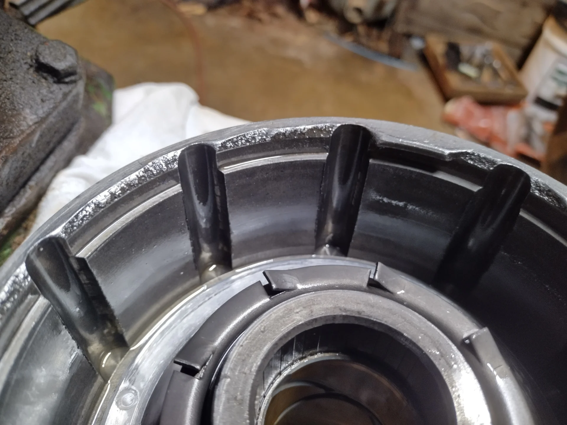

To close out this query: The symptoms are the result of the PTO clutch in the transmission coming apart. The pressure oil apparently was causing the clutch (while still in the hub) to lock up the PTO shaft.

I got back on it. The clutch drum's lip is destroyed so that the circlip holding in the discs came loose. Do you know where I can get a good used one?

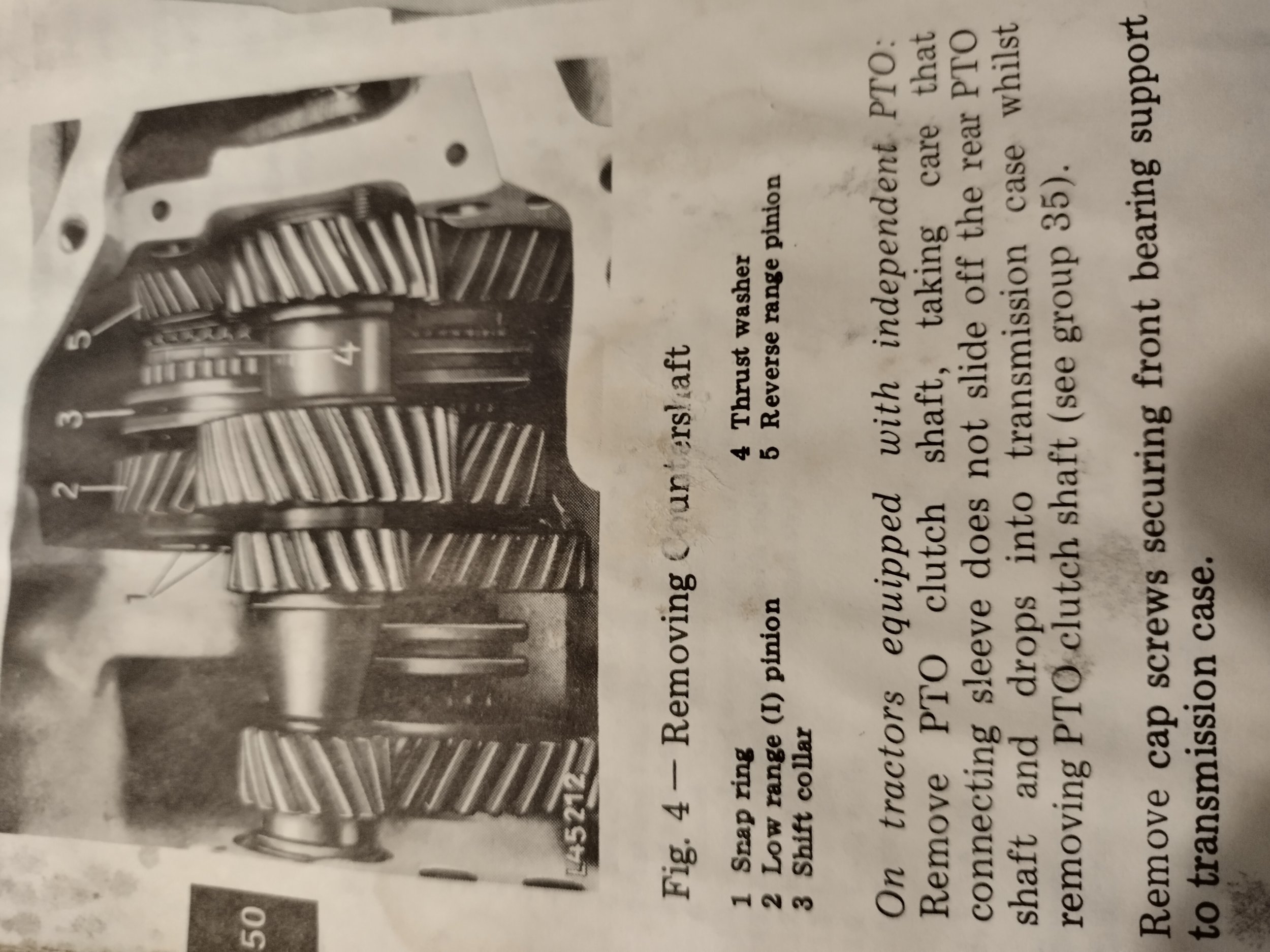

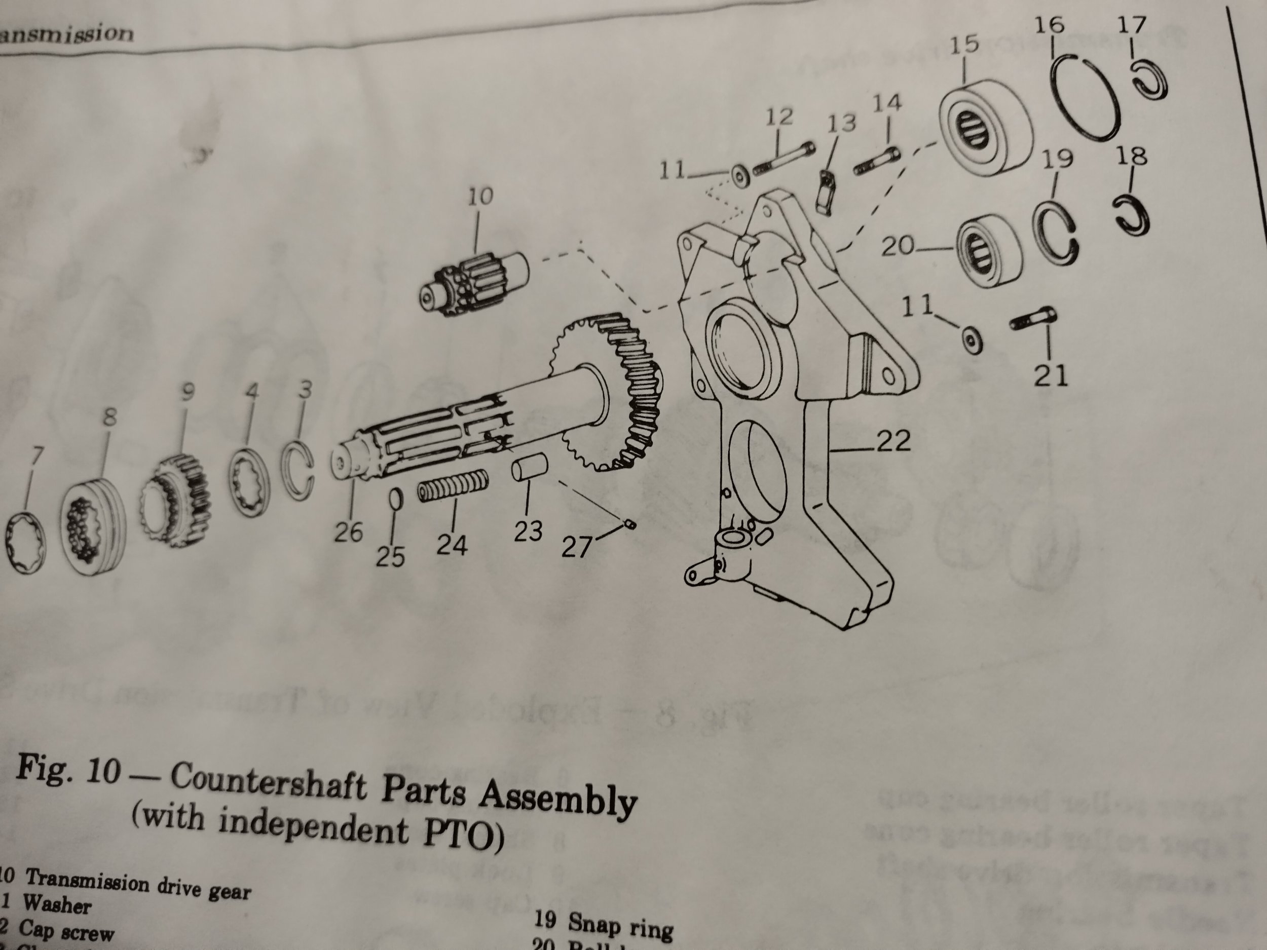

Also, I need to clean out the transmission case. Can I remove the front bearing support without taking off the rocker cover?

Front bearing support?

Part 22. I didn't want to have to take off top cover to remove 22 according to steps -- for cleaning metal out of case and getting to pto brake.
