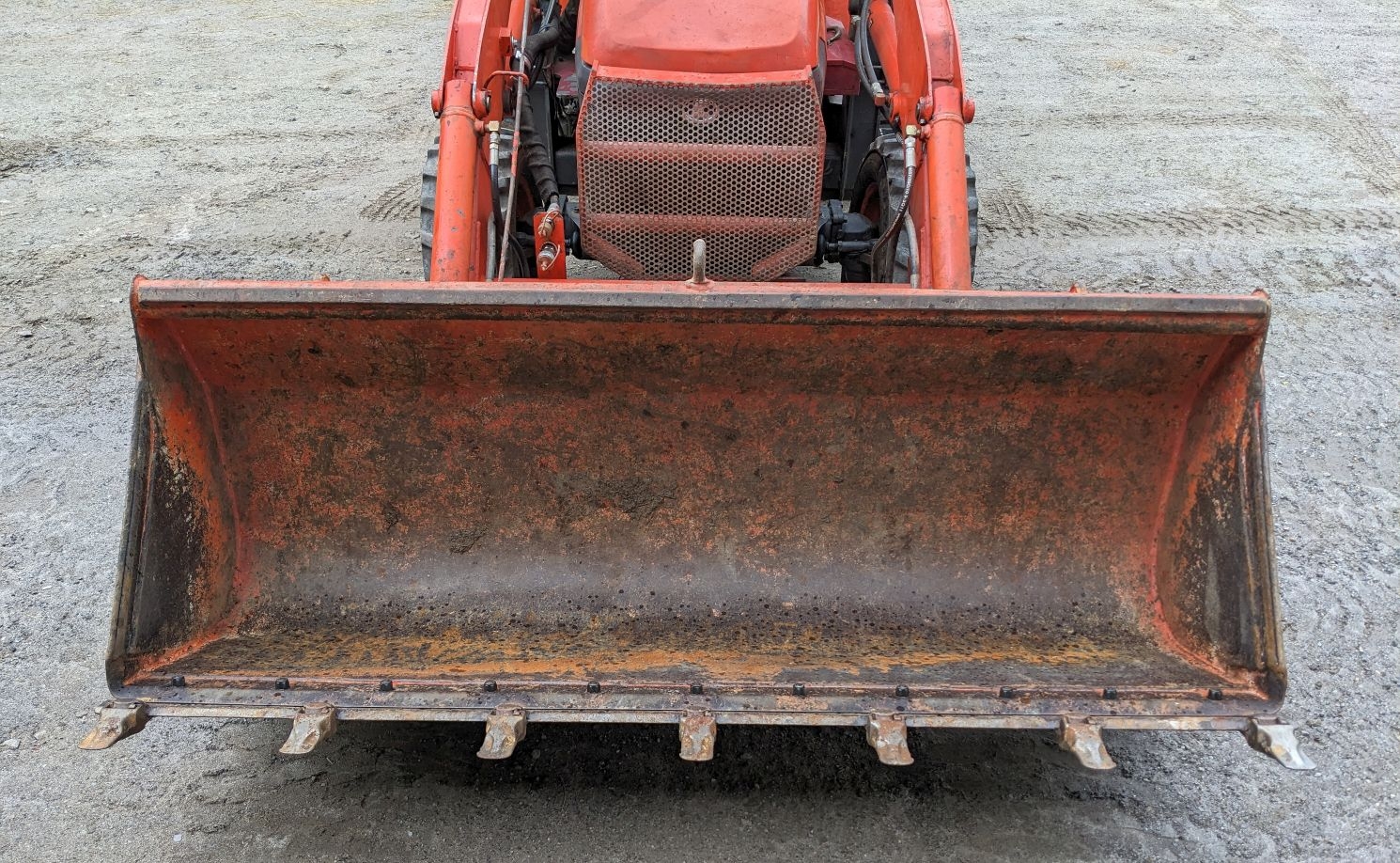

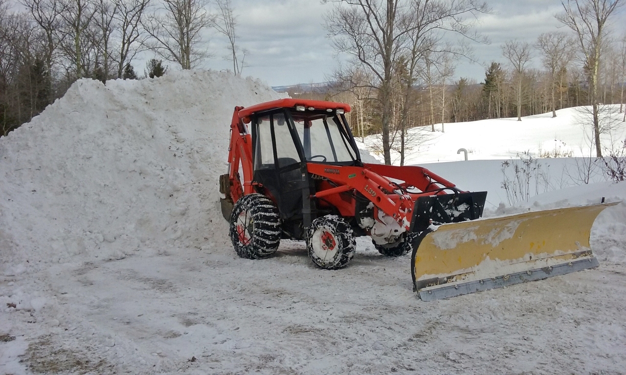

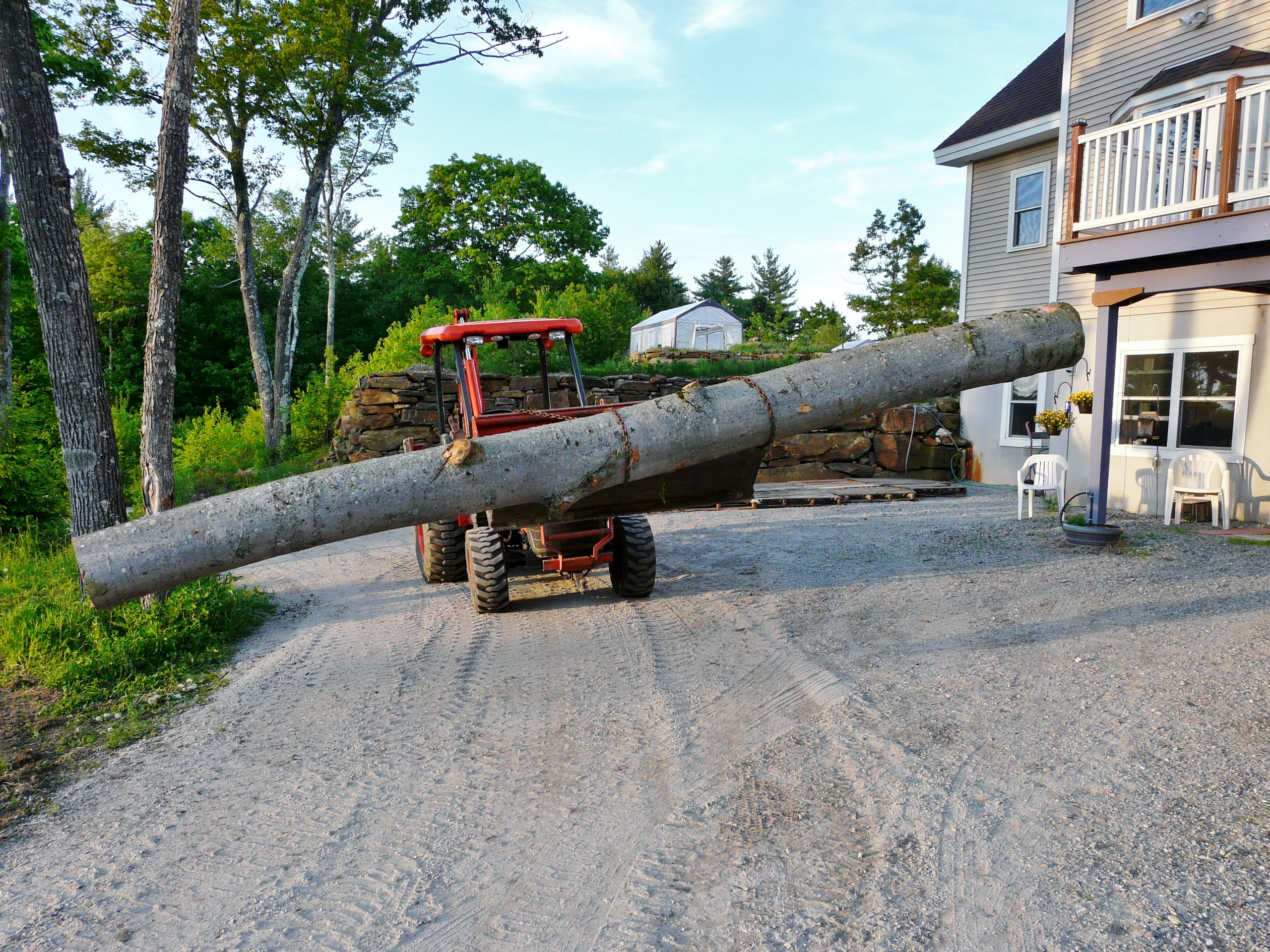

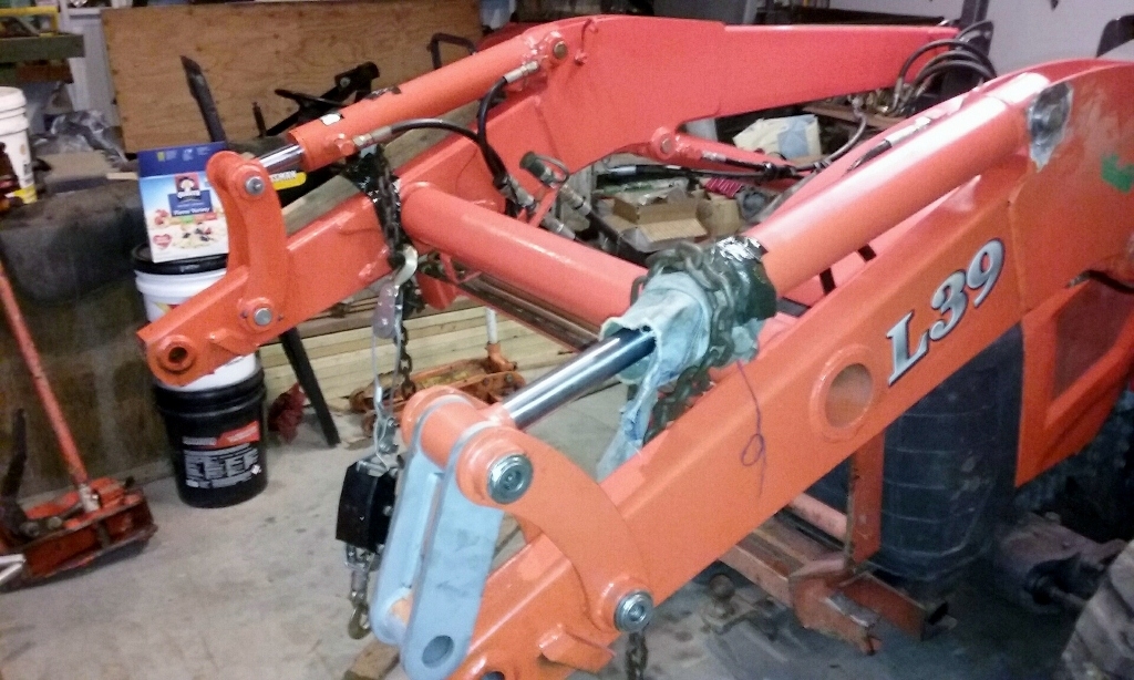

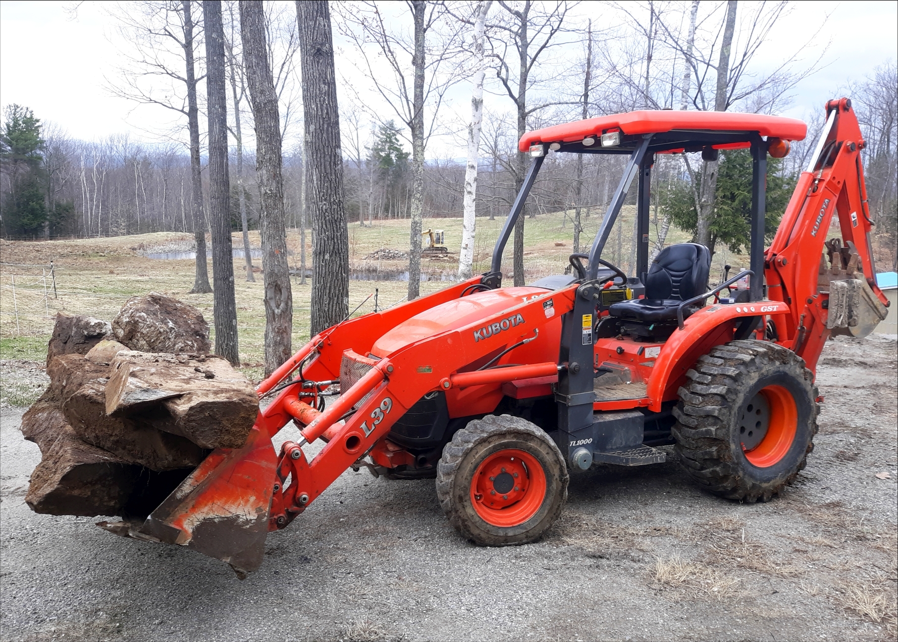

I have ballasted my tractor to over 8,000 lbs in order to lift about 2600-2700 Lbs at center bucket. I estimate that lift is over 3,000 lbs at pins, must be a world record for an L series tractor. That weight is hard on front axle, as I broke the casting once.

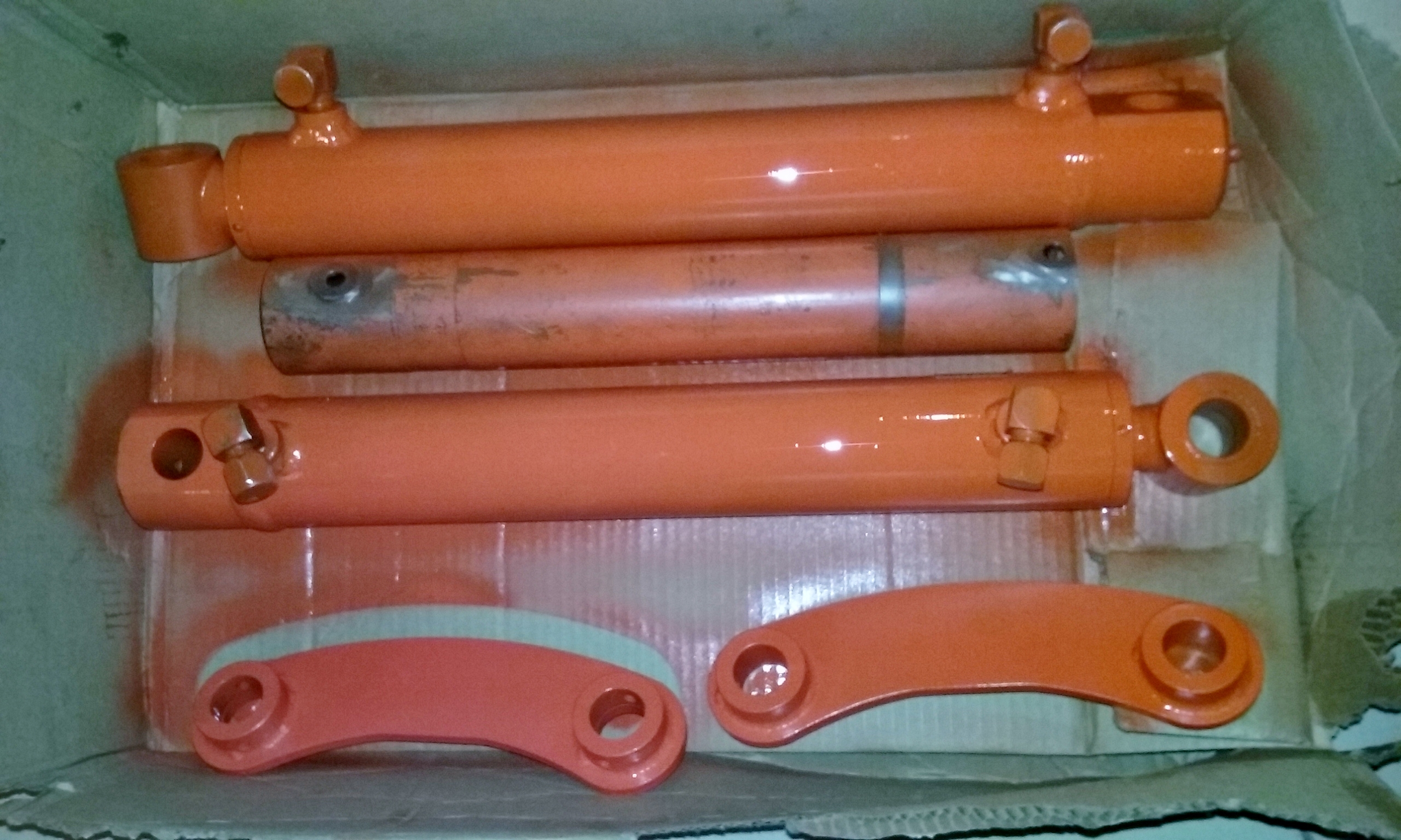

L39, L45, L47 lift cylinders are 55mm, bucket cylinders are 60mm. I upsized both 5mm.
Unknowingly I was running my pressures @ +3,300 psig before I got around to putting a gage on the system. I kept turning up the relief without checking! Shame on me.
So by upping the cylinders a bit, I am running 3,000 psig to be kind to hydraulic pump, valves an hoses. Also have a cushion accumulator.
With an additional 1,000 plus of ballast, the machine is over 8,000 lbs. Wheel spacers widen rear track 2" for winter chains and add a bit of stability.
Fuel is turned up to provide low 40's hp, to counter the extra weight.
As a old mechanical eng8neer and hot rudder. I think I have learned the hard way finding how enough is enough.
The L39 overall capability is very balanced and is at its practical limit.
It is very reliable, & amazing for it's size.
