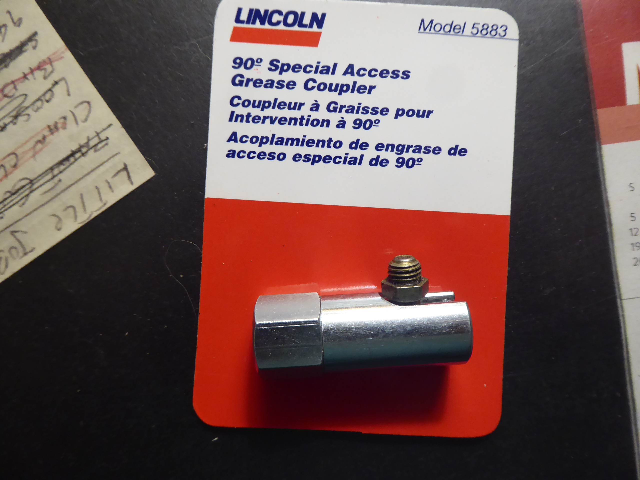

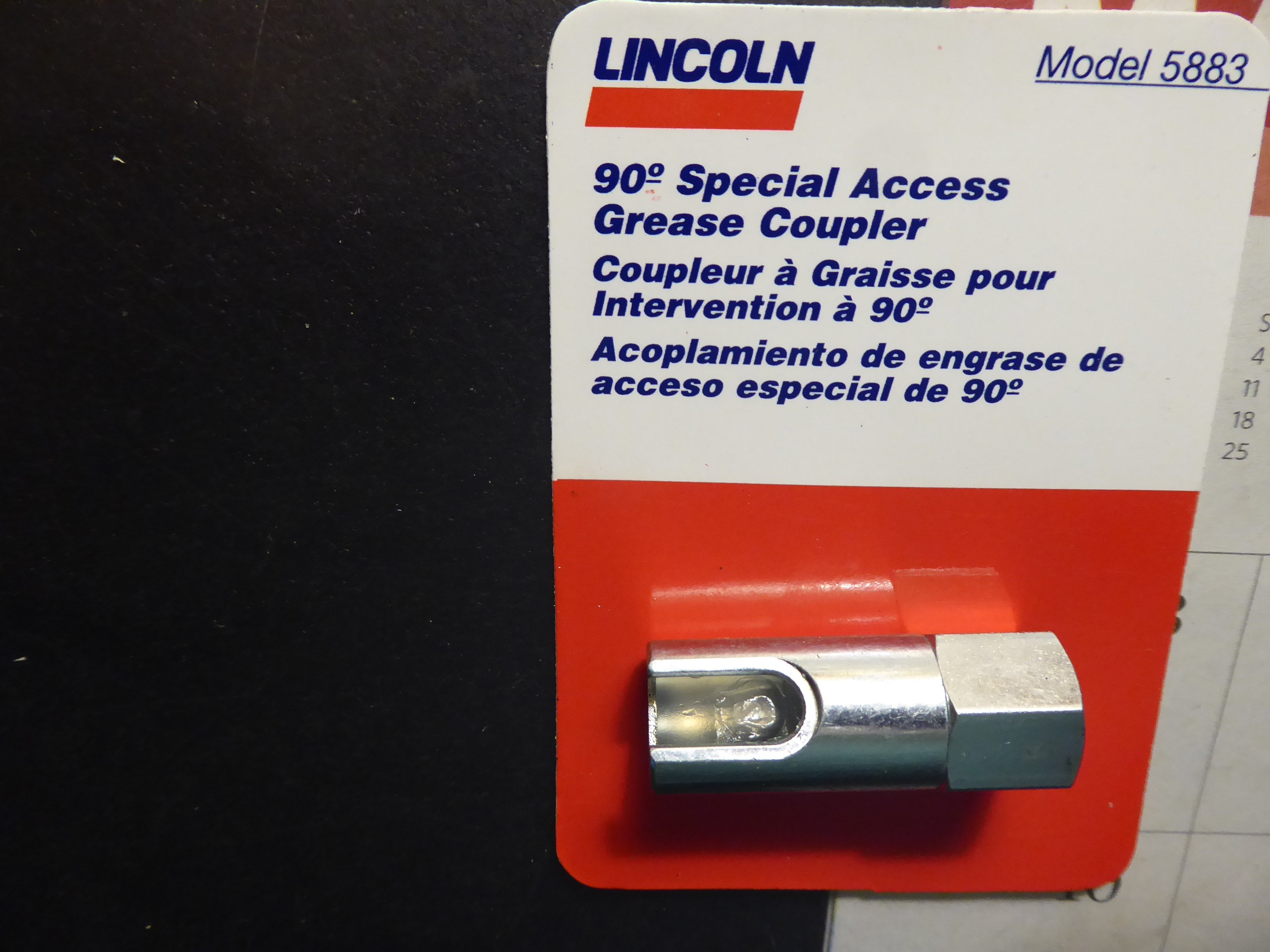

Nobody has suggested drilling an access hole through the window. Can't see why it wouldn't work.
Easiest solution is to add a short extension and a 90 degree zerk as previously mentioned.
Most elegant solution would be to drill and tap the pin for a zerk. Also previously mentioned.
/ inaccessible grease fitting #23
On my tractor the Zerk is a 90%
Mine too - and that is what I would do, change the zerk to a 90. That is if it is a threaded zerk and not a push-in type.
gg
/ inaccessible grease fitting #24
/ inaccessible grease fitting #25
Yes, go buy a factory made pin with a zerk on the end. Easier all around and makes for less mess.
Probably about ten bucks.
/ inaccessible grease fitting #26
There is an adapter that will fit that I have have one it cost like 10 or 12 bucks at family and farm it just takes some finagling to get it on
