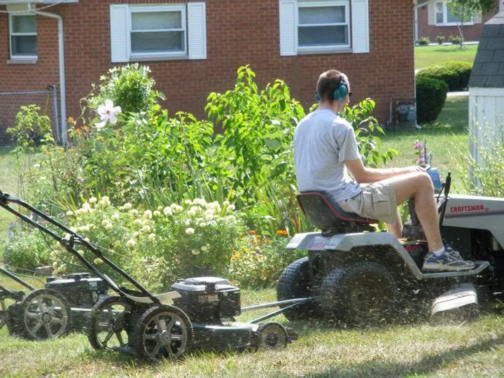

Hey all, I wanted to share my current improvised pull mower setup and see if anyone has any thoughts about modifying it.
This all started when I purchased a new home with 1.5 acres of lawn. My FIL had an old Craftsman 42" rider that had been sitting unused in a shed since 98. New battery, plug, air and fuel filter, and fuel and it was in wonderful condition. First time out it took me probably 3 hours to mow it all. Off to Craigslist and happen to find 2 almost identical mowers to pull behind the mower to increase the width. Both have the same 22" deck, one's a 5 and the other is a 6hp. Total cost for push mowers = $55.
Used some scrap iron laying around to build an A frame and now I have about 78" of mowing deck that cut my time down to about 1.5 hours give or take.
I'd really love to have them both swing off the left side to avoid the discharge chute and also so I can run my front right tire up along the already cut line and not have to keep looking back to adjust based on the back right mower. I found a video of a gentleman who looks like he's solved the problem and they look like they do really well trailing.
YouTube - mobmower2
He's got quite a few more mowers than I would have but the principle is the same.

The safety of the approach would be my only concern.
I shudder when I see anyone around a push mower other than the one doing the pushing. Too much debris that can be shot out at by-standers and the guy on the pulling tractor is a by-stander.
Tending the running mowers while getting on and off the pulling tractor is another concern.
I see it as a fun project but a temporary solution to mowing the lawn.

I like the setup myself. When I was a kid (MANY moons ago) we had a 2 acre front yard on our farm, and our beater riding mower's blade assembly took a major, unrepairable crap. He hooked up three (no idea where he got em) push mowers behind the rider, and pulled the blade setup off of the rider. Did this for a whole summer, till he bought a really nice rider to replace it all. People would actually stop on the road, just to watch me mow:thumbsup:.
Sure cut my mowing time WAY down. I actually got to do some fun stuff on Saturdays, beside mow and clean the barn stalls.
As for the "all on one side" idea, Consider making a multi point mount. I would connect the main pull bar with at least two holes in the rear bracket, and a third coming from somewhere up towards the front of the tractor. These two mounting points would anchor the tow bar solidly to the tractor.
I would then hook the two push mowers to the pull bar, with a single pivot point, kinda like the gut in the vider. This would allow them to swivel when you turned, making turning easier. Just a thought. not sure how well the rear bracket will handle the torque of the pull bar.

Thanks all for the comments. I will note that in the pictures I had something that held open the bagger 'flap' on the rear so the clippings would discharge out the back instead of mulching. That is likely the most dangerous thing I did with them and have since stopped after the initial trial mow. They now mulch and I haven't noticed any significant impact on performance.

Rider has 6 speeds and I'm typically in 4th or 5th. The back lawn is about an acre total, rectangular with no trees or other obsacles so that's helpful with this setup. For the front I may make a few passes with this but then just go with the rider as there is a lot of trees to navigate around.
If my deck is conservatively 80" and I travel at walking speed (3.1mph, might be conservative) in a straight line, I'll cut 2.5 acres per hour. Now factor in turning around, not mowing perfectly etc and I'd probably guess I'm cutting 1.5 acres in 1 to 1.5 hours.

I've seen some very large deck offsets. I'd love to go that route but I'm hoping most of my lawn will be converted to garden and orchard so I won't be going any bigger than I currently use. I tried to go as inexpensive as possible. Look forward to seeing pictures.
I don't have a lot of confidence in the rear braket and it's torque capabilities. Pulling a couple mowers balanced out isn't a problem.

I never said it was a problem, but it WAS your idea to put them off to one side. It was just a suggestion to help you do what you wanted. In fact pulling them balanced is the BEST way to do it.
/ Improvised pull mowers
#14
Think there's some confusion. I was just saying that pulling 2 balanced is no problem for the rear bracket. Even though I want to put them off to one side, I do question if the rear bracket has the torque capacity.
