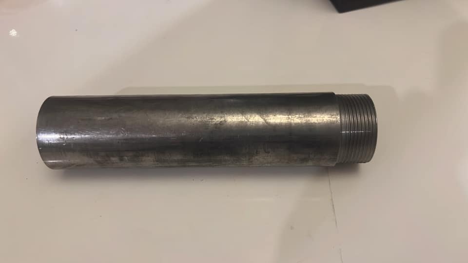

If you haven't installed the extension for hydro tank, could you possibly get the dimensions for me? I bought an AGT L12 last week delivered in Ohio. A few days later I lost all hydraulic pressure when going down the ramp on my trailer. Hyd fluid was full, so I looked at the suction line on the tank. It is on the end at the lowest point possible. looks like a design flaw, and your post confirmed it. Thanks.
I had the exact same issue! Driving it off the pallate and down the ramp caused it to stall out. I had to rock it back and forth to get hydraulic pressure again and then got the bucket down to keep it level as I drove it off. Left some marks on the driveway but got it off.
The extender is 19cm long and 4cm wide. It is threaded M on one end and F on the other so it can sit in-between the inlet and the filter.
EDIT: it is 19 CM long and 4 CM wide. Not mm!
The extender is 19mm long and 4mm wide. It is threaded M on one end and F on the other so it can sit in-between the inlet and the filter.
Thanks! I don't know if they would send me one or not, I bought my L12 from a private seller w .2 hrs on it. I read somewhere about someone asking the manufacturer about parts or something and they claimed they never made it.
I will try an email to them but I am not optimistic. thanks for your help!!
Are you aware of 'chinese mini excavators' FB group(s)?
There is alot of info on there about the L12 issue and fix.
There are some US posters that may have or can get the part also. Danni Zou or George Zou I think, check it out.
The adapter thingy below
