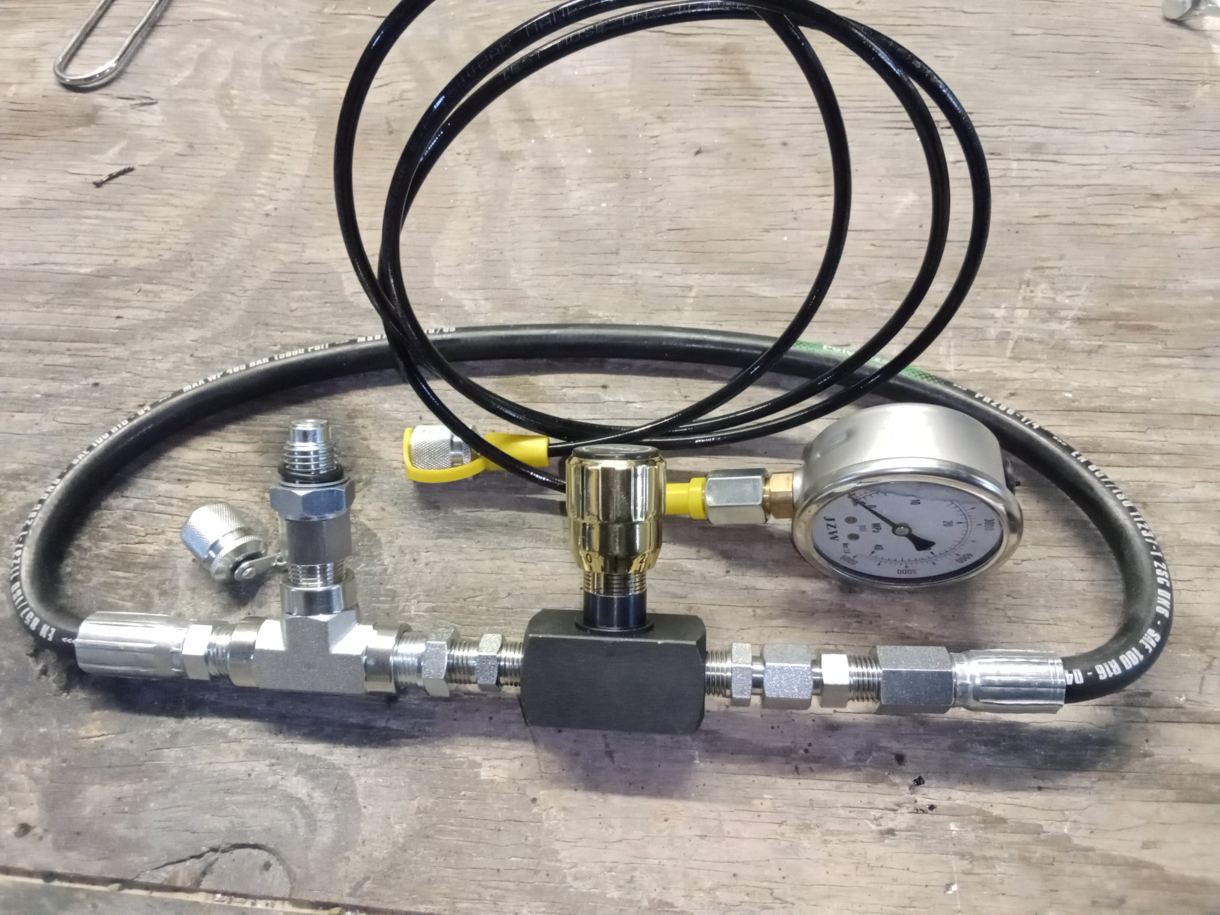

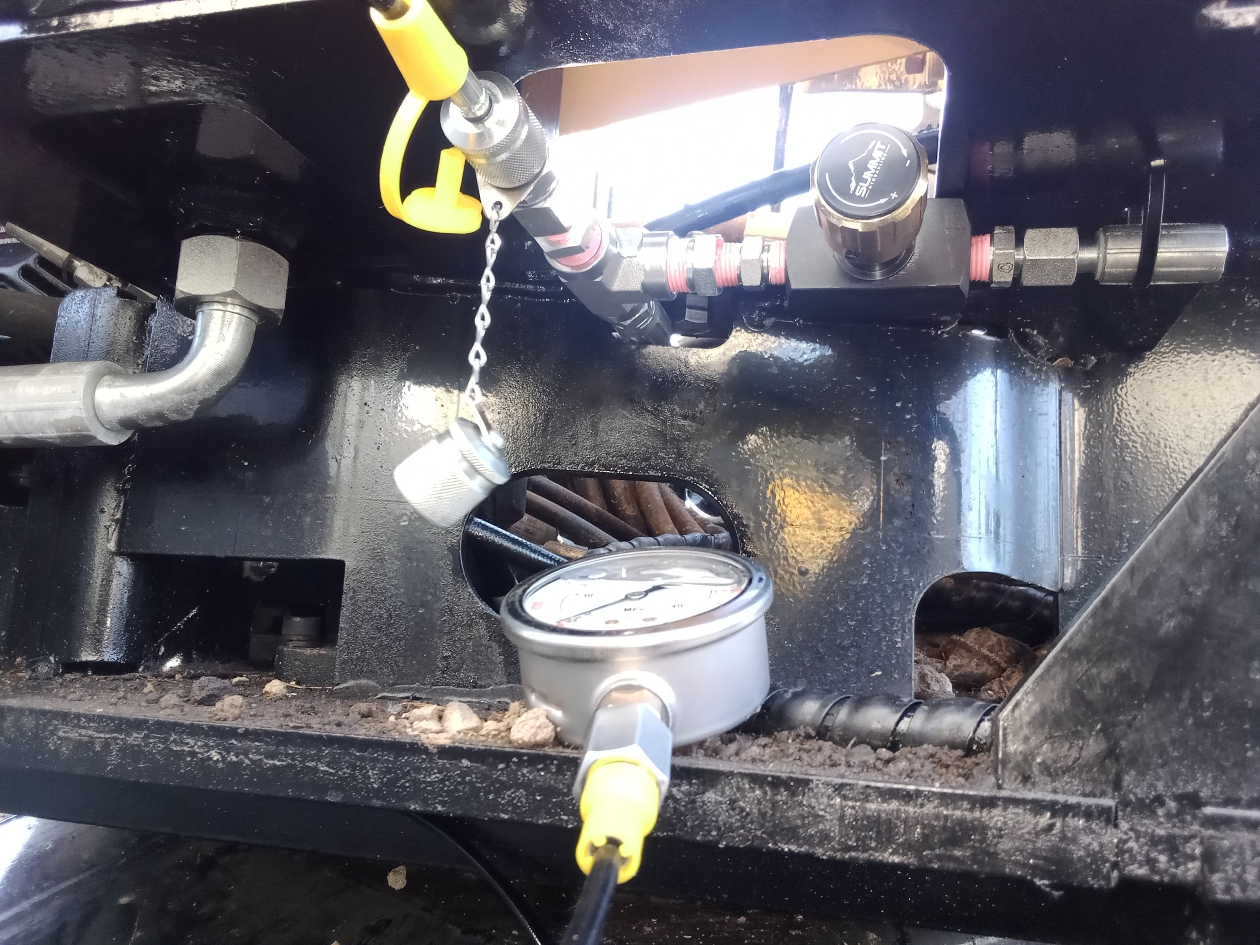

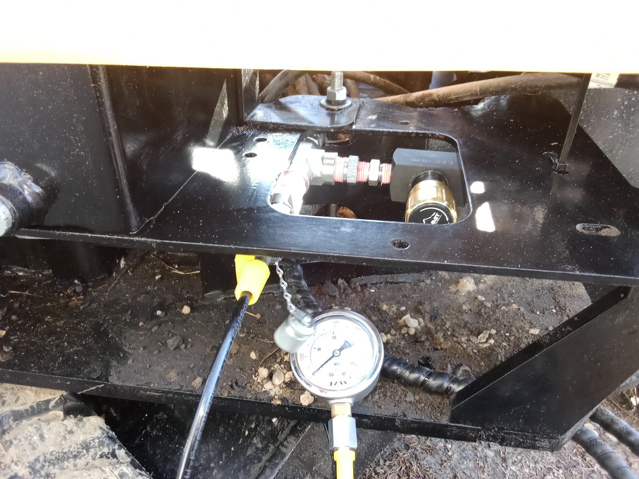

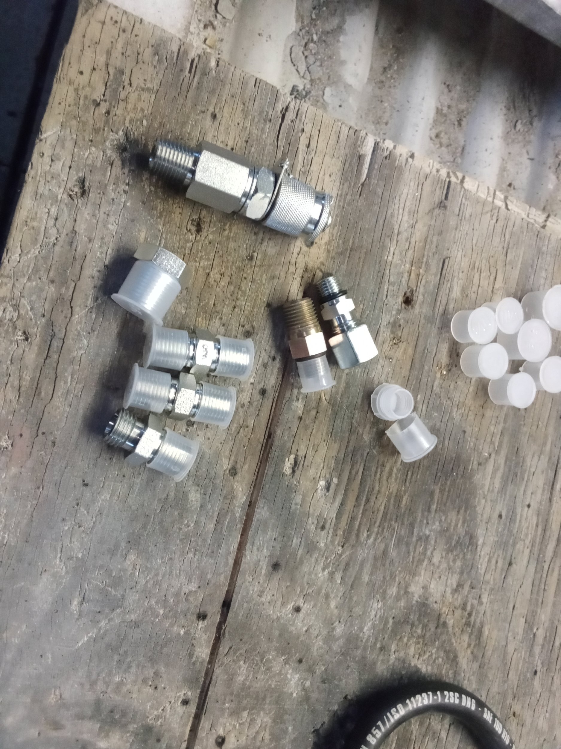

Anway, thanks for all the input from this thread so far- all the fittings arrived and I was able to add a tee for gauge and flow control. About $220 total for all, incl 3gauge kit, flow control, and a few extra fittings. Discount hydro had most everything and great price on custom hose.

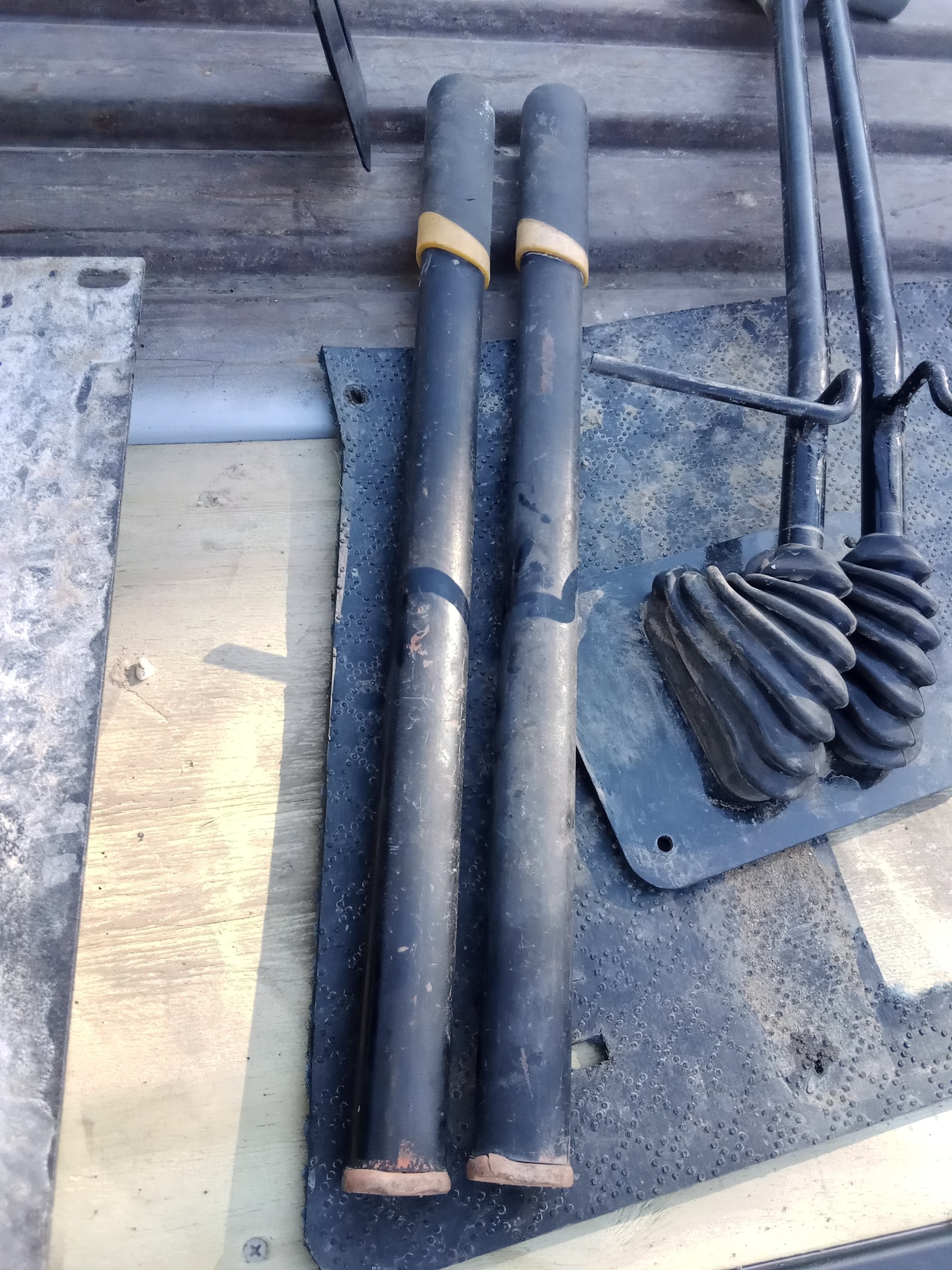

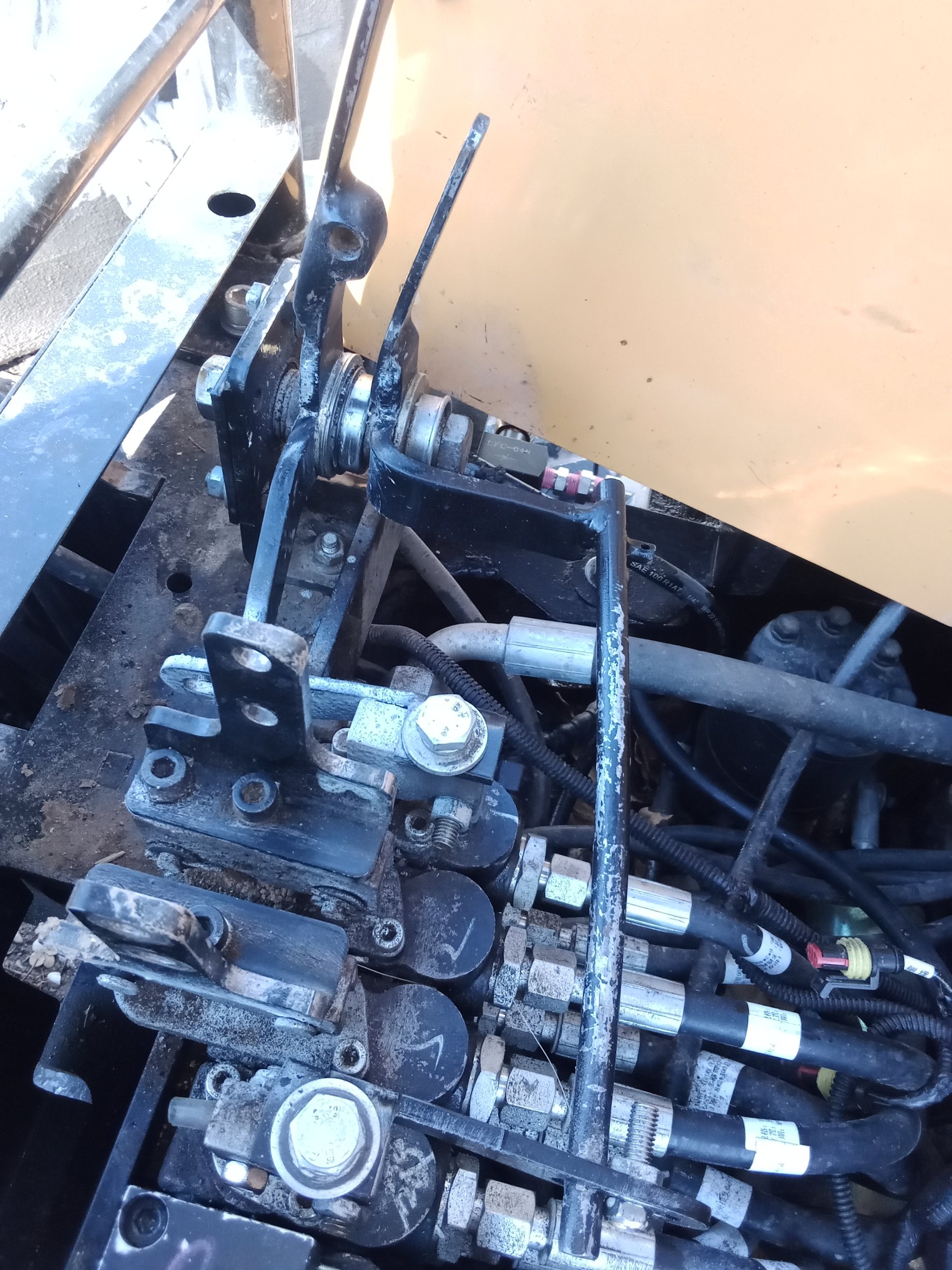

Mechanical linkage mods for levers
Parts and pieces mocked up

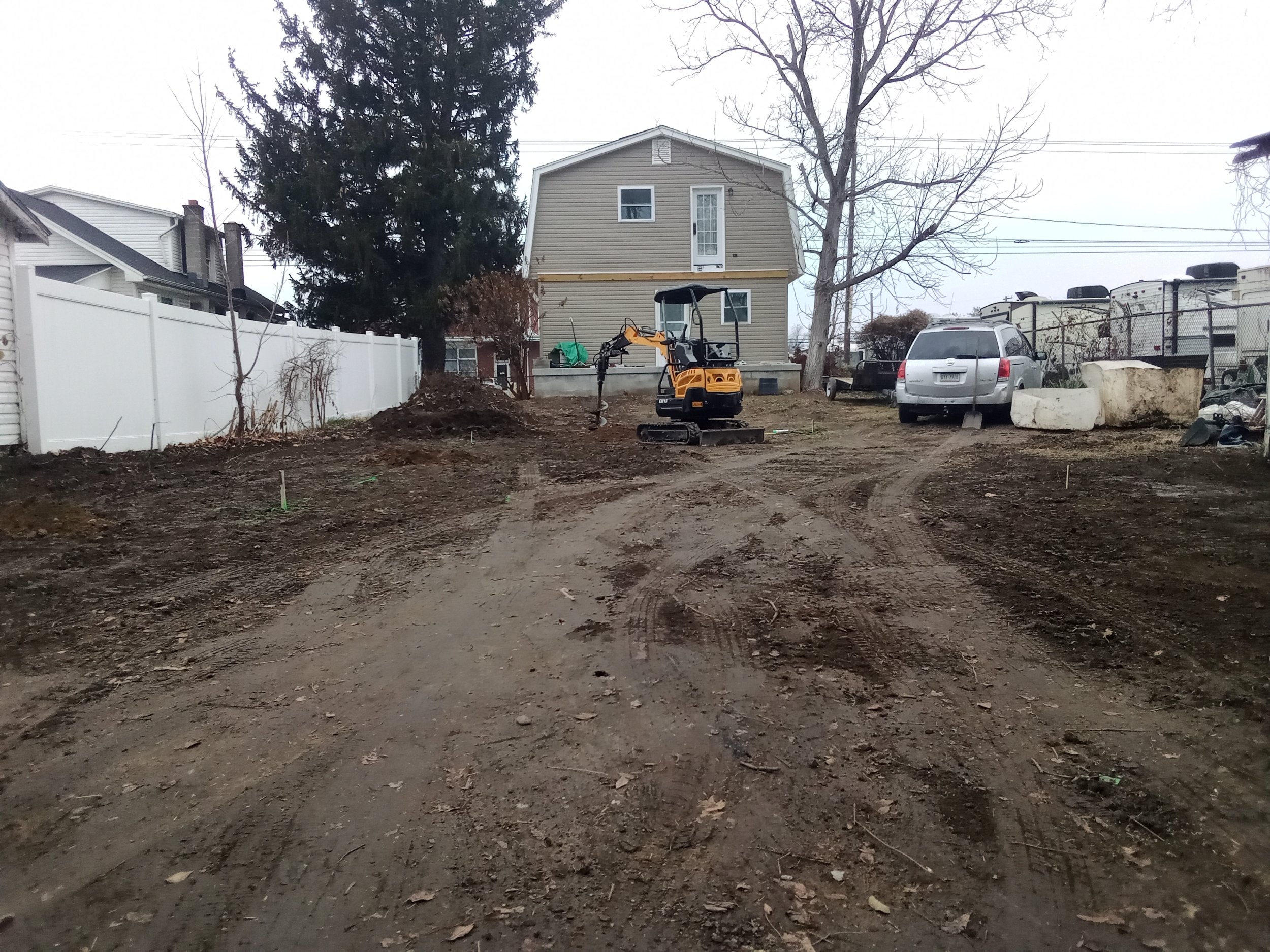

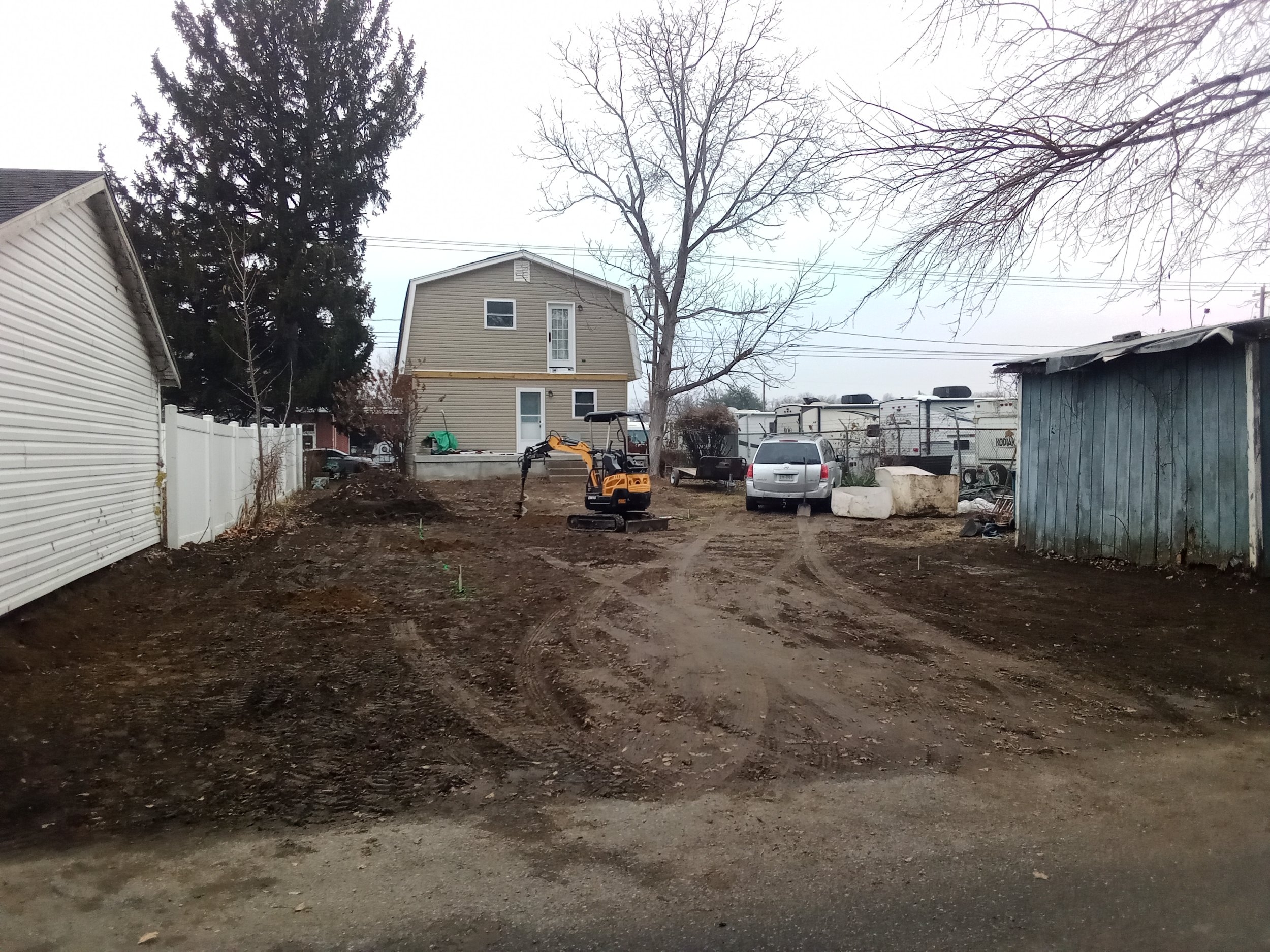

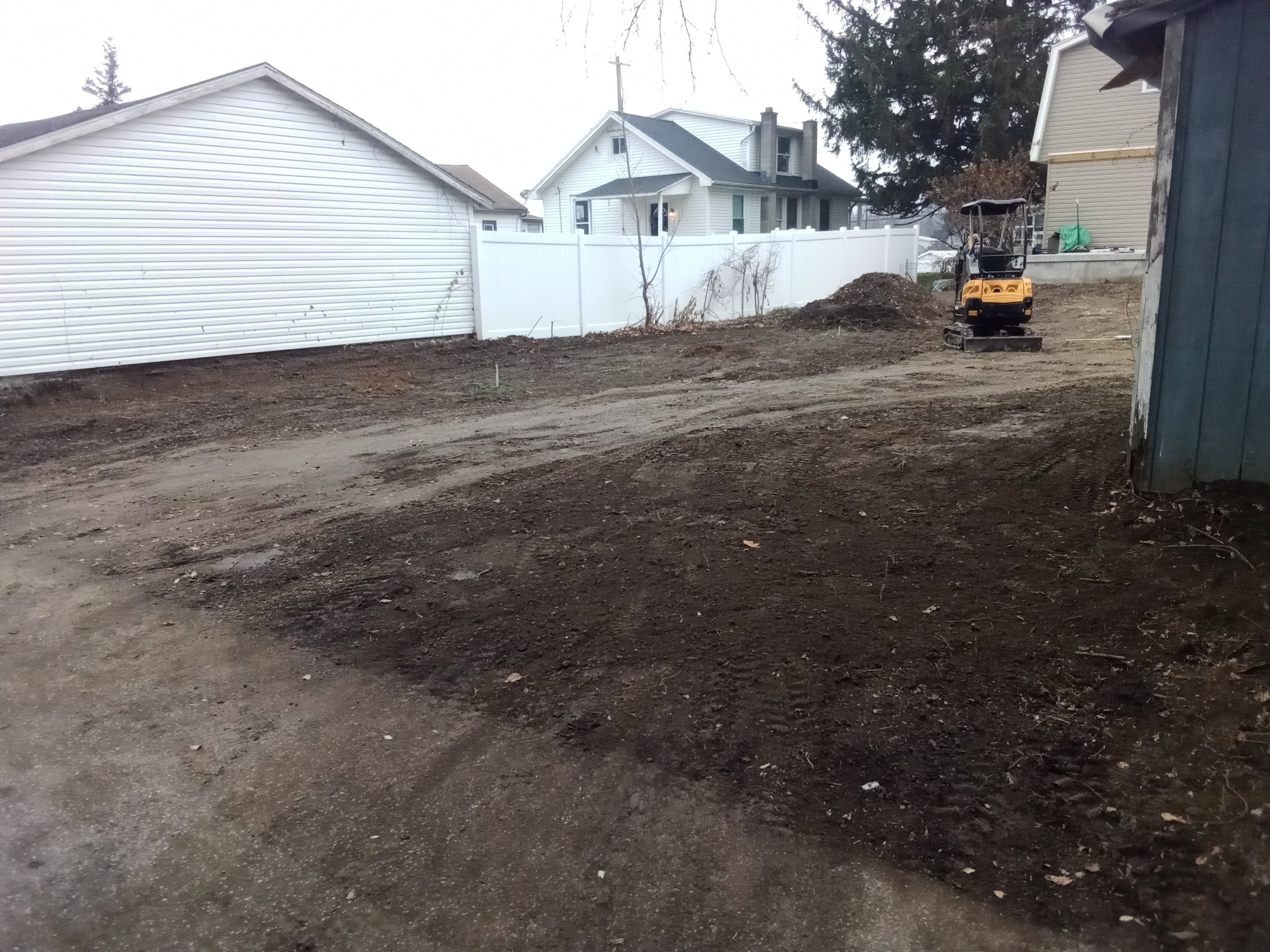

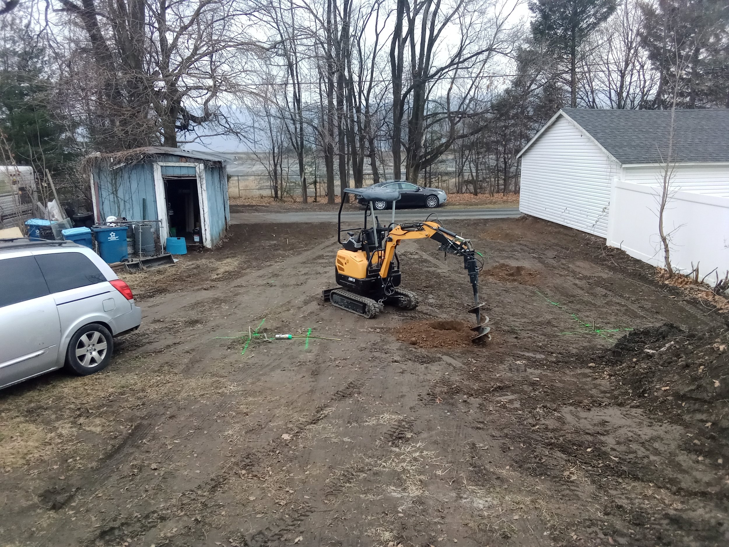

Leveled lot out (dirt at back used to swale up to alley and to the siding on neighbors garage
Start drilling 12" holes for post/beam building posts. Bit is 36" but can do 48" deep no problem since pump is only 8 or 10" diameter x >12" high.

Really excited with pressure up 10% from 2250 to 2500psi, and 2stage set 40% up from 1000 to 1400psi cutoff.
With boom flow adjusted down, counterweight, and engine rpm at ~ 60% it's running awesome.
Higher wear on everything obviously but if briggs can handle the torque demand, I wonder how high I can set pressure while still pumping full flow . . . . At full flow AND full pressure it would really shred the work. Just hopefully not itself haha.
Also wonder if 3000psi would be reasonably safe for the system. 10% increase is already noticeable. . . . I think the lowest rated pressure of any one component is at least 3300psi.

2250psi was as-delivered RV setting? Good you bumped it up.
2400-2500psi is the target RV setting, and going higher is a function of net forces and strength of design, not the component ratings on these machines. By that, I mean, what are the pin diameters and the cylinder IDs? The moment arm lengths on the dipper and bucket, as well as the thickness of the bucket carcass are all criteria that limits pressure setting.
I run a thicker bucket on my backhoe, attached to a 2500psi tractor, and have bent or cracked it in unexpected places.
If you decide to crank RV pressure up to 3000, I would not be concerned about damage to hoses, fittings, or cylinders. I would first expect damage to the buckets.

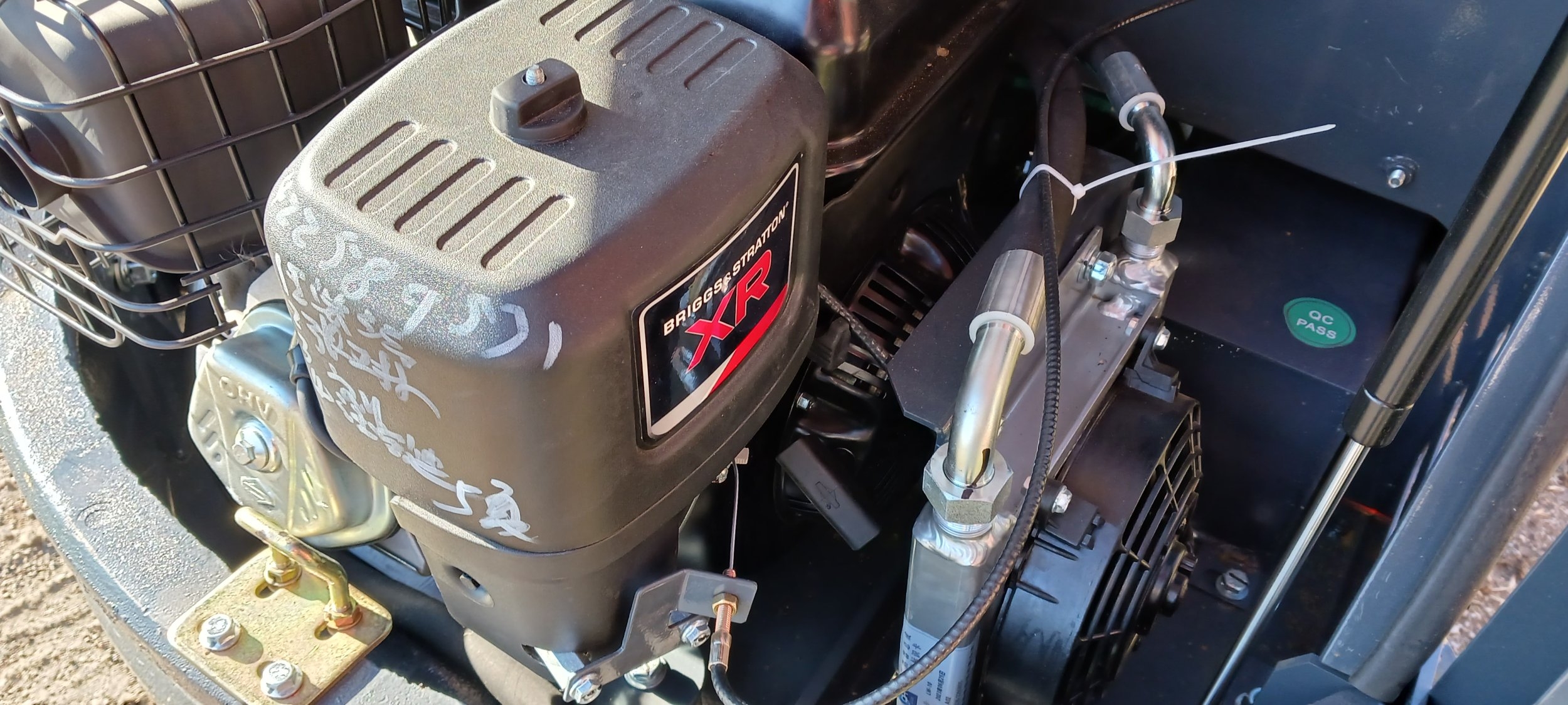

I have a quick question for the experts on the forum. As you can see in the pic, my AGT L12 has a hydraulic cooler and fan in front of the Briggs. The recoil starter is still on the engine and I am considering removing it. Would removing it help to increase the airflow? I think the Briggs is going to need all the airflow I can get when summer gets here. I would like to keep the cooler and fan where they are so I can use dfkrug suggestion to install duct work between the fan and outside air. thanks.20231207_104227.jpg
