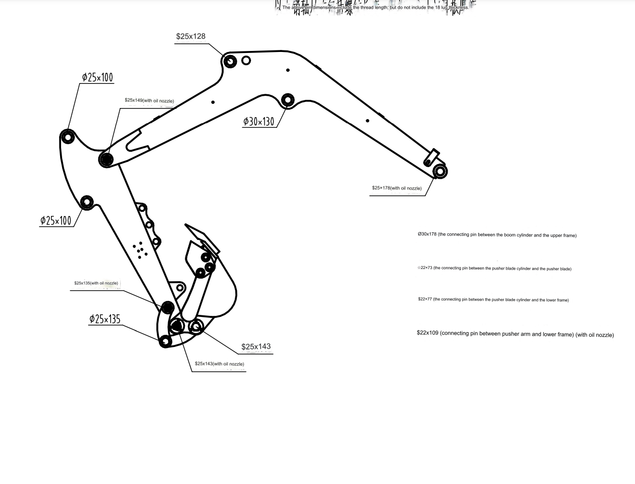

I FINALLY (after days taking pictures and measuring multiple times) received this pic for my machine. Shows precise measurements and which have zerks.
They DO have proper drawings for probably all of machine. . . . they just don't like to share!
Sorry for different sizes/fonts, I used translate
