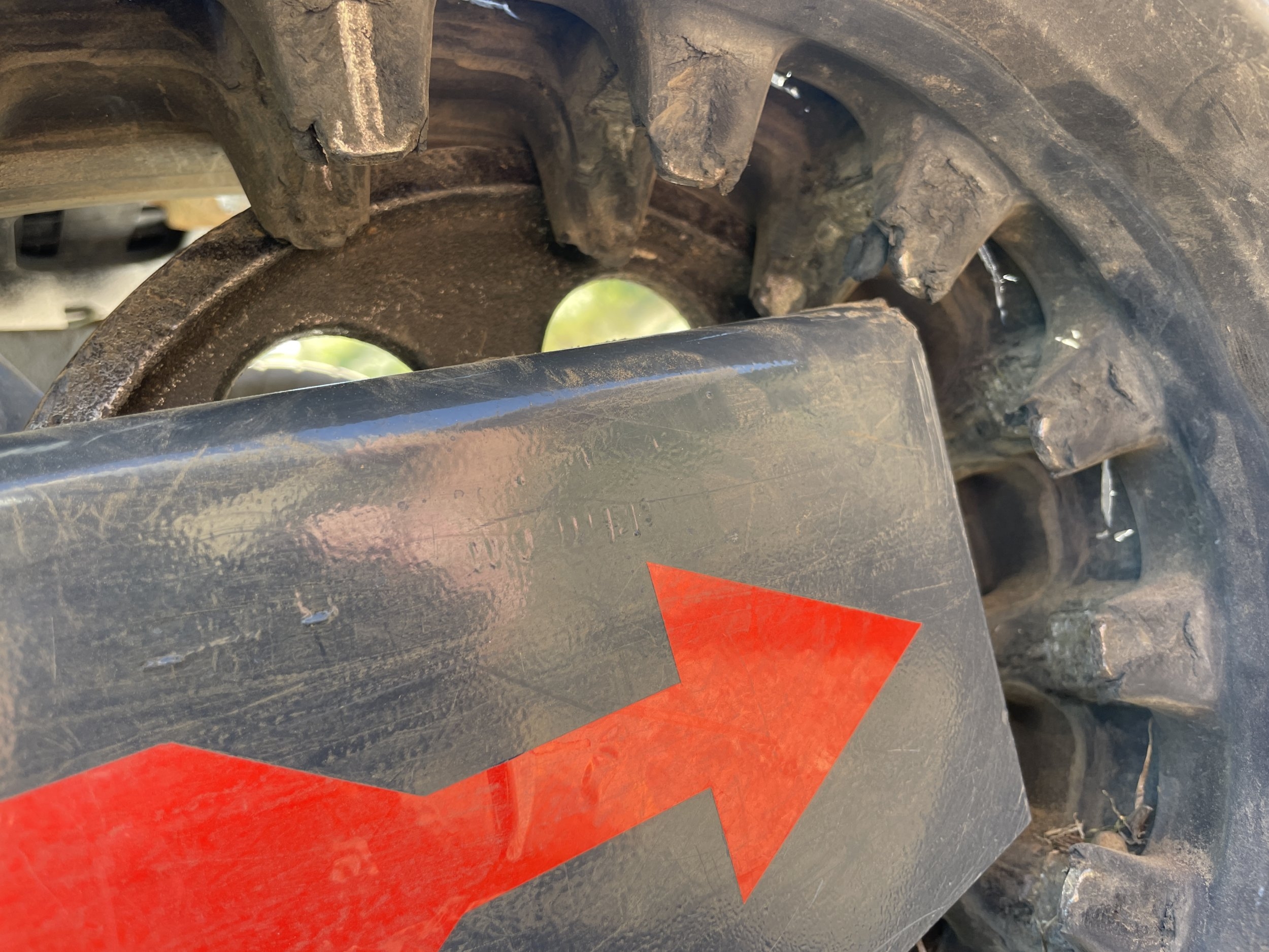

Well had my first track thrown off today.
To fix this I just release the tension by letting some of the oil out?
I am not sure how to get this track back on but I assume I need to release the tension by letting some oil out and then get it back on and then pump some oil or grease into it to increase the tension.

None of the units I have had here had the hydraulic tensioner, if that is what you have. Just spring tensioner, even if the label refers to oil.
I can't really see what you have. Maybe you can clean it really well inside the hole and see what is in there. Also, do the AgroTk folks have anything to say about the tensioner?
The normal way hyd tensioners work is you have to unscrew the fitting to let grease out, then they have a zerk for re-greasing.
