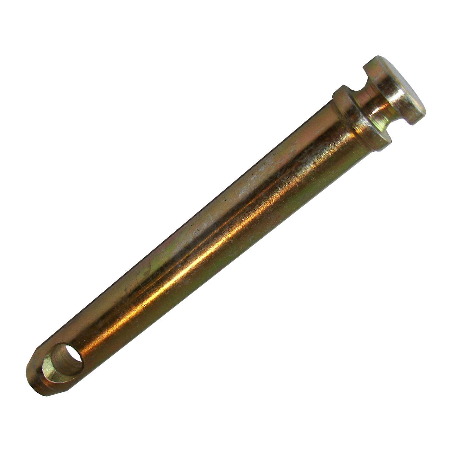

Sorry for any misunderstanding, My Pins aren't worn out, they don't have the correct Heads for my New Bucket.
My Pins have an Oval Head, the Skeleton Bucket has Hex Head Bosses molded into it.
Maybe a Cat 2 Pin would work Temporary,(not greasable but 25mm) wondering if anyone has tried one?

OK, I see.
The main bucket pivot pins on all the 1-ton-ish machines I have seen are greased thru the tubing, not the pins. So a plain pin is fine, but you will still need to weld something on one end to keep it from spinning, and on the other end to keep it from falling out. Or an oval plate on one end with a retainer bolt.

All pins on my machine have the same hex head pin with zirc and threads/nut on other side. Buy one or a couple from alibaba? Airmail shouldnt take long.
Otherwise a cheap die grinder with decent rotary burr could hog out enough - would be a pain though.
