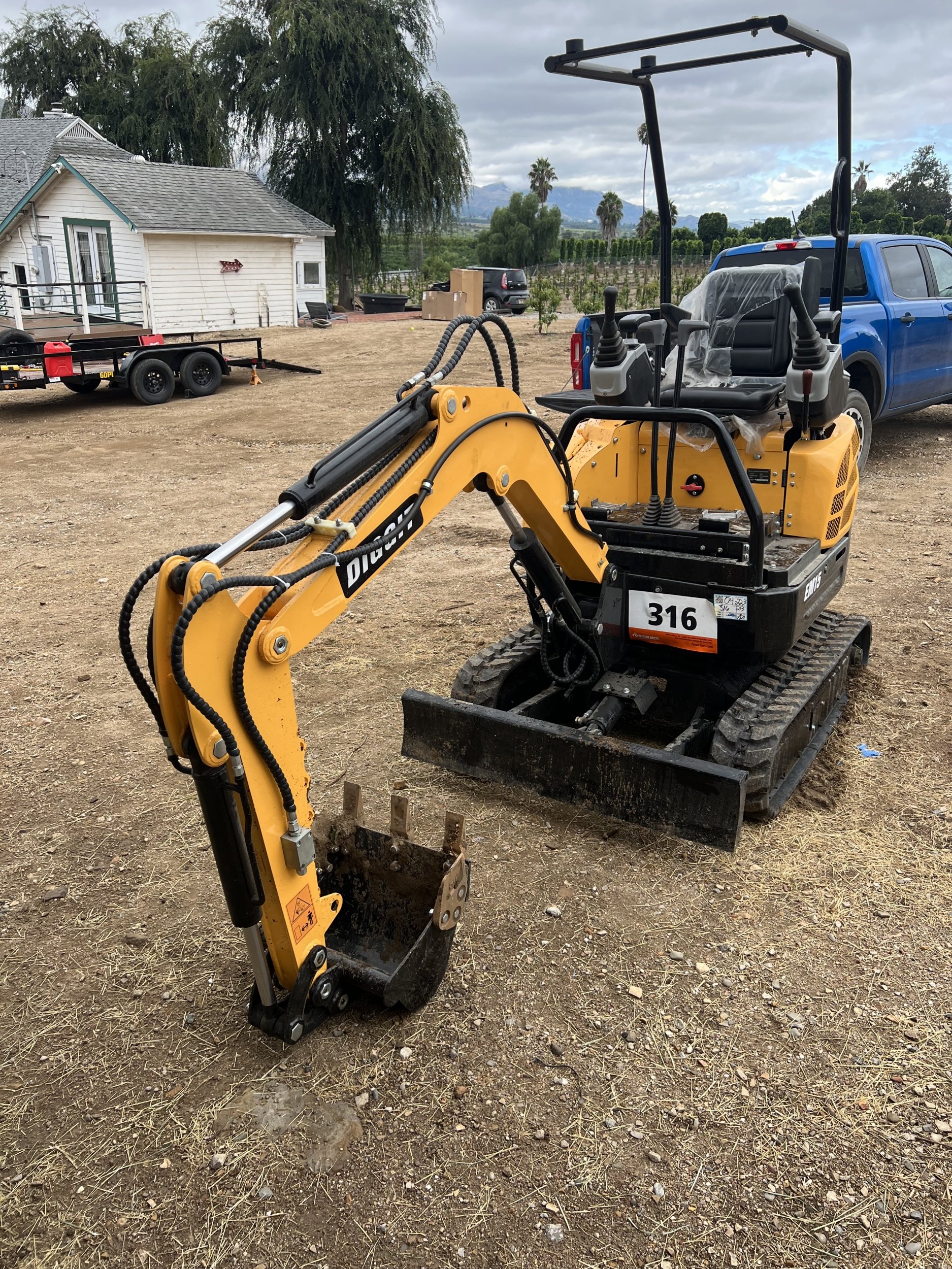

New to the group. Just bought a Diggit em15 mini ex from Richie Bros. Sacramento Auction. $4,750. ($5,600) out the door. there were 4 or 5 of them and they all went for the same price.
Lost the roof on the way home. I'm planning on adding cooling fans and exhaust extension. Any other must do mods?
The hydros are very abrupt. Does anyone know if that is adjustable.
I'm going thru thread and learning alot.
