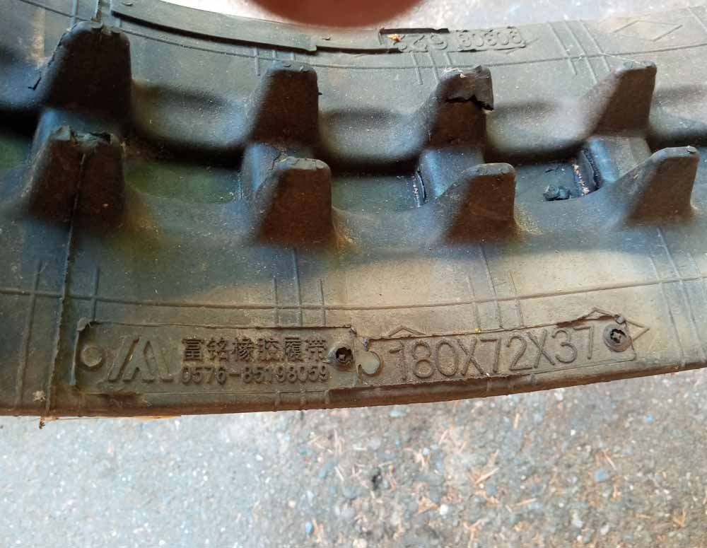

For you new owners, check the track size to see if you are getting the most common chassis found on these 1-ton-ish minis. 180x72x37
That is not the smallest track size out there, but nearly so. Used on a lot of minis made by Yanmar, Kobelco, IHI, etc.
I suspect the Diggit EM15 is slightly bigger, but I did not see the stamp on the tracks when I was last looking at my friend's machine.

Yes, the JF/FF-12 Industrials run 180x72x37.

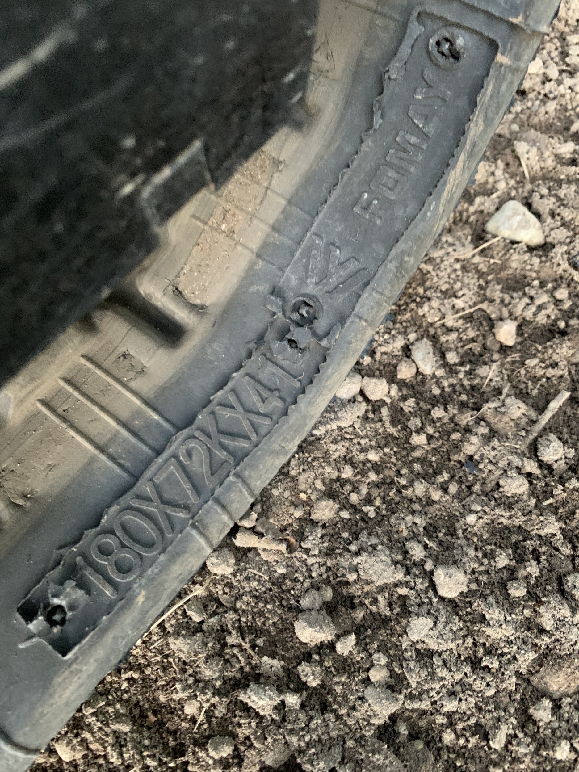

The Diggit EM15 has 180x72x41 tracks.

I thought the EM15 was a bit longer than mine. 4 more links, so the OAL
track length is just an inch or so longer than my XN08.
BTW, the sizes are
180MM (width) X 72MM (pitch) X 37 (links)
