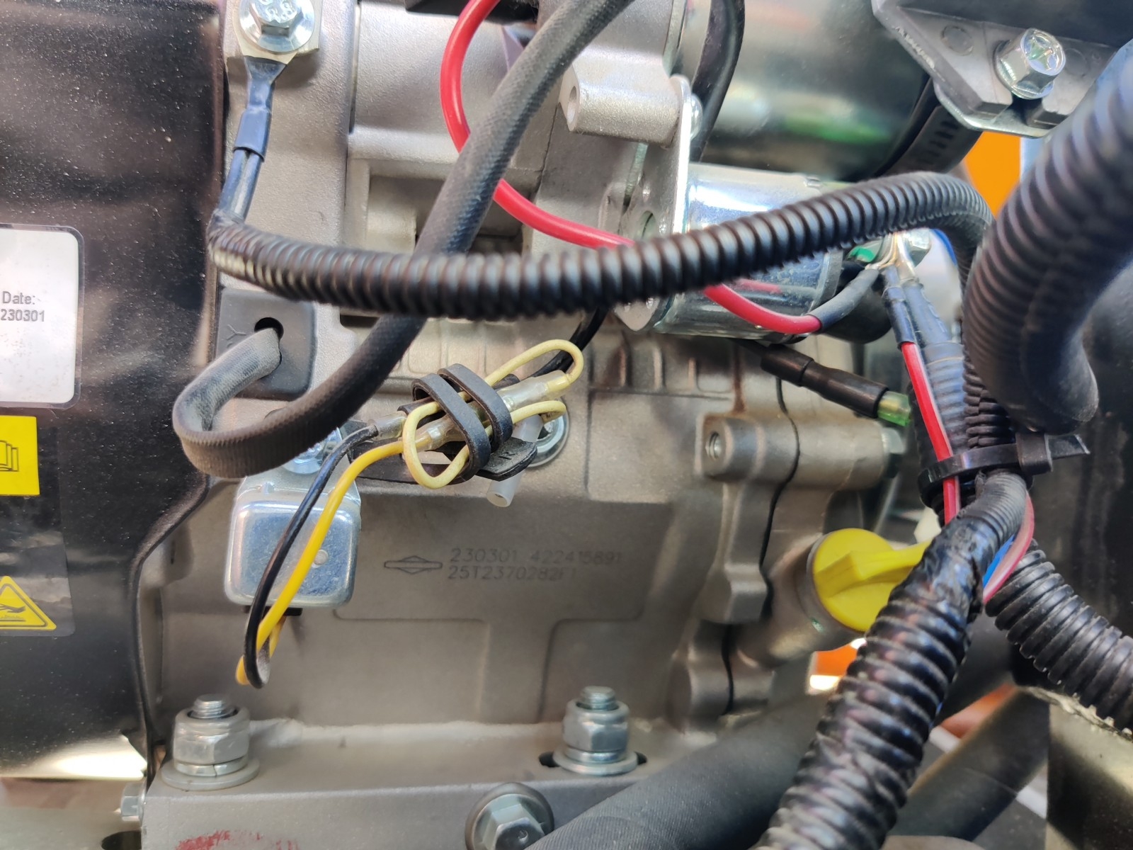

Lights work, starter cranks, but no spark. It's the Briggs XR 13.5, I've tried disconnecting the oil level sensor. I noticed there are two wires going into the engine case, I believe one is for the ignition coil (ground to kill?) there's another wire along with it that was never connected, not sure what that is. That's one's in the bundle of my other image attached.

Not sure if I can help but B&S engines kill by grounding out the spark. You having no spark would indicate that the contact from the ignition switch in On that opens the grounding wire is not happening.

If you go back to page 160 of this long thread, I have posted my replacement wiring diagram.
I don't know what they are using for an ignition switch in your unit, but the replacements I have used in the 3 units I have rewired has the logic of a riding mower switch. You will need to figure out the logic of your switch and trace the wiring to see why the ignition seems to be grounded when you are trying to run the starter motor.

Looks like I've got a bad ignition coil. According to my research, although not directly from B&S, the coil resistance should be 2K-5K, mine was 11.6K. I ordered a new coil and the Sterns switch from Amazon. I hope my coil diagnosis is correct.
