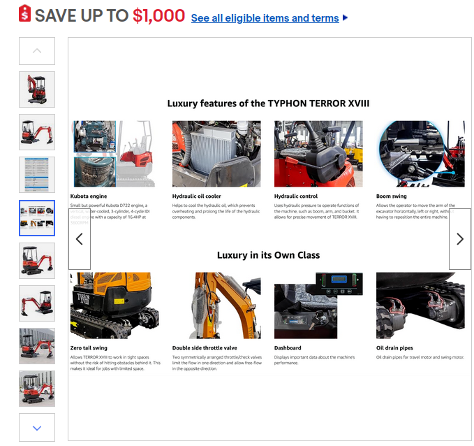

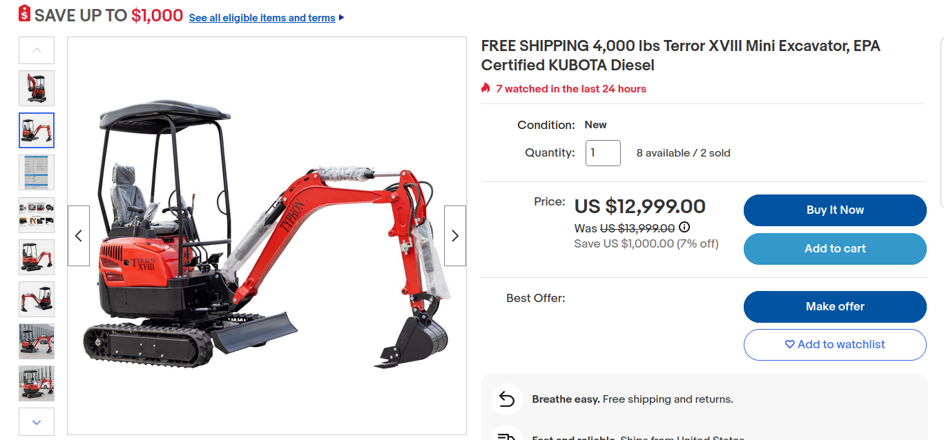

I am noticing quite a large price drops on the 2 ton Chinese minis recently. They do have a lot more features to them as well as a Kubota diesel engine. I see a model selling for ~$13,000 with free shipping in US. Would love to try one.

You guys get some crazy prices on those. Same machine with another name (Devil) as the post above, over here it's like $19,500.
Your photo shows the crappy 1/8" shallow bucket. If you can get the better buckets you see on 2.5T-3T units, that would be a huge plus. The more powerful minis will rip that bucket to shreds.
At 2T and up, you also may have planetary final drives, which I have seen in some of the Typhon pix.
   / Importing and modifying a new mini excavator from China #658
I agree that the buckets on these Baby Ex's leaves much to be desired. Those bolts for the cutting edges and teeth reduce digging ability. Part of why they can be sold cheaply I imagine. I intend to weld on the side cutters (once the blasted heat abates outside) and I have on order 3 pin on-weld on teeth that will replace the present ones. One thing I noticed when making prep for welding is the buckets have a rather thick paint on them. Pretty resistant to removal.
I have done some looking about for options for my new Typhon but have not found much available. I would like a larger ditch cleaning/light grading bucket than the 500mm (20 inch) that is imported. 36 inch would likely max out the capacity.
