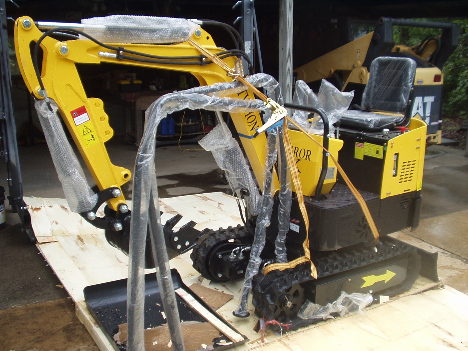

The shipper said the damage happened when he was transporting it. As you note dfkrug it is all wood crating and no steel. So far from cursory inspection the Baby Ex looks unharmed. I am itching to uncrate it but this morning it is pouring down rain.

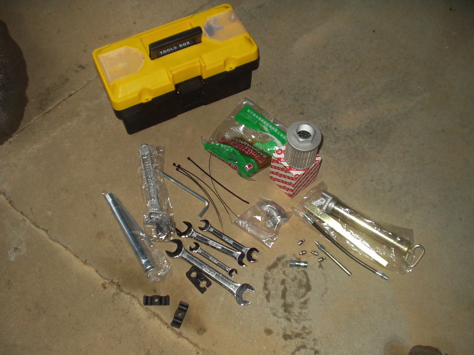

A question to those that have bought one of these, did you get a operators manual with parts list? I am only seeing a B&S engine manual (was in tool box). I will message the Seller about it but I am curious.

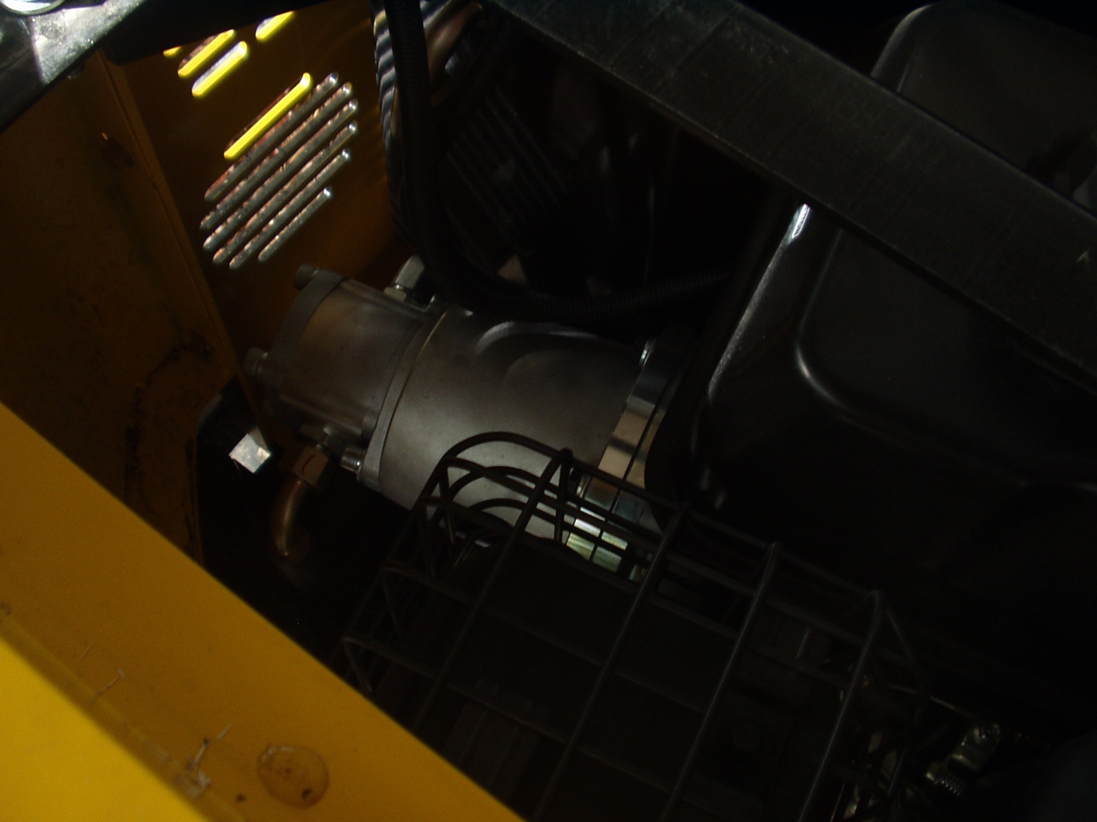

I see that it has a tip forward seat that gives access to the engine below. I do not see any hydraulic coolers or oil filters so that looks to be a modification for me. I did find a odd looking pipe screw on filter of some sort in the tool box. Have no idea where it might go. Chuckled over the grease in a plastic bag (I guess you pack the also included grease gun with it). I am including a photo of box and contents.

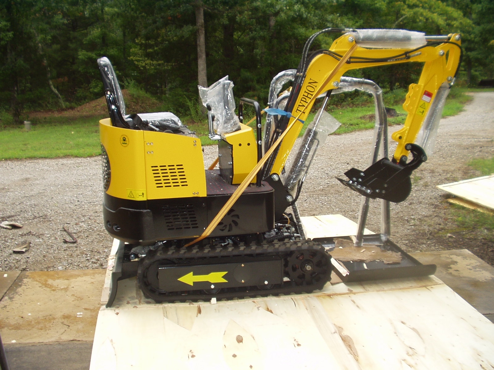

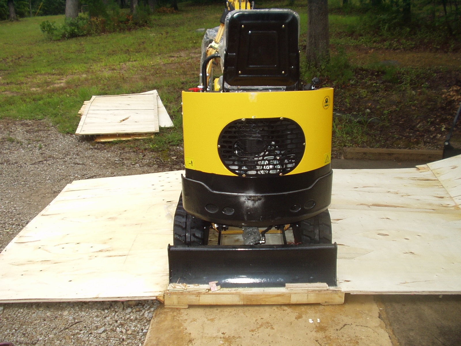

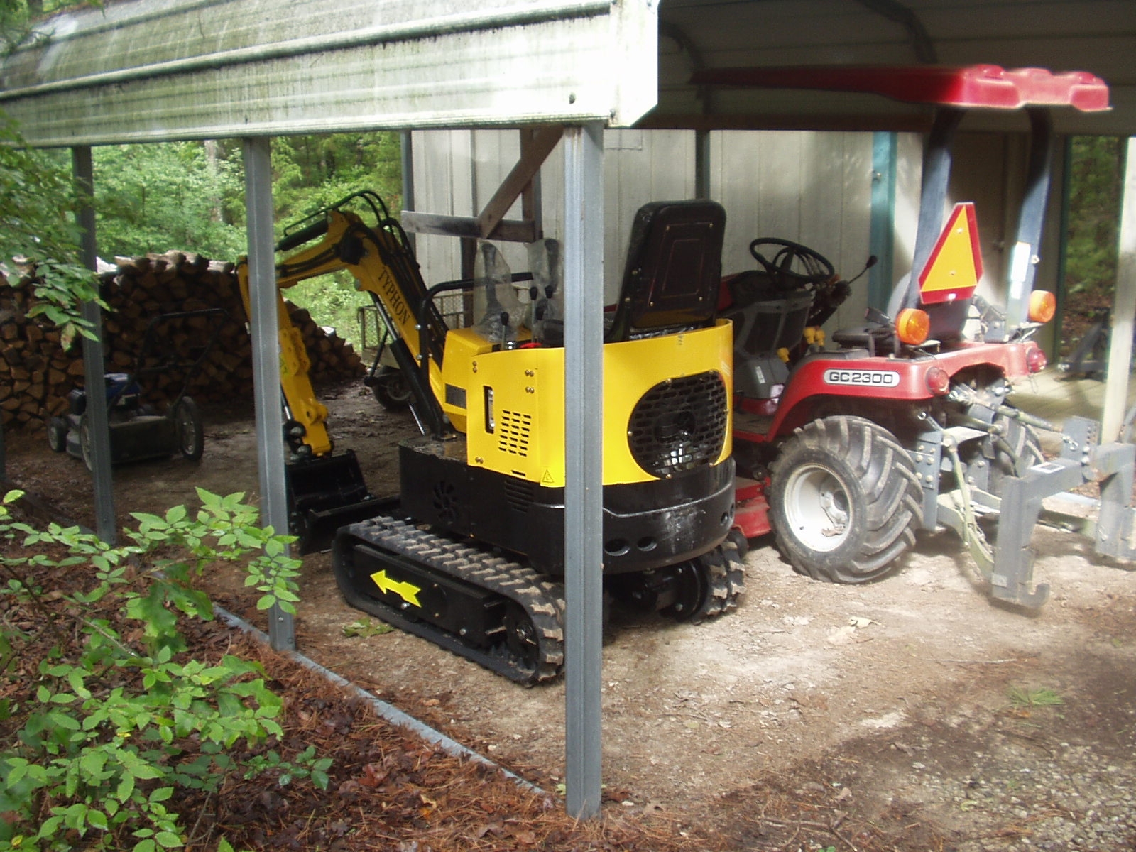

Got a break in the rain and went ahead and got the Baby Ex unpacked. I moved it down under a carport I have to get it out of the rain. I have to go through the unit and put on the attachments and canopy but I am in no hurry with it because either being gosh awful hot or wet outdoors. Here's is some gratuitous photos for those interested.
The only "manual" I got was generic. Nothing specific to my machine. Useless.
As for the spares you got, it is common to get replacement mesh suction filter, which not needed, and a spin-on diesel fuel filter, since these machines default to Koop or ChangChai 499cc diesel engines.

Just got done getting the canopy mounted. Not an easy task since the holes in the tubing and the metal cap were not perfectly aligned. It required pushing, pulling to align, jam in the bolts and reach for the next one. I am glad it is a 4 post model though rather than the overhang style.
Edit: Mounted the hydraulic Thumb this afternoon. It bolted up easily and the supplied hydraulic lines seemed to fit without modification. Not quite ready to run things yet (I did move it initially under the car port off the shipping crate.) but close. Going to attach quick hitch tomorrow and check all fluids again and wire up the hour meter (It came with one wire disconnected probably to prevent a dead battery if somehow the disconnect switch got turned and left on).

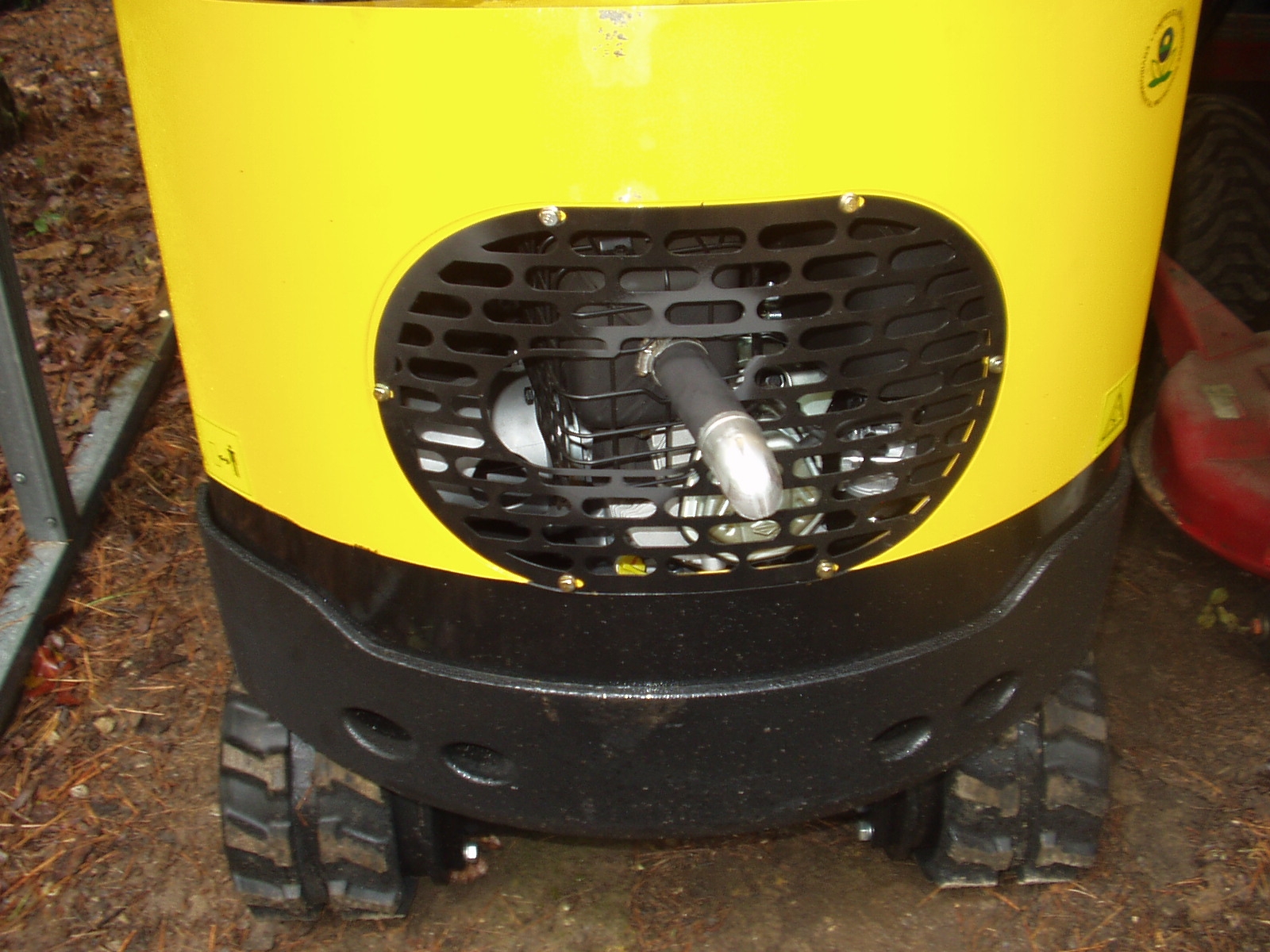

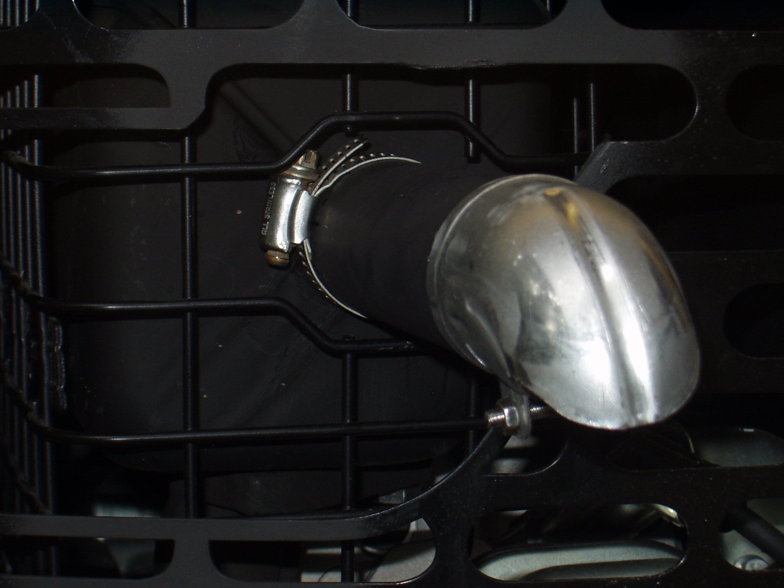

I do have question for those that have one of these mini Ex's, Does anyone know of a good aftermarket bucket maker? The one that comes with the machine, and others that can be bought, all seem to be rather poorly made. I notice that the factory installed one is even cheaper made than earlier types seen in marketing images. Just welded steel plate with no cutting edges and those bottom bolted on teeth.
Edit: I did my first mod by cutting out a bit of the back panel to allow an exhaust extention to be made. Not entirely sure if it is 1-1/4in. EMT or 1-1/2in (external measurement of what I used) cut 5 inches long painted with high temp black. With a porta bandsaw I notched so the the ends would expand to fit over the exhaust pipe stub and affixed it with a hose clamp. Seems fairly solidly attached to it. I than attached the supplied deflector from the tools box. The deflector I left shiny to help seeing it and to avoid hitting it accidentally.
