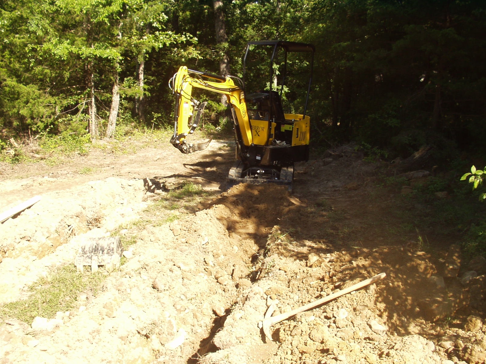

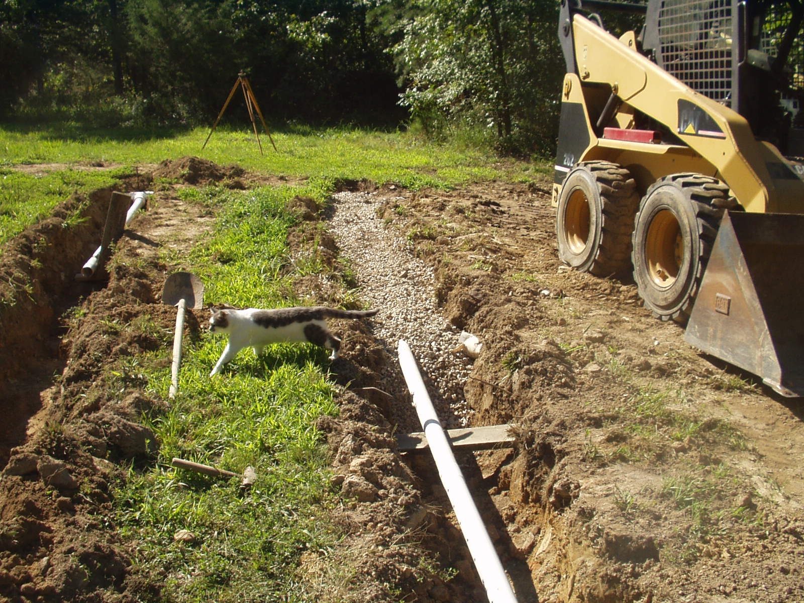

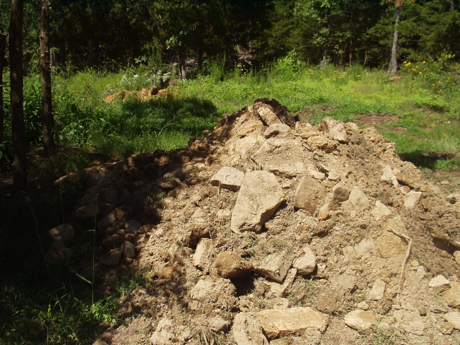

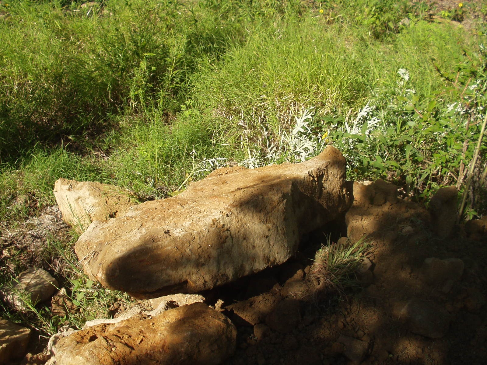

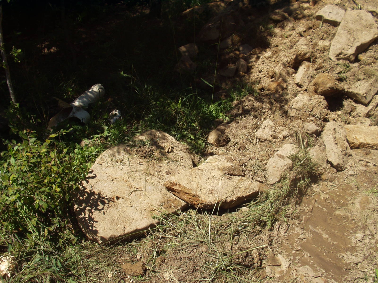

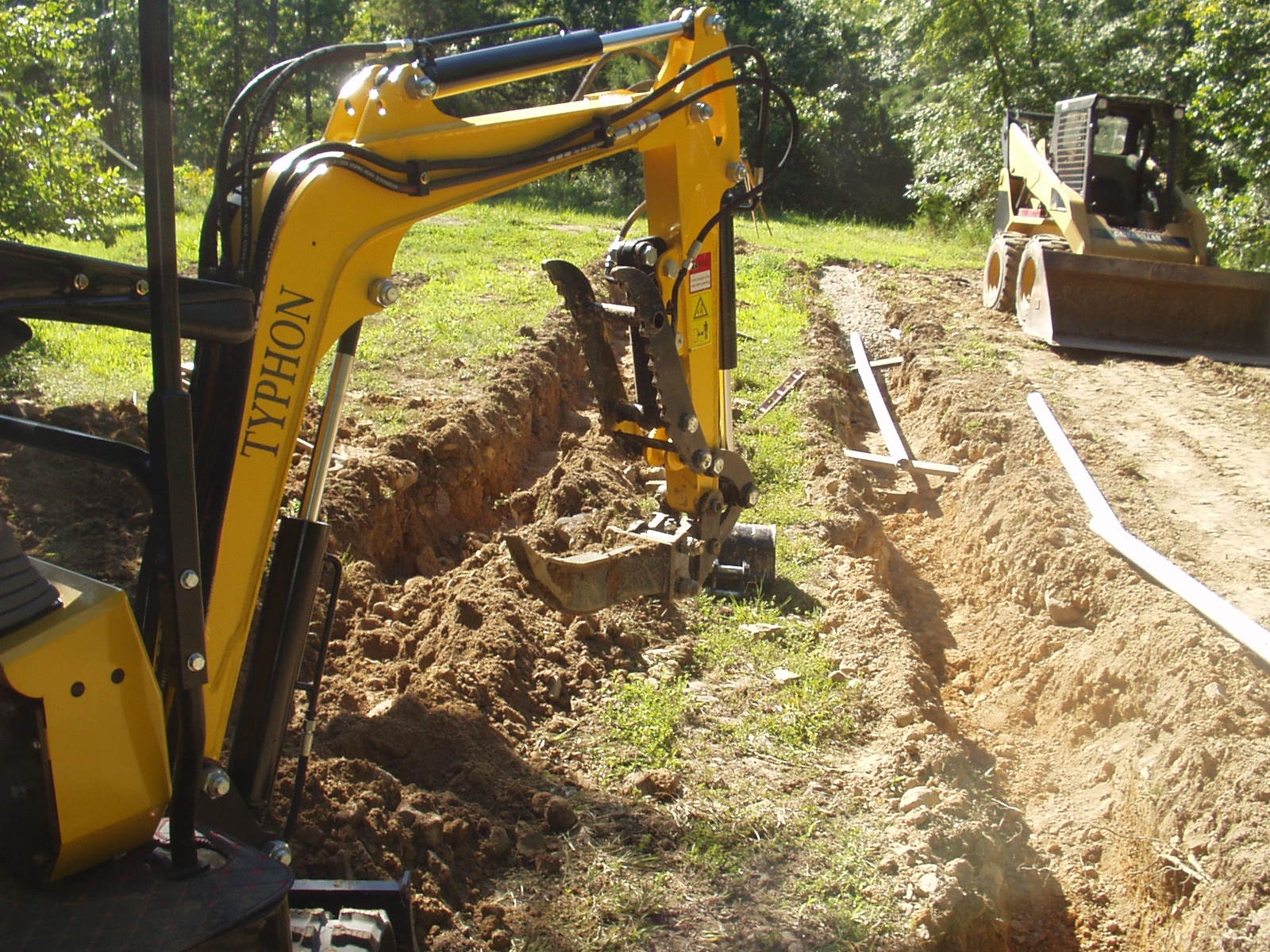

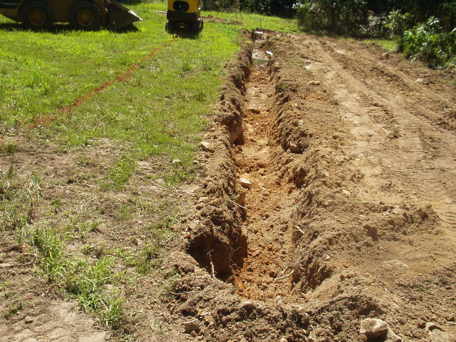

Some thoughts and images of my first project with the Typhon Baby ex.
Boy this thing gets hot after an hour. Good thing the last few days a nice cool front came through. I have ordered a fan for the unit and will install it hoping that it gives me a bit longer than an hours seat time before having to let the Ex. cool down. First off the unit takes some getting used to in order to be productive. The narrow track base and jerky turns is a bit disconcerting. Second observation is the bucket teeth are terrible in rocky soil. The flat hard sandstone rock I have in my soil caused the bucket teeth to slew inwards as it attempted to grab on them in the side of the trench. My first 50 ft trench was all done with the bucket and also a pick and shovel on my part. Real pain.
Yesterday afternoon I get in my ripper and it is a god send in terms of breaking up the soil and leveraging out the rocks. Along with the quick hitch to change to ripper and break up the soil and rock before switching relatively easily back to the bucket made the trenching possible. By the way one issue with the supplied 15 inch bucket and trench size is the width of the unit makes it impossible to straddle an already dug trench if your find that you needed more digging. It works alright with the ripper because you can push back in the ripped up dirt (after you pull out the boulders) before switching to bucket.
My dig time for the trenching was 7 hours. At 5 hours I drained and replaced engine oil.
Hmm. I never tried to straddle a trench, even when using my 12" bucket. I think that would make tipping over a very likely probability.
The ripper tooth is a must-have, IMO. When building my trails, I would hit many many rocks, and the house motor is quite powerful, allowing me to push my tailings off to the side.
That first oil change is very important. I go with 25h max after that. More often if you run really hot.
