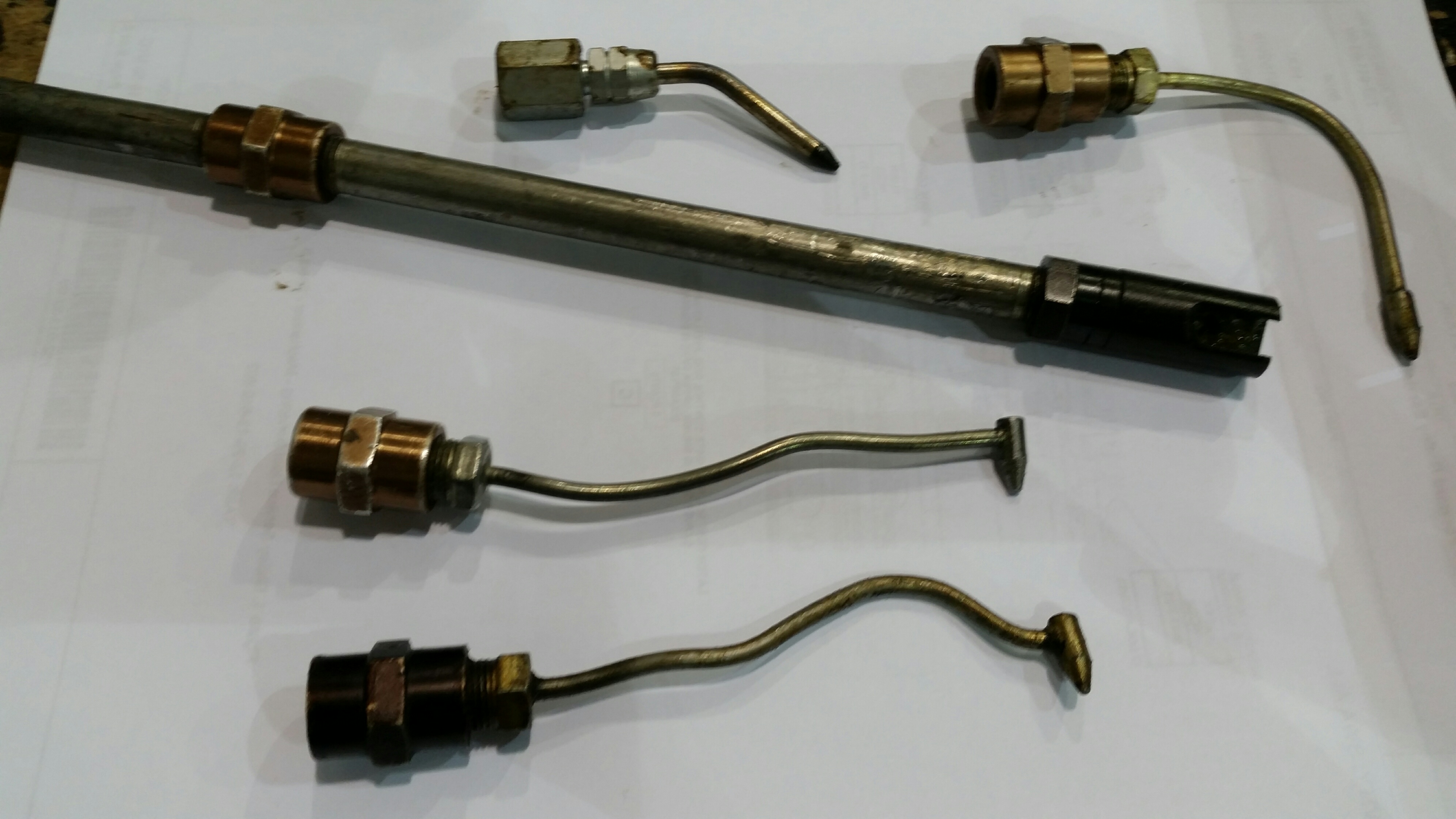

At work, we have zert fitting grease gun fittings that will slide on, 90 Degrees to the zert. One side is cut out. You only need about a 1/4 inch to push on. It doesn't lock as good as a zert coupler, but does the job.
We also have 90 degree flush adapters when a straight one won't work.
I'll try to remember to take a photo of it tonight.
hugs, Brandi
   / Importing and modifying a new mini excavator from China #84
Here is the 90 degree zert coupler I use at work and sometimes on my Mahindra's steering cylinder zert.90 Degree Grease Coupler.jpg
Also the 90 with various needle fitting adapters.90 With Needle Grease Couplers.jpg
hugs, Brandi
#85
Also the 90 with various needle fitting adapters.View attachment 567012
So those 90-degree needle fittings for your grease gun require some tool to apply pressure at
the head so grease gets injected. Looks difficult. Thx for posting, Brandi.
The 90 degree needle fittings won't grease at all if there is any resistance. You have to hold pressure with your free hand to get grease in. Then, there is that squirt your face factor increasing
hugs, Brandi

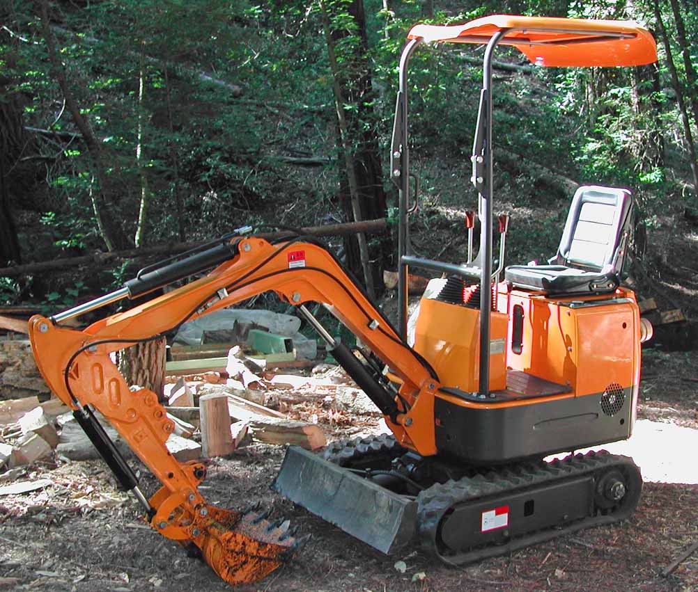

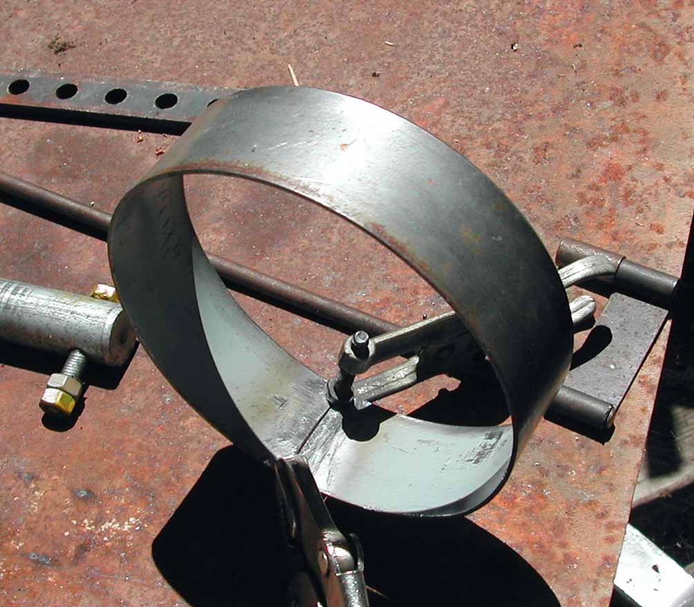

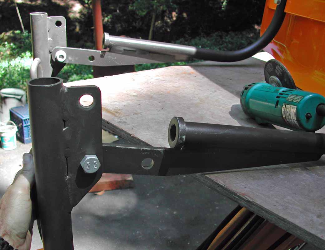

Before I got to using the mini-X, I installed the larger bucket and removed the mechanical
thumb. There were no teeth on this optional bucket, so I made and installed my own.
I thoroughly dislike the soft cast steel teeth that often come on low-priced equipment. They
are just too dull, and don't hold a point or edge. Years ago I tossed my cast teeth that
came with my Bulgarian backhoe and made up weld-on tooth holders. Then I used crimp-on
replaceable teeth with very tough steel cutting edges. Works well, but I have never
replaced the teeth.
So this time, why not just directly weld on some tough steel teeth? No tooth holders at
all. If I wear them out, then I will cut 'em off and weld on new ones.
So here I am, cutting some teeth out of a rake tine. The tine was about $10, new, from
Agrisupply. The bucket photo is after my first test dig. I will see how they hold up.

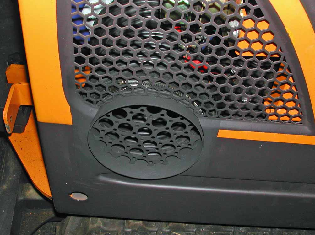

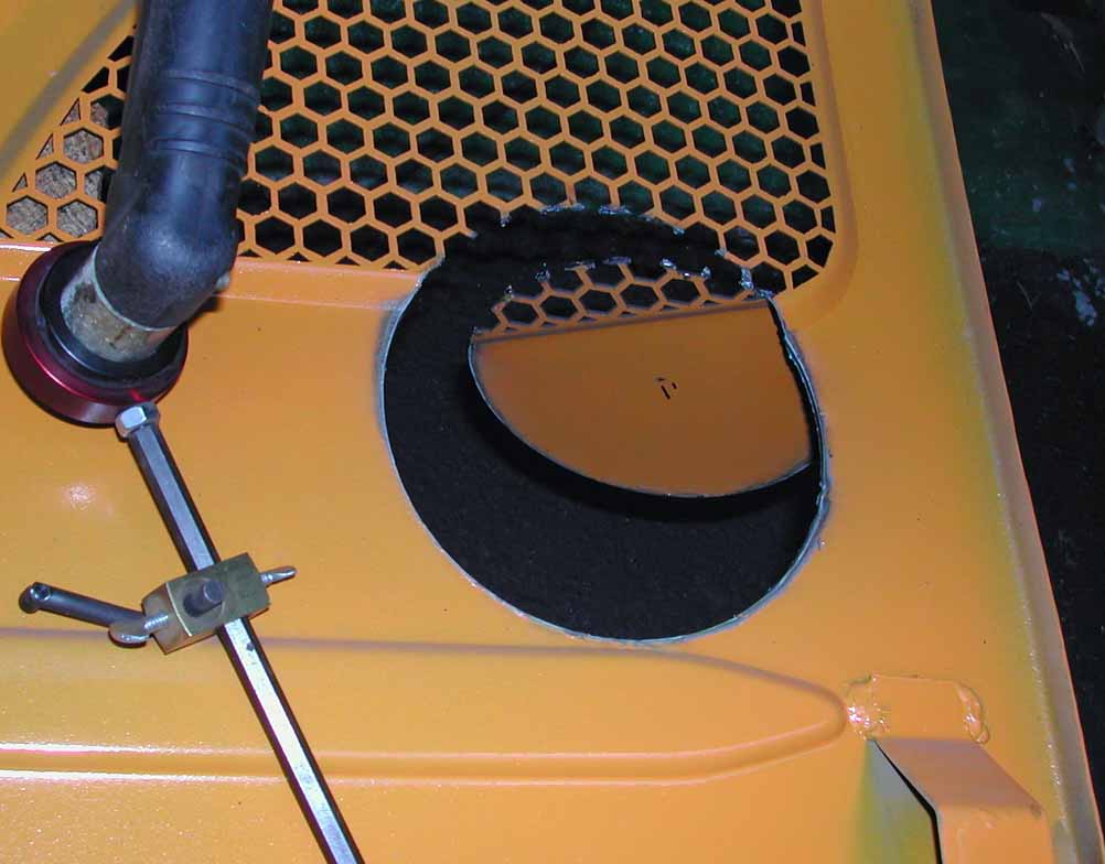

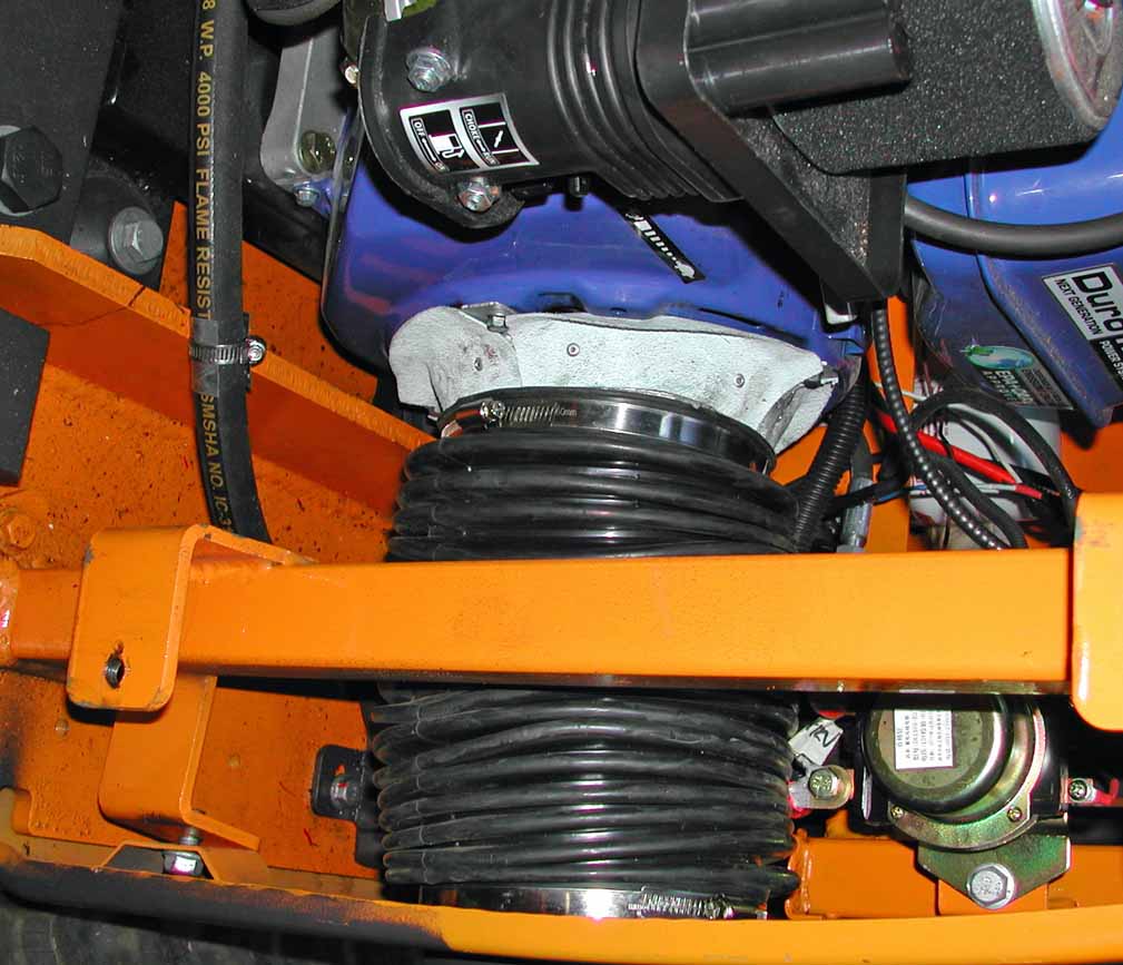

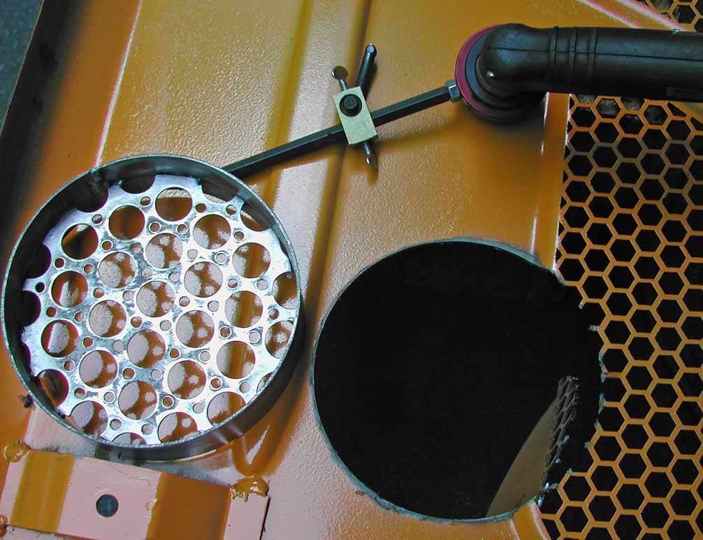

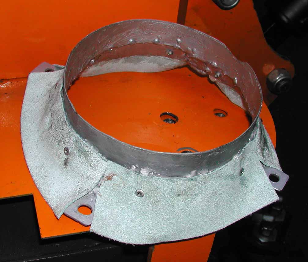

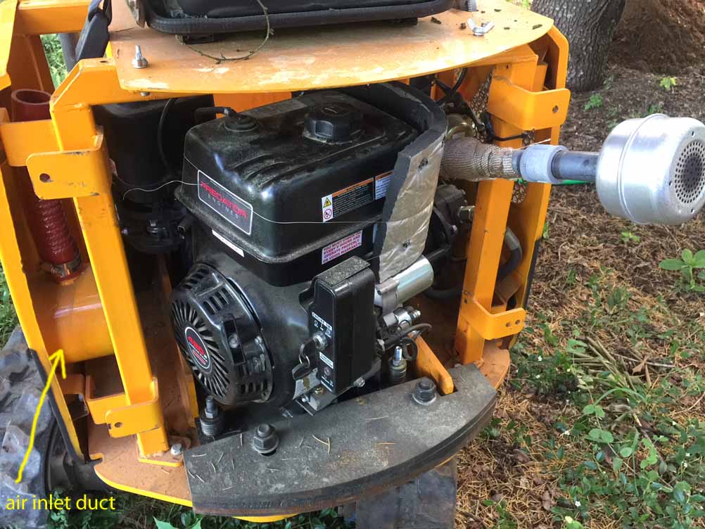

I tossed the gas engine's OEM muffler so I could reroute the exhaust out the back panel thru
the original exhaust port. I tried to modify the exhaust manifold by cutting and welding,
but I was unsuccessful welding it. So I made a new one from plate and pipe, terminating
with a 1" NPT nipple. A new small engine muffler screws right onto that. I may add some
exhaust pipe tape at a later date to route even more heat out the back.
For the air intake, I cut a port in the plastic filter cover, sealed up the bottom holes, and
made up a foam attachment that makes the combustion air come in thru the grille
on the back cover. You can see the results in my 5th video.

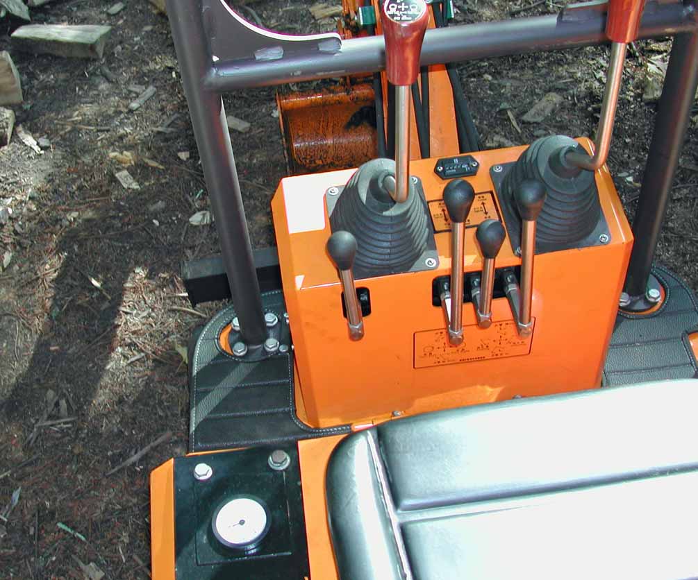

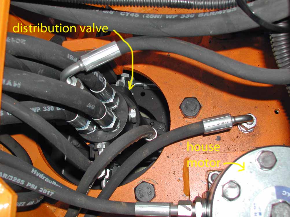

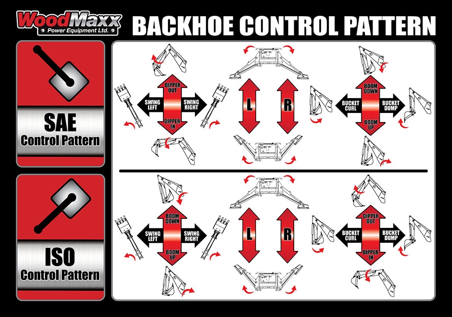

Earlier you mentioned you changed the controls from default excavator to backhoe configuration. Could you explain the difference? Thanks.
   / Importing and modifying a new mini excavator from China #97
There's two different standard configurations for the joysticks and what functions they control.
#100
MOSS has it, with a nice diagram.
ISO is what is sometimes referred to as "backhoe" style, while the SAE pattern is for excavators. I have many hours on my backhoe, and there is no way that I am gonna have 2 different configurations here. Note that excavators sometimes have a boom swing as well as a house rotation action. The simple XN08 has only the house spin, so I am using the swing function for that.
The change is easy: just swap 4 hoses. Some other machines even have a selector valve to make this change by just flipping a lever.
