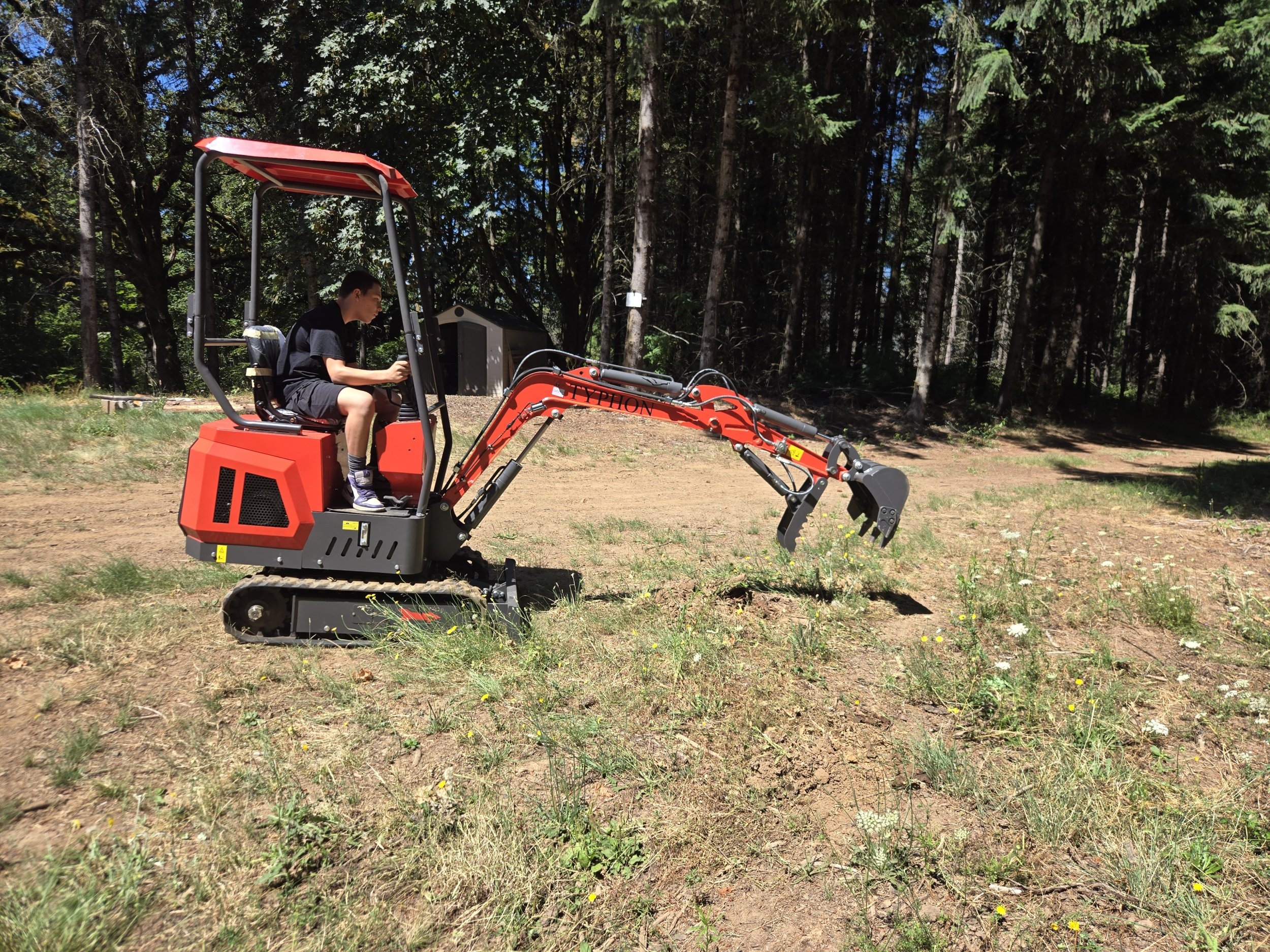

Added a 15GPM filter, grease fitting to thumb mount and cut and re-welded thumb bracket. Really dumb design not allowing the thumb to go further back in the up open position. I was able to get about 6 more inches which helps for fully extended digging. Also added square stock between the thumb to keep it from getting mangled again hopefully. 13 hours on the new machine without issue. It does however really heat the oil up over 180F with a lot of dozing even with a cooler and fan.
Picked up the same model as you. So far I like it but I have the same issues with the thumb. It looks to me like they just slapped a hydraulic cylinder onto a mechanical thumb without any consideration of how far it would go back. Do you have any pictures of the mod you did to the thumb to make it retract more.

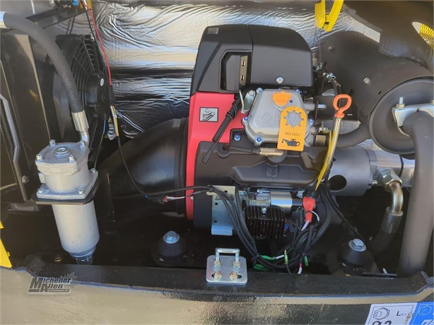

V Twin Gas, Honda Knock Off not exactly sure the HP but I am guessing 25ish. No AC or Heat, but I imagine Heat won't be an issue. Big Hydraulic Cooler, Stacked Pumps, Ducted Air Cooling
Any Ideas on the Canister coming from the Cooler? Looks like a Pall type Filter but I have never seen one before
I can take a pic but if you can cut and weld its not hard, just a bit time consuming.
The plate that the cylinders ears are welded two between the thumb fingers was cut off and the front towards the bucket cut flush with the ears. I then welded the plate flush with the grabby side of the thumb and slide it as close to the boom as I could and still be able to rotate. It interferes much less with extended digging with how I modified it. After I straighten out the thumb I welded a bar (old pulverizer tooth) between the fingers to help it from splaying out again.
The air duct for the flywheel fan looks well-made. I have never seen any V-twin gasoline units in any excavator. I hope the hyd pumps are properly sized for the working RPM of the engine. These engines are are smooth, quiet, fuel-efficient, and cheap.
I have 1 in my Stand On, with the Stacked Pump also. I don't think they need 25hp, but maybe. I can always investigate more flow to match HP. 13.5hp Briggs is better on fuel
