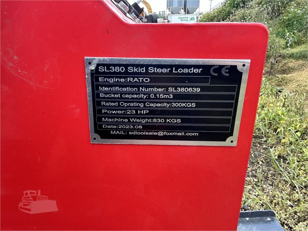

I am not sure of the Brand of the Knock Off yet, my Stand On and Mini Wheel loader had the 739cc Rato.
Chongqing Rato V-twin gas engines seem to stop at the R670, a copy of the Honda GX670. I think they are the maker of the Predator 670. To get over 700cc in a gas twin, you likely have to get a Kawasaki, Kohler, or some other Chinese engine.
Rato seems to have a good rep, and the several new and used ones I have owned were good. Numerous Chinese GX clone makers still do not put their names on their product. I have one of those (420cc) and it is not as good.
   / Importing and modifying a new mini excavator from China #1,402
Rato top out at 999cc
Both my SDLOOL380 and my Traner TR45 had the 739cc Versions

Yes, I have seen them, 739cc anyways. Rated @23HP. This latest machine's tag states 25hp but no Brand Name on the Tag.

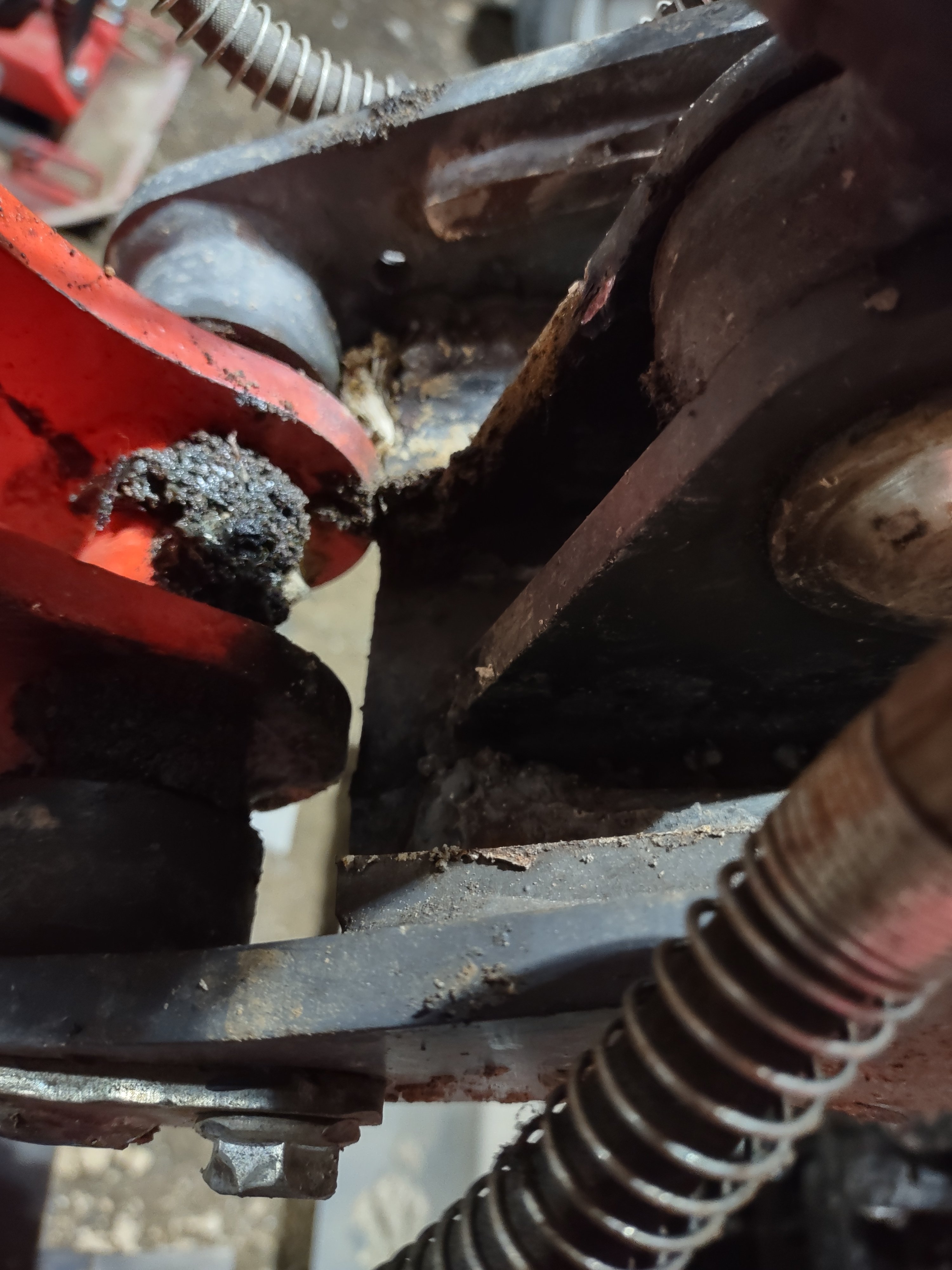

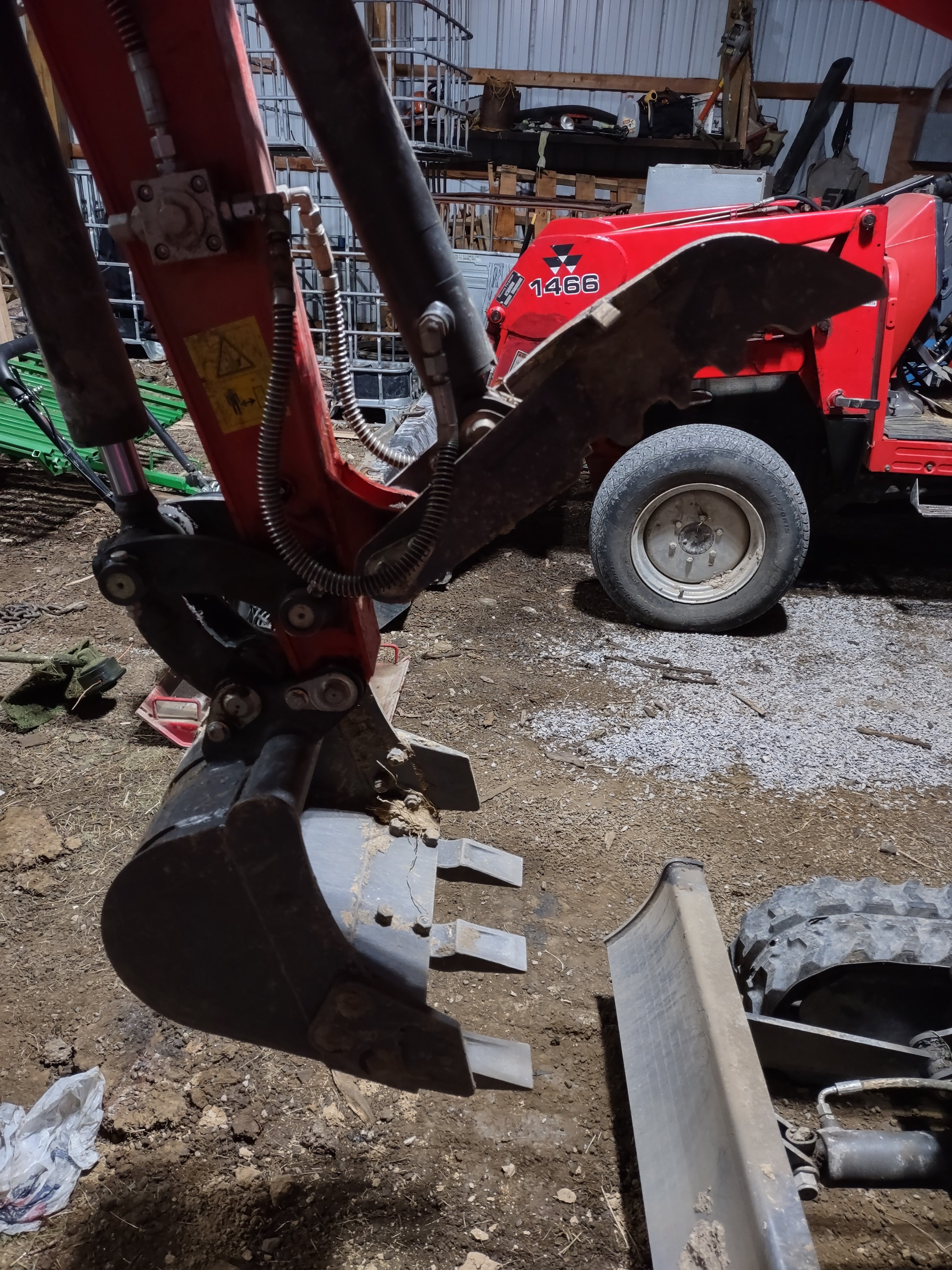

Picked up the same model as you. So far I like it but I have the same issues with the thumb. It looks to me like they just slapped a hydraulic cylinder onto a mechanical thumb without any consideration of how far it would go back. Do you have any pictures of the mod you did to the thumb to make it retract more.

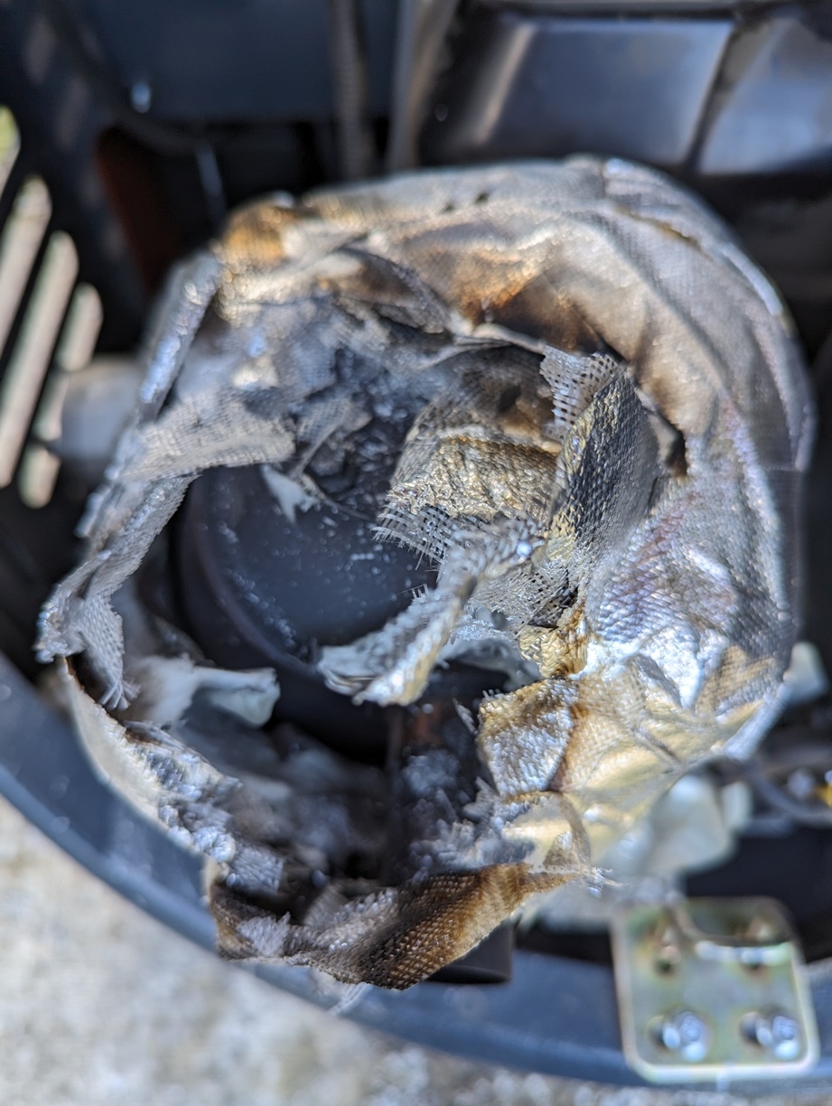

wrapped muffler with motorcycle muffler packing & muffler tape. it melted and the tape burned. measured temp with heat gun, it was over
900 deg f. what are you all using for this? thinking about trying carbon fiber welding blanket.

I just bought exhaust pipe wrap on the internet. No tape, just metal straps to hold it on. It served fine until wood rats chewed some of it off. Since then, I just added some fiberglass insulation and some more steel wire to hold it on. I only put it on the pipe between the manifold and muffler. My muffler is outside the house.

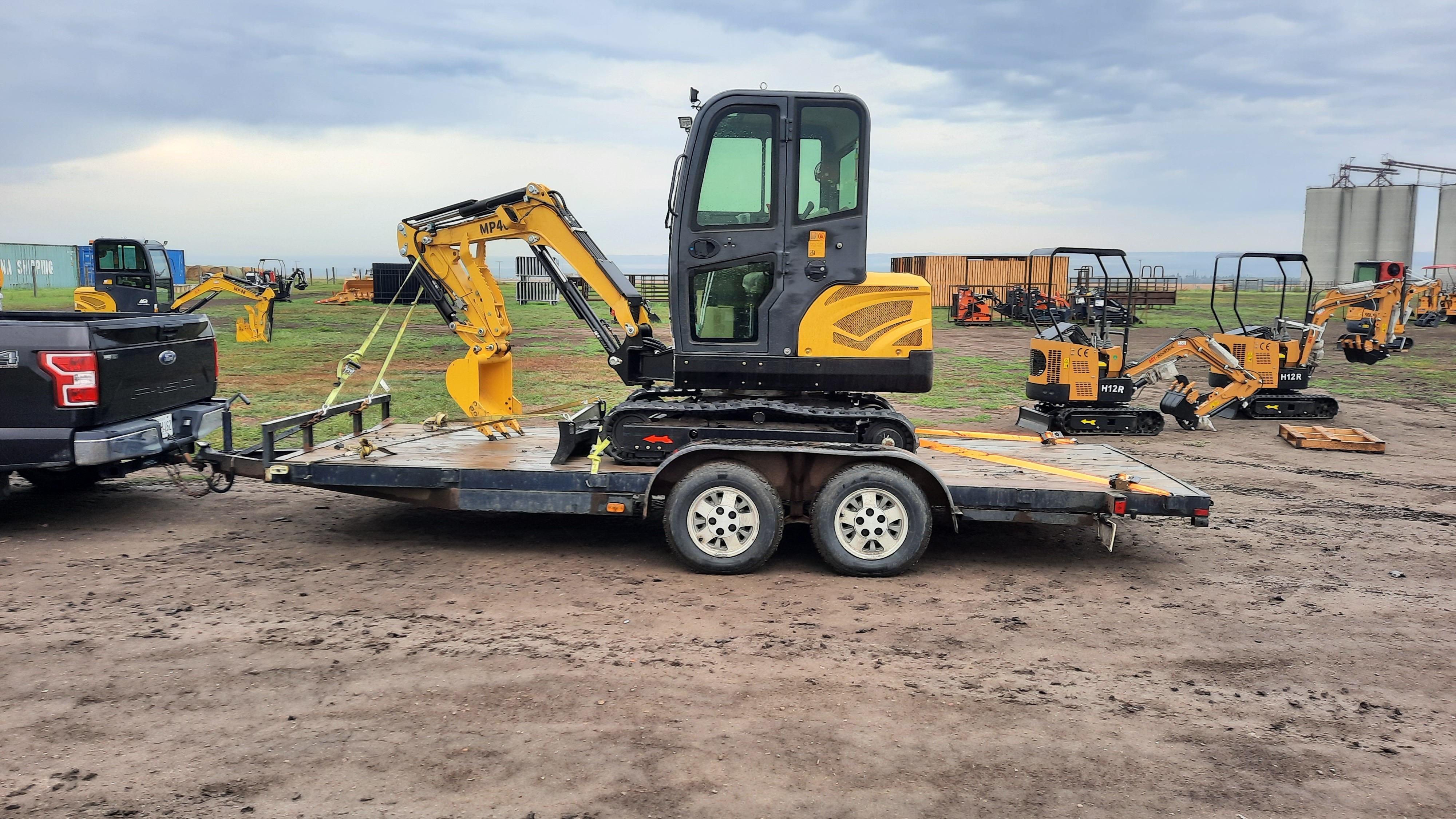

Here is the Corker. So I got back Tuesday, Slept, Worked on it Wednesday. Loaded it, brought it Home.

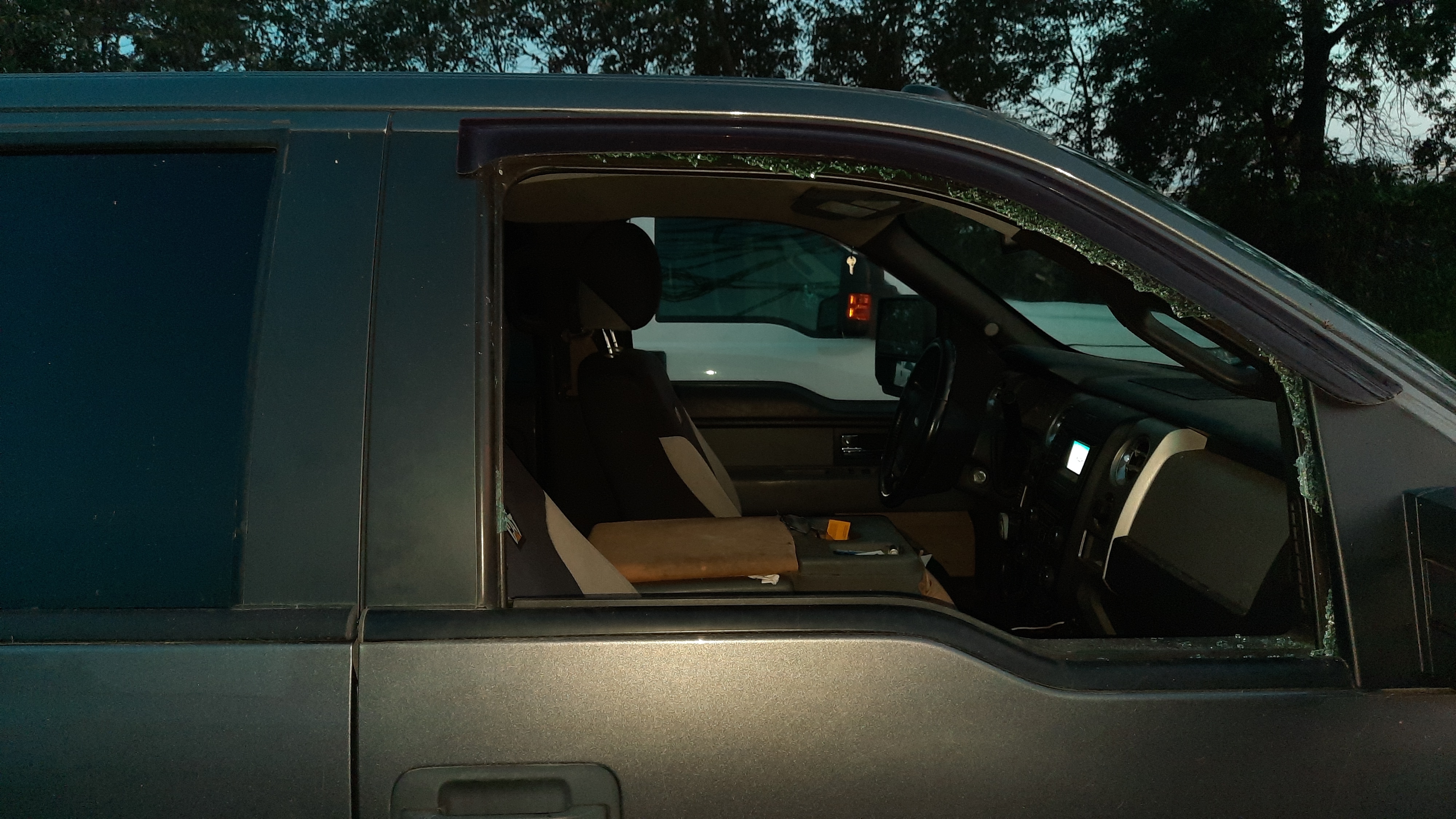

Went to the Cabin Thursday, and someone broke into my Truck, smashing the Window
Stealing the Keys left in the Cup Holder. So now I am screwed, Door, Machine, Fuel, Motor Cover, and Hydraulic Fill. All different keys.

Here it is. On it's way home. 2900km (1800 Mile) round trip
