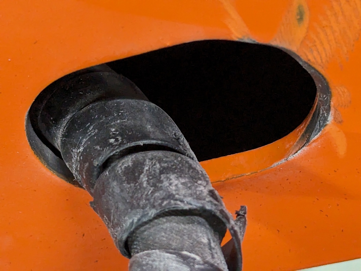

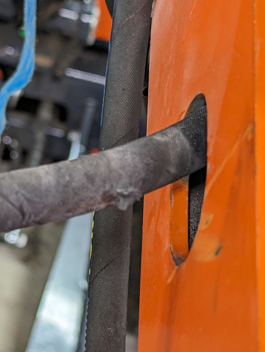

on the L12 where the hoses come out of the boom, really sharp edges. took die grinder & rounded them off. replaced damaged hose protector.
almost ready to start using this dang thing.

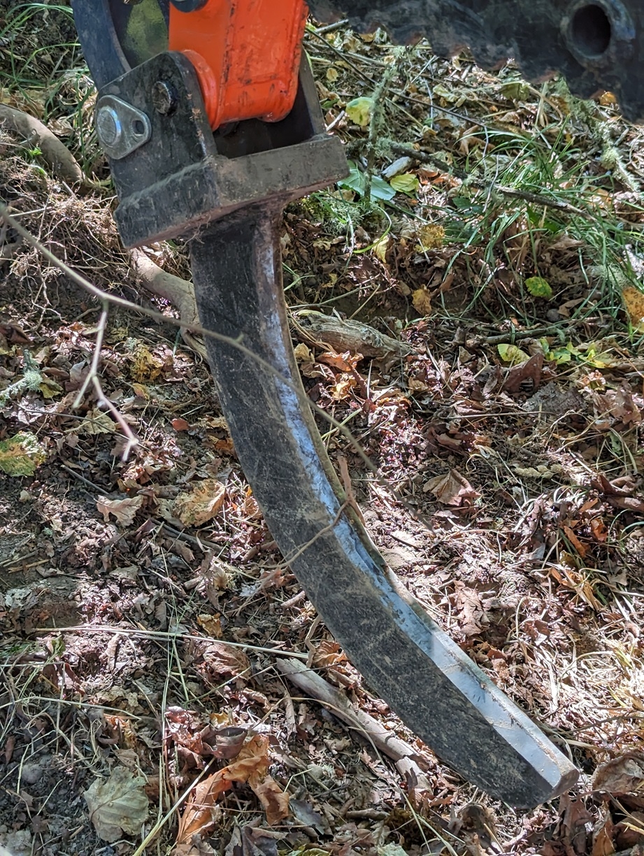

made ripper. works ok. may cut shorter & sharpen it more.
