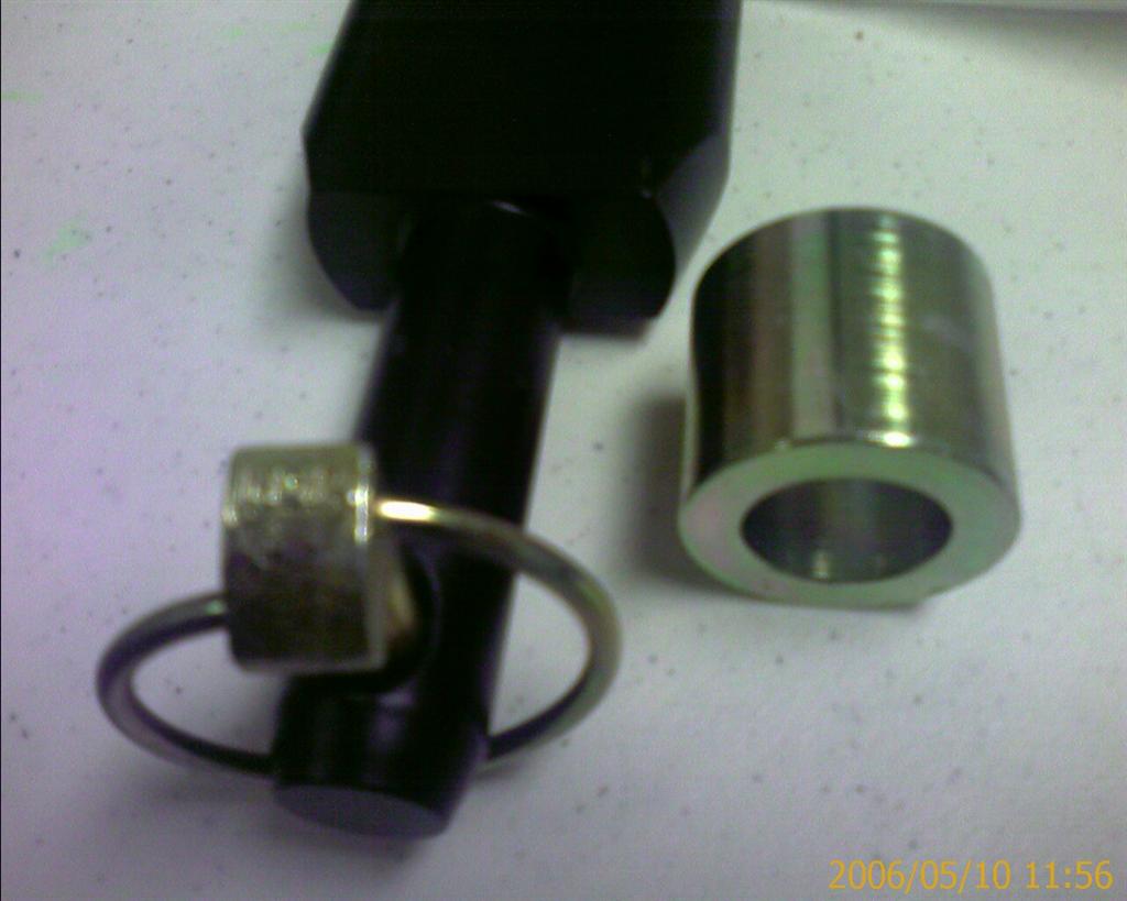

To help future searchers:
Many pieces of JD literature will direct you to JD part number LVU12858 for I-match / quick hitch bushings.
These are junk. They are very short (1.26") and will slide back and forth on the pins, which are much longer. They require the snap rings (still searching for the proper terminology for these things) to keep them on. These are not the units pictured in quite a few marketing pieces from JD.
Pic of LVU12858 from JDParts attached.
Dimensions of A, B, C in pic:
A: .892"
B: 1.435"
C: 1.26"
