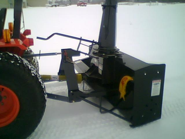

Hey back in learning mode now. With this rear snowblower I see skidshoes for this blower are listed as a weld on option and cost around $100. What's this about? Without skid shoes am I to be expected to keep the blower pickup height adjusted with the 3ph control or can I let it float? If it floats on the ground don't I need to first install the skidshoe accessory so as not to pick up rocks so much and abuse the bottom of the blower? I have never used a tractor to blow snow but have moved tons with walk behinds sliding on adjustable shoes.

I haven't used a rear mounted snowblower, so I'm sure others will chime in here with better information, but you do have some options. Adjusting the top link so that the leading edge of the snowblower is slightly above parallel with the ground seems to help folks avoid some of the gravel issues. Can't do that with a front mount! :D :D

It would be interesting to see the weld-on skid shoes. Mine are adjustable, though I've got them on the highest clearance setting. It leaves some snow but I never pick up rocks or break shear pins.

I have a 3pt snow blower that has two straps of flatbar on the bottom that start flush with the cutting edge and are thicker moving away from the edge. I play with the top link to have the edge on the ground or up a little bit depending on what surface I am on. If I'm cleaning ice for skating I extend the top link so the cutting edge is hard on the ice to make a clean cut. If it is first snow on the driveway I shorten the top link to roll it back on the skids and leave the stones on the driveway until there is a bit of packed snow on them.
I don't mind the 3pt blower too much because there are times when the fel is the right tool to have on the other end. A blown down tree is tough to wrestle out of the way in deep snow but not much trouble with the fel.
My tractor is a B7610 HST front wheel assist on turfs and I seldom have tracion issues when using the blower. Usually I run in 2 wheel drive and count on the tires slipping if I catch something unexpectedly. Keeps from tearing parts off:eek: .

After all this stuff and it still seems to me this blower will be better off with a pair of adjustable shoes. I'll be sure to check with the dealer just to be safe.Must be more to a Meteor 3PH snow blower bottom for protection. (rimshot)

I never realized that one could throw an adjustment and tip the box back to stay atop any existing gravel. Makes me all the happier for getting the rear snowblower and still keep the FEL available.....thanks (rimshot)
