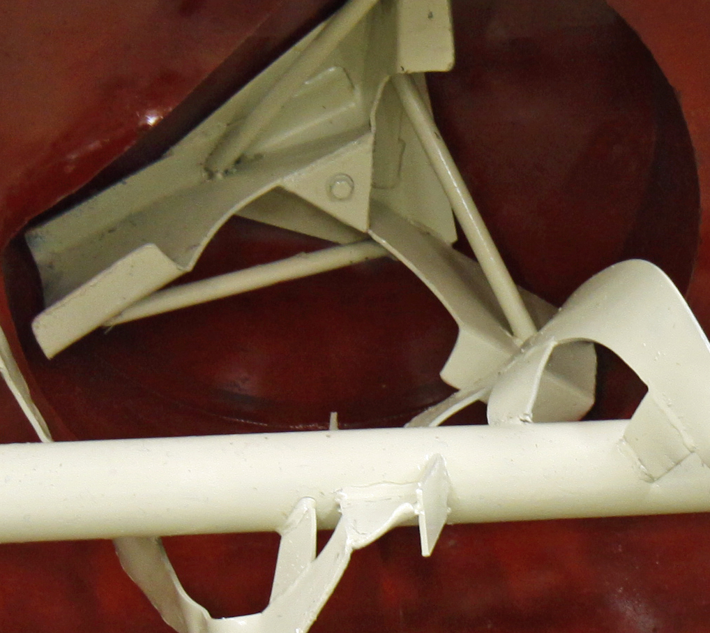

Everlast Welders (an advertiser here) Model 140 and 200 both will work on 20Amp 120V circuit and they are decent welders, not too expensive, and offer TBN members discounts.

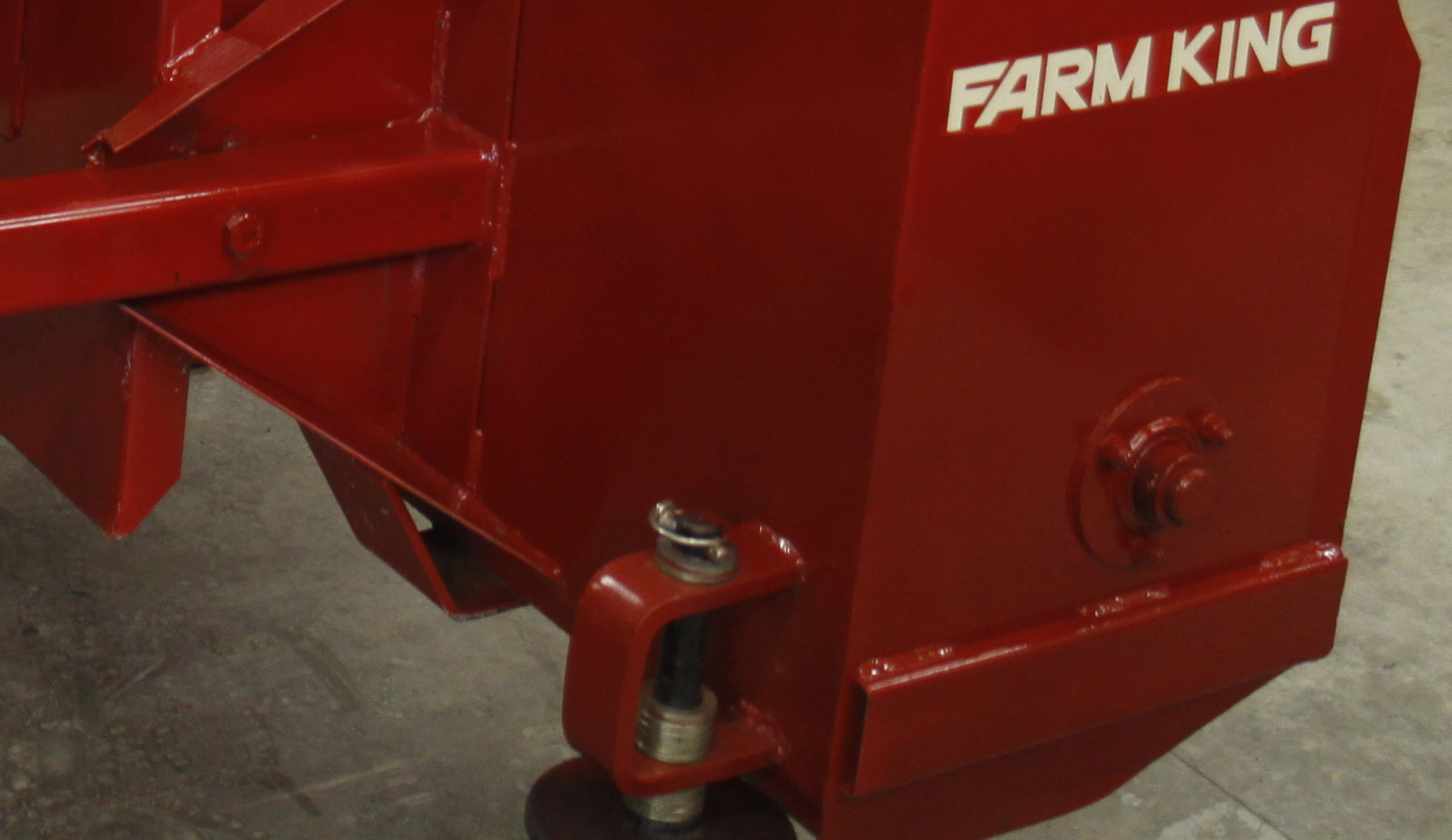

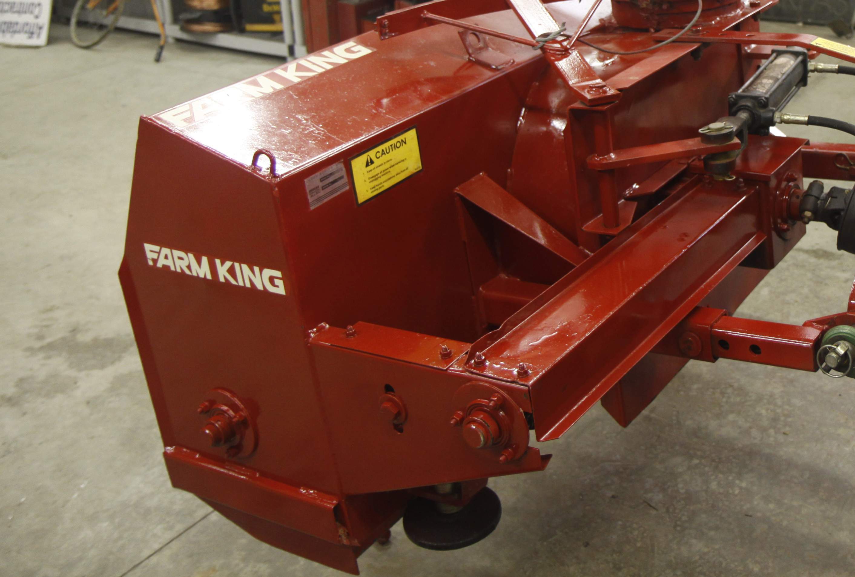

It doesn't appear your material is overly thick either - just need to clamp it together and weld. Looks like you should improve your skid shoes setup too.

If I wanted it fixed now I would get 4 or 5 $3.00 C-clamps and hammer the thing flat and clamp it back together. There are holes in the two pieces now I would drill some more and put some 1/4 inch carriage bolts in. Make sure the flat head is underneath and the auger is not going to hit the top part of the bolt. Flat washers would add a little more holding power. Ten bolts will make it work until you can get it welded.

You need more than a welder! The cutting edge was worn down far enough to wear the heads of the carriage bolts off and the edge of the blower housing is worn as well. You need to get a new cutting edge and repair the blower housing, perhaps cutting and welding in a new section drilled to match the cutting edge bolt pattern. If you don't have the skills and/or equipment to tackle the whole job time to find a welding shop, they will have it back up and running in a day or two. If you do go to a welding shop bring a new cutting edge and the bolts with you it will save a lot of time.
