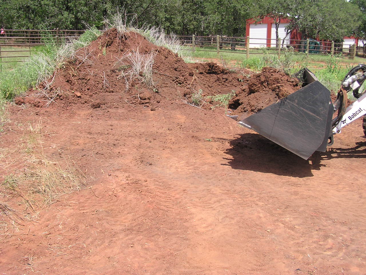

One big difference is the toolcat will not move or dig dirt like the 247 can. Good luck

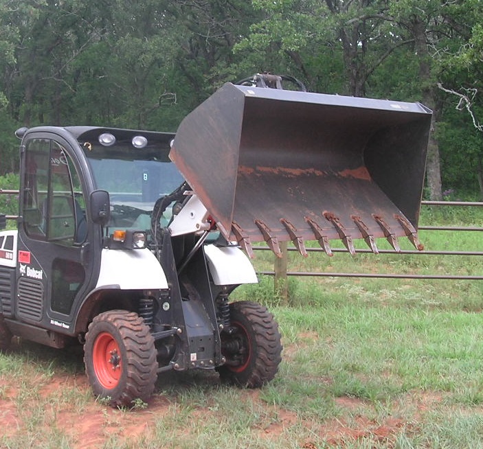

But it will still move dirt. This is a toothed 1 cubic yard Versahandler bucket.

I've got a Bobcat 62" Lo-Profile bucket for the Toolcat and I haven't been impressed with it's digging capability. There are provisions to add a bolt-on tooth-bar to this bucket and am thinking that this will help digging. Does anyone have any recommendations on a tooth-bar that's not priced like it's made of "Unobtanium"?
Thanks, DEWFPO
   / If you have Toolcat questions, ask them here... #338
Thanks, DEWFPO
Mine are individual bolt on teeth, two bolts each. The dealer threw them in as a discount when I bought the Versahandler bucket.
There are several styles for sale on eBay.
The teeth sure make it dig better.
   / If you have Toolcat questions, ask them here... #339
Thanks Xfaxman, this looks like a good cost effective solution for me.
DEWFPO
