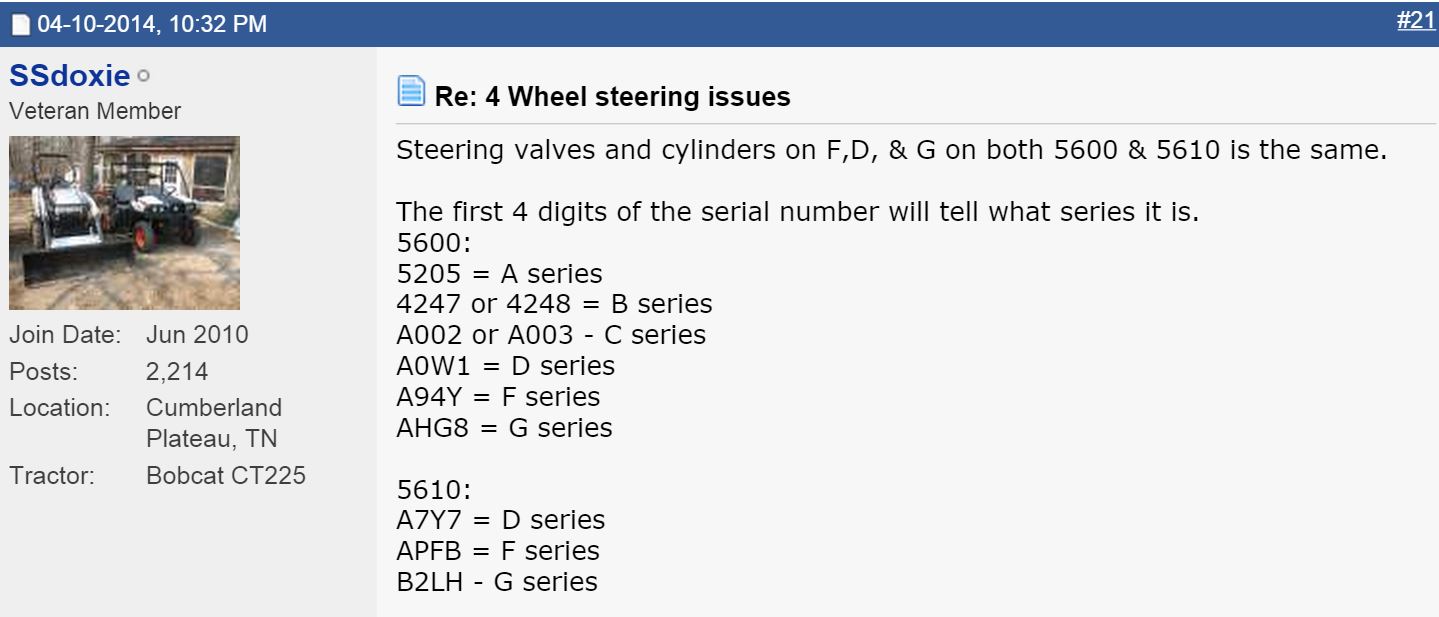

What Series is it?
You can tell from the serial number (thanks to SSdoxie).
