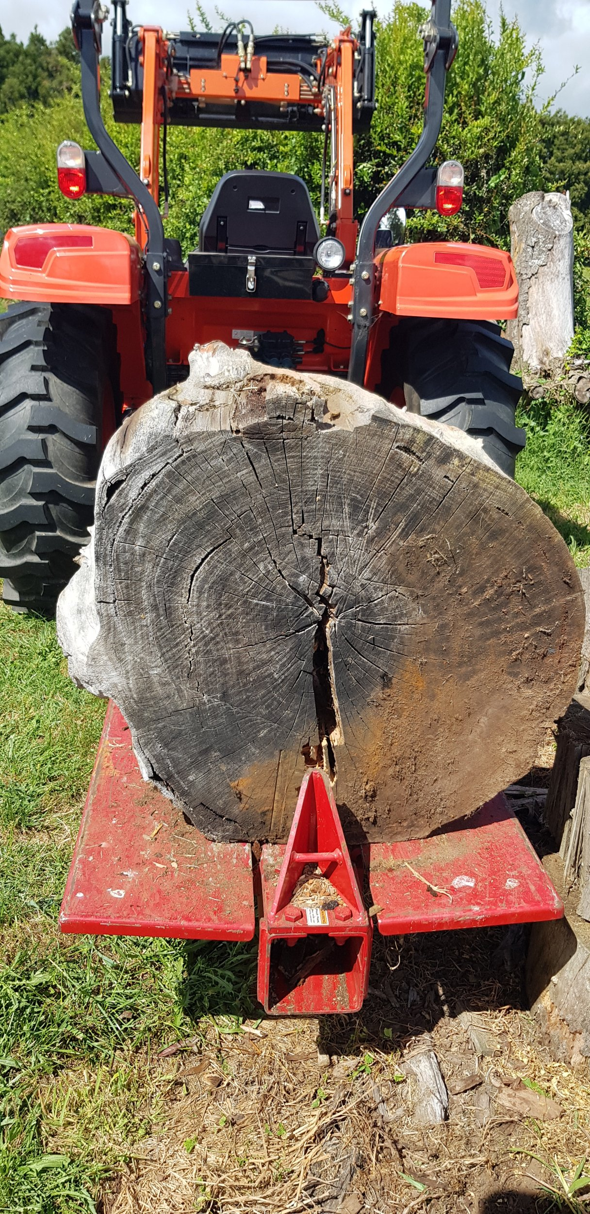

Effect of idling 1100rpm tractor Kioti NX 6010 for long periods when using wood splitter ?

Does it have a DPF?

Diesel Particulate Filter. Yes it may have.
I suggest you to read a little bit about DPFs, so you understand what goes with it and how to adapt to these things. Or you can contact the dealer so they can explain and teach you more about the DPF to avoid future issues, like clogged DPFs.
Just running a light load with the splitter, it may ask for more frequent regens than normal, but should work ok regardless. Basically tractors with DPF need to be ran hard and at high RPMs to keep the temperature on the DPF high and prevent it from clogging.

Up here in the heart of winter, we have to "high idle" our tractors. I idle mine at 1500-1600 rpms. If I don't the tractor engine actually gets cold enough for the temp gauge to go back to the zero peg.
Also if you have an exhaust filter, excessive idling the engine will pack the filter full of soot. Does your Kioti do an active regen? It may need to regen more often the more you idle it.

However, as a few others wrote, run the engine at a high idle (1500)...not going to hurt the engine, fuel economy won't suffer and less chance of lugging the engine (bad for the bearings)

Thanks for the advice chaps, yes I'm in hot and sunny New Zealand currently 27-28'C here 1 jan new years day. At idling speed 1100rpm when splitting wood the temp gauge shows the correct working temp. Tho I have heeded your advice and am running it at 1500rpm
