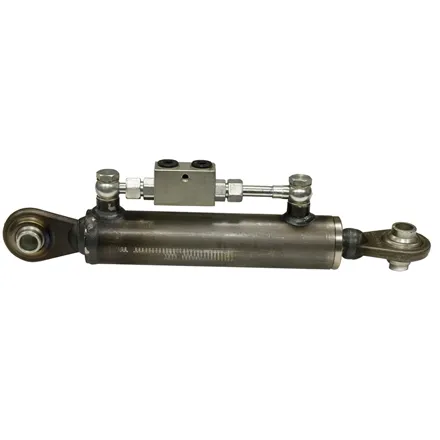

I had a cylinder on repaired on my ditch bank flail mower. In one direction it is very jerky. Is this air trapped in the system and will it work itself out?
The cylinder leaked when I extended it for the first time I tried to use it. Therefore I don't know if it jerked before I had it repaired. Due to circumstances beyond my control I did not put it on my tractor until the 2 year warranty had expired.
Thanks for any help.
Mule

Does this cylinder have a pilot operated check valve? Similar to that valve block on top of the cylinder in the picture below:
Anyway, cycle a couple of times to rule any possible air in the cylinder, but I wouldn't push the lever all the way. I would just feather the controls to not let gravity take over and create a "sloppy bucket syndrome".

Here is a picture of it. I am assuming it must have a pilot operated check valve.

99% of the time, you will solve your issue by installing a flow restrictor on both lines-ports.
I may do that. Do you reckon it would help to install one on all four lines going to the mower? Should I install them at the control valve end or cylinder end?

Yes. It does have the check valve and that's what I figured. Those valves tend to chatter when gravity takes over. Just like MtnViewRanch said, you'll need a flow restrictor.

If the cylinder pictured is the one with the issues, then the 2 supply lines to that cylinder.

Yes it is the cylinder in the picture. That cylinder tilts the mower. There is another cylinder that swings it out to the side and back. The side swing cylinder is very fast, so I will put a restrictor in those lines as well, I think.

The restrictors were delivered this evening. I will install them tomorrow, if the weather is not too bad. It is forecast to rain hard tomorrow. At this time I have to work outside. It is restricted down to 1/32.

A pilot operated check is a load holding valve that prevent the cylinder from drifting under load. It requires a positive pilot pressure to open which typically comes from opposite end of the cylinder.

Update. I installed restrictors in each line. It made a BIG difference. The operation is very smooth and not too slow. Thanks for the help, Y'all.
