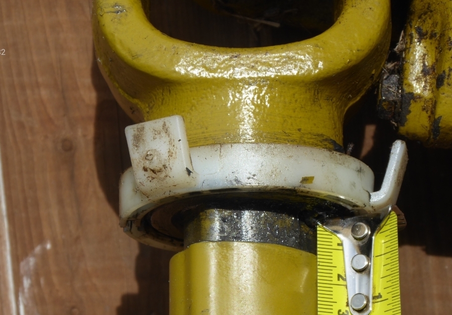

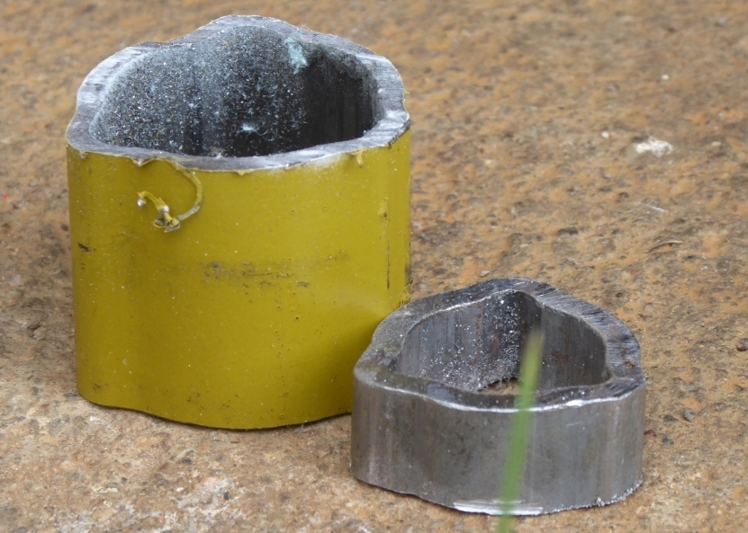

Hi,
Something that's been bugging me for a while, the shaft for the mower is a bit too long. It doesn't close right up, at the shortest position it is still extended by just over 30mm. But it only has enough clearance to attach or detach from the tractor when the mower's right on the ground when there's 65mm extended. I can't do it when the mower's on the trolley I made for storage.
So far I've been working around it by connecting the PTO before the lift arms, so I can push the mower away a little.
So ideally I'd want to shorten the shaft by around 40mm, but I want to make sure the reduced overlap won't be a problem.
Currently the inner part is 770mm long, extended length is 835m, minimum overlap is 705mm, or 27.75". Or you could say the overlap is 84% of the length.
If I take off 40mm it becomes 730 long, minimum overlap of 625 (24.60"). Around 75%.
Any concerns? It's a 25HP tractor and a 4' rotary mower (what we call a "pasture topper")
Thanks.

That's always advised, but the two new shafts that I shortened both started off with the inner already shorter than the outer.
Just to illustrate that point here's the shaft after cutting 40mm off the outer and before cutting the inner. You can see only 15mm or so needs to come off.
These are the actual offcuts. Without doubting your comments that I'll have miles more overlap than needed, I don’t see why I'd want to sacrifice an inch by cutting the same length off the inner.

/ PTO Shaft Length - minimum overlap etc #10
agree , no point shortening either tube beyond that required achieving desired collapsed length.
I'm going to suggest that the reason the inner is shorter is because at the other end of shaft than you're showing, if might interfere with the cross if it's turning at an angle if you leave it too long
#12
The inner can't pass right through the yoke and stick out the other side, if that's what you mean. The fixing pin is in the way, and is presumably what it's stopped by in my picture.
