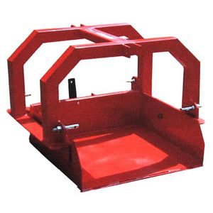

Another way to haul more gravel (without having to load by hand) in one trip and still be able to turn around is buy a 36" wide dirt scoop.
36 Reversible Dirt Scoop 3-Point
Most are 24' or 30", so it might be hard to find a used 36".

I would agree with Countrybumkin and Xfaxman that the rear scoop idea is simplist and better option.
1. You will want rear ballast on the 3 pt when carrying loads of rock that diatance in your loader, the rear scoop loaded will serve this purpose.
2. It is self loading by simply backing inot the pile of rock, no need to be hooking and unhooking from any attachment or trailer. The rear scoop Xfaxman pictured holds about 5 cu//ft. Time saved in loading and dumping will likely offset any extra trips.
3. Easy to manuver in tight corners.
Rather than worry about how to dump off to the side, I can think of 2 otions.
1. Cheapest - carry a rake and shovel with you, dump what is needed from either loader or scoop then push it with the rake to side where needed.
2. Carry and dump rock at all the spots first then remove rear scoop and use an angle blade to move and smooth the rock into the spots.
