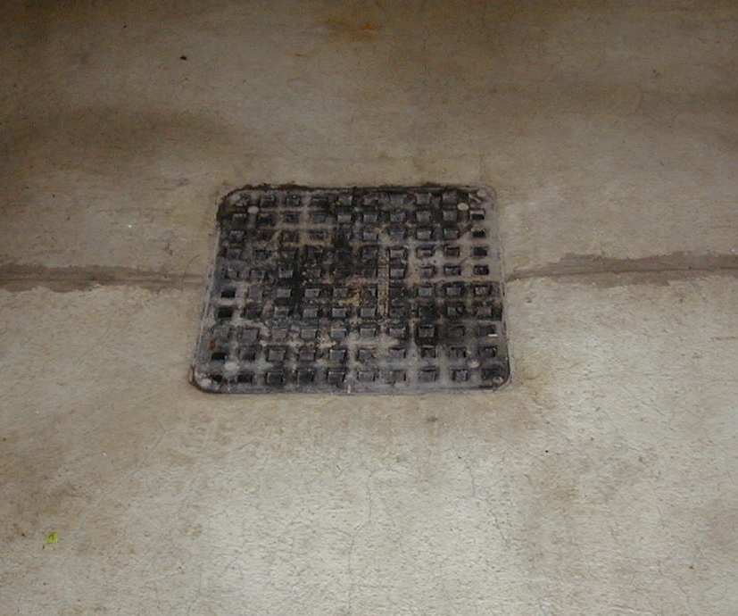

we used these web page with the built in slope at our firehouse and work well they are about 2 ft back from the door and drain to daylight eventyally. We keep some oil only "PIGS" in catch basin to kep oil from leaving just tie them to some thing so they don't go down pipe (we tie them to grates). There is a pan with a low part to catch gravel and other heavy stuff were pipe ties in.

I had a drain put in the middle of one of the bays of my carriage house. The concrete guy sloped the floor so that both bays drain to that one drain. Used it a couple days ago with my car parked in there a little in both bays. Drained well. I've a "U" in the drain line below the drain hole. Can saw it out if I ever have a plugging problem and replace it. You can get "U" pieces that have a removable part in the bottom, but Lowes didn't happen to have that when I put my drain pipes in. Mine all drains just ouside the concrete wall of the carriage house. Had it going into a rock well, but I obviously didn't make that big enough. Took the side out of a tee just above the well through which it's discharging now onto the grass.

We had the builder add two of the square PVC drains w/grates to the attached garage when the house was built. We liked them so much that we had two put in the pole barn when we had it built. With the freezing temperatures that we see here in the winter draining water out the front of the garage would be just asking for a skating rink and we're a bit to old to skate on ice. /forums/images/graemlins/blush.gif

I have the poly drains in my plant, even installed a few of them after the fact, they work well and are easy to install, especially as part of new construction. A bit spendy tho.....
