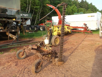

I found this at a local farm equipment dealer for 300. would it be capable of cutting branches up to 3/4" . I would mount it on the fel the same as the samurai.
/ ideas for clearing grown in trails #22
That looks like a PTO driven sickle bar. The Samuri is driven by FEL aux hydraulics, and only weighs 70#s. What you bought isn't meant to run off a FEL.:confused3:

I realize that, that is why I am posting in the "build it yourself" forum. I didn't buy it yet but am wondering how the teeth/cutters would stand up to small branches. If suitable I would mount it on the fel and run a hydraulic motor to it.
/ ideas for clearing grown in trails #24
I think 3/4 might be a bit much for that system. Not saying you couldn't. Do it, but repeated 3/4 inch cuts may not go so well, we dull those on a cutter cutting fescue and alfalfa,

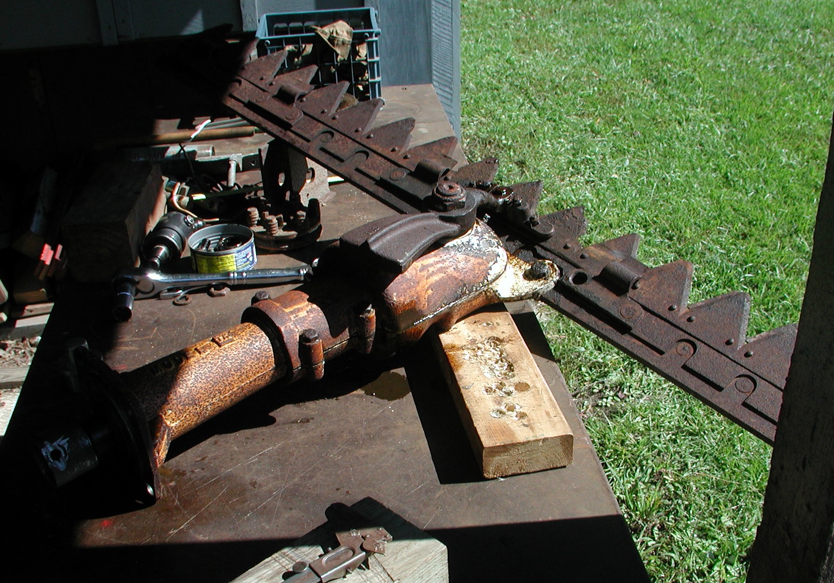

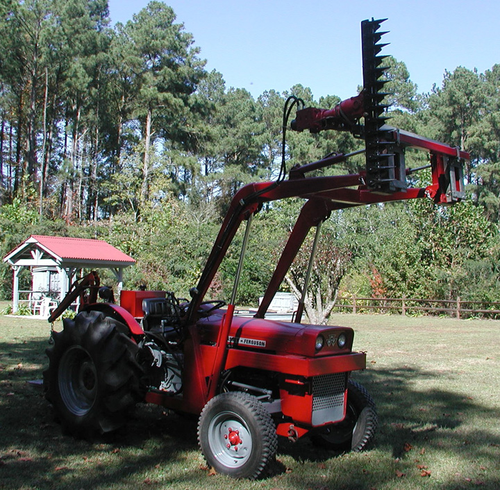

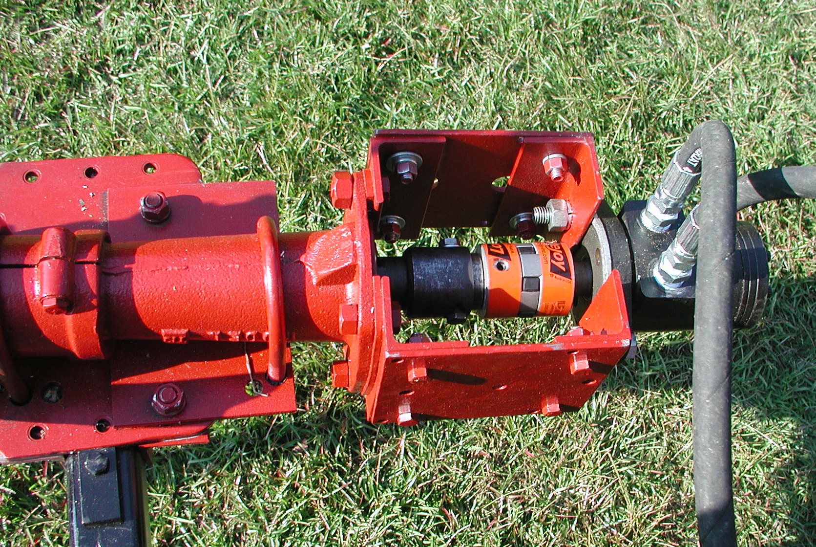

Here is my two cents. The Samurai is a good idea for 1/2 in. or smaller twigs, anything bigger would probably damage the knives. After looking at the Samurai, I built one by using a 4 ft Walk-behind Gravely sickle bar. It uses basically the same hydraulic HP. The Samurai is a nice little machine but little bit overpriced for my once or twice yearly use. Also, it will not cut stuff bigger than 1/2 in.
I am planning to make another attachment, with the same concept, using either a small lawnmower deck or a standard saw blade. I do know yet, I am still playing with the idea.
Here are pics of my attachment, the only difference is that now I install the bar to the bucket. It is a simpler move without dismounting the bucket.

That's inaccurate info on the Samurai. It cuts up to 1 1/2" NOT to 1/2". See the details on their website,Cutthat.com | Sabre Samurai
