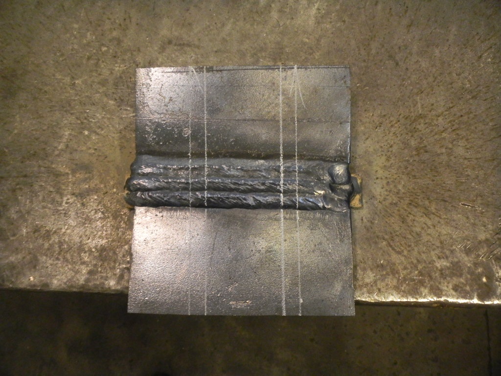

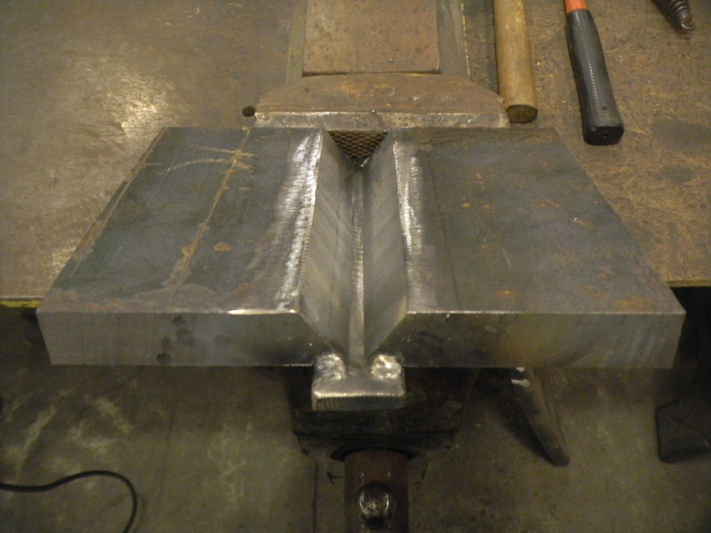

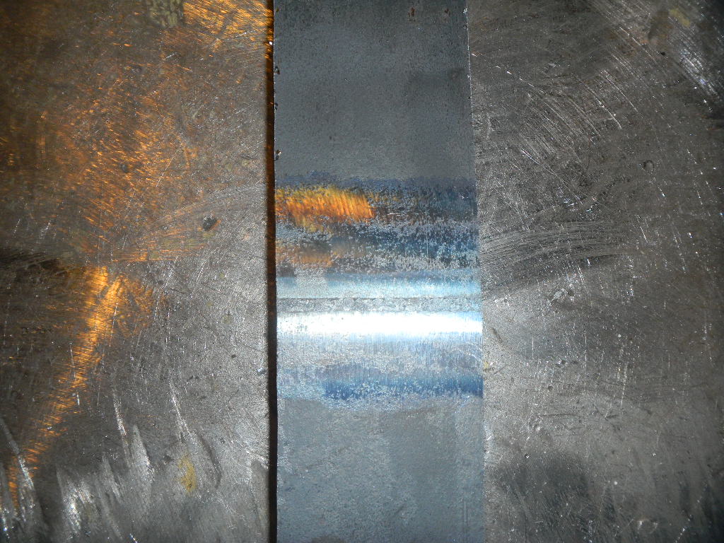

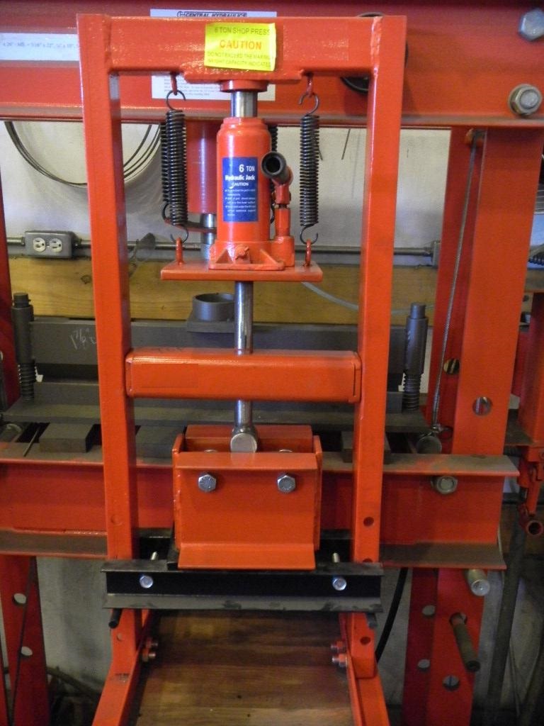

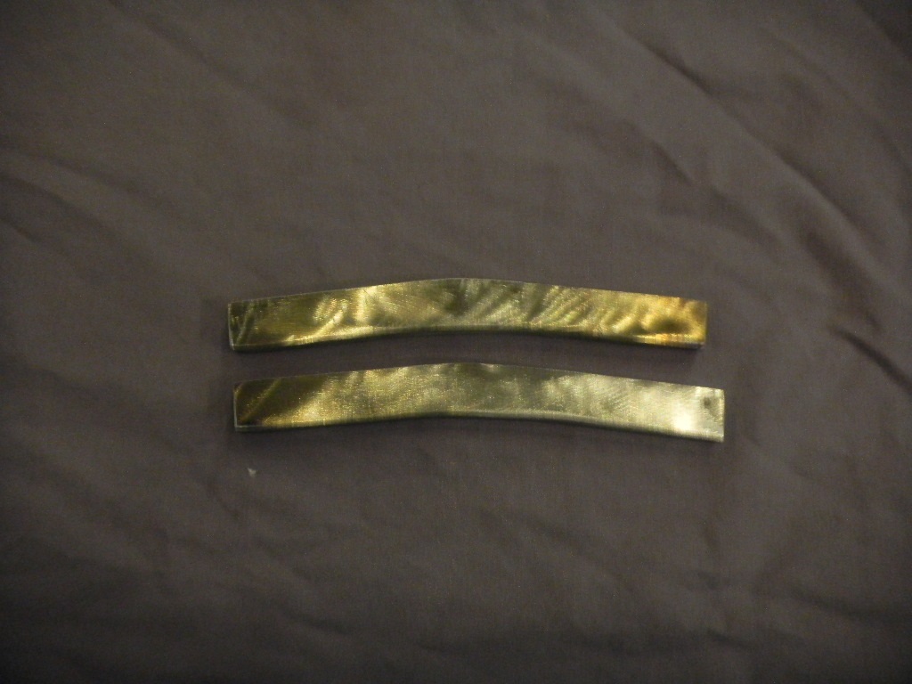

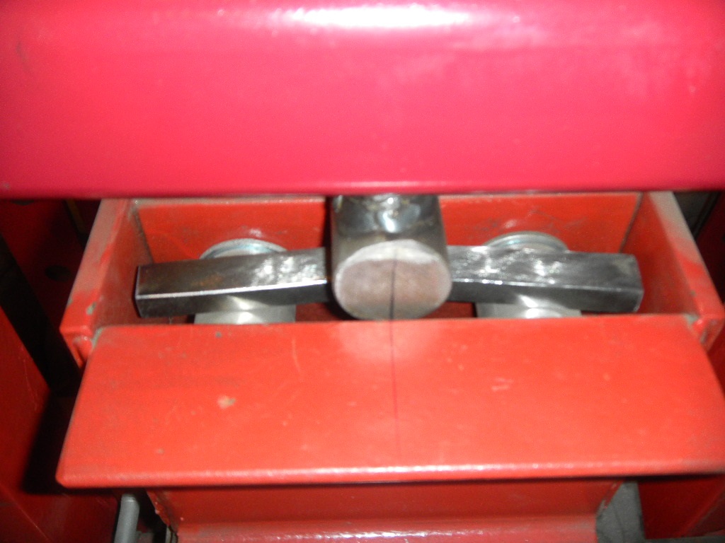

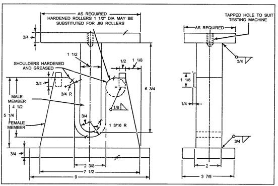

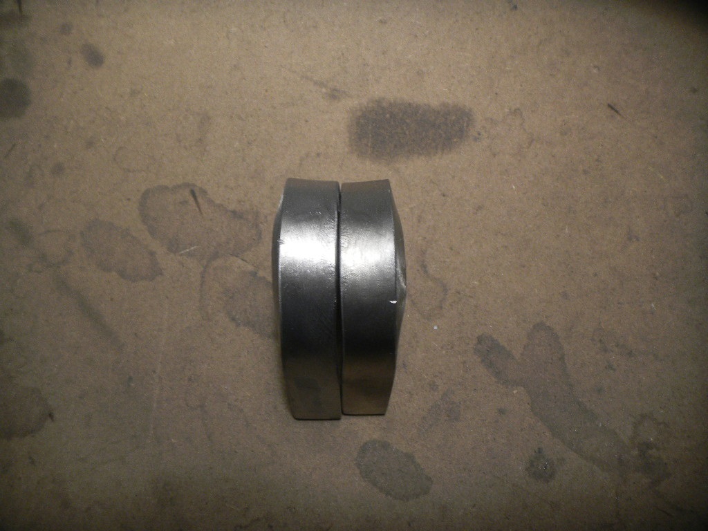

Eric when you get further along with your welding you can do some bend testing. It doesn't take much to build a bender. A 1-inch thick V-butt plate welded in the 2-G, 3-G, and 4-G positions. Then cut the coupons 3/8-inch thick and side bend them. This will tell you if you are ready to weld up something that some one's life will depend on. Without testing, you are just guessing!
This test plate was run with self-shielded flux core wire.
I intended to have a go at crudely testing some joints with a big hammer. You reminded me that I am storing a dismantled press for a friend. When there is some spare time I may put that together and do a proper test as you suggest, before he takes it away.

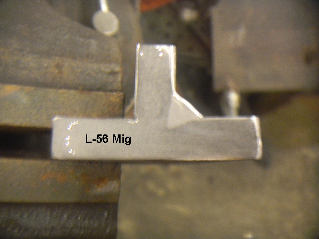

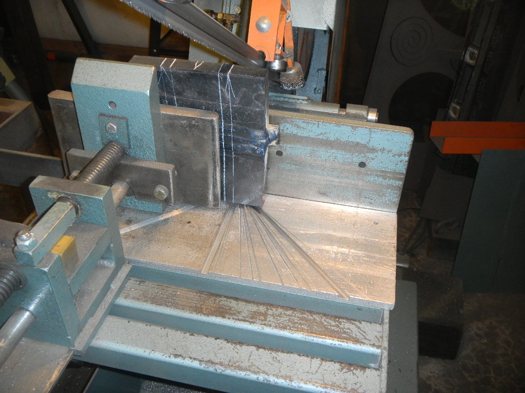

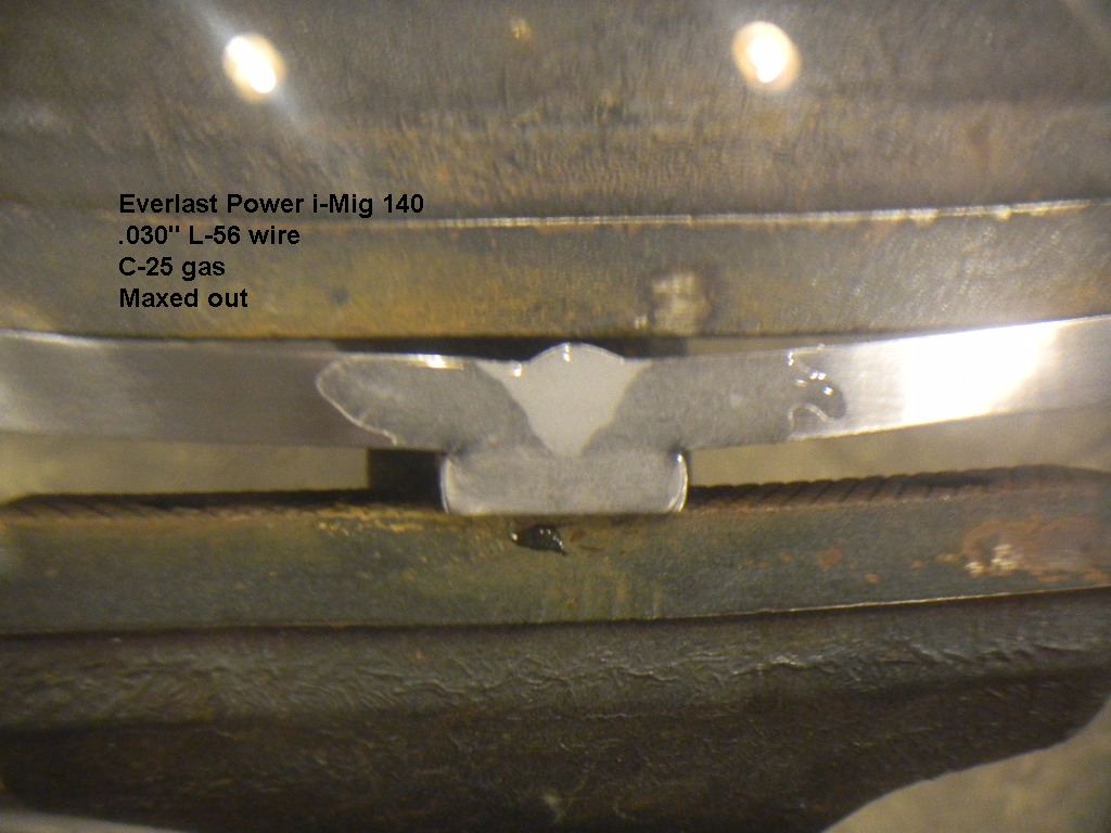

It happened to me when member here roadhunter had his 120-volt Mig welder sent to me. So I could do some testing with it. Some of the backing plate fell off when the test plate was in the saw being cut.
Like I said before, when it comes to Mig / wire feed welding there is no substitute for power! The last picture shows what a Mig welder with power can do.;)

Shows up real good in this test-plate pic. Down in the bottom of a 3/8" groove there can't much heat left with a 120v machine. Didn't this problem appear when welding 3/8" thick material with a 120v machine as an exhibition, a full 50% thicker than the machine's recommended capacity? That's an example but not good example because a newbie shouldn't be welding 50% thicker than the machine's rating. That's for experienced welders.
461995d1458729324-i-wish-i-could-weld-everlast-2-jpg
If a newbie welder were to keep within the recommended capacity of the machine (3/16 - 1/4").......is "a pretty MIG weld that falls apart" a genuine concern that needs to be taught to the newbies (and oldies)? If it's genuine, someone should be able to replicate it, or show the forum an example.
Which amounts to be showing what NOT to do. Thats what this forum needs more than just writing about pretty welds failing. Can anybody show a pretty weld that failed (in real life)? STx do you have a pic of that pretty weld you pulled apart with your hands?
