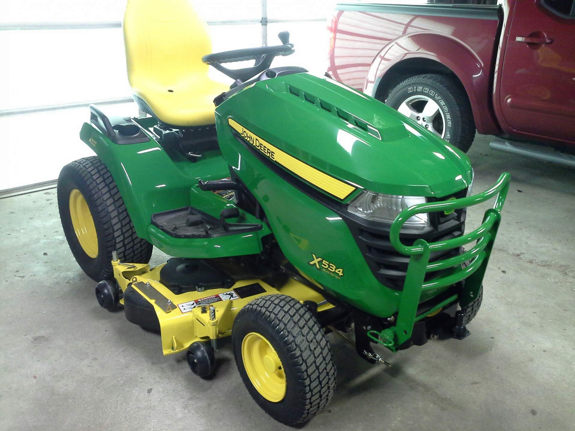

Well peeps, I am going to use a good synthetic oil,(Mobil1) I am going to use the John Deere oil filter, I am going to change my oil every 20 hours, I will put about 125ish hours on the mower in 4 years, then, the warranty will be over, then, I will trade for another new one.Ha,Ha,Ha,Ha.
And, I will sleep like a baby every night.LOLOL
