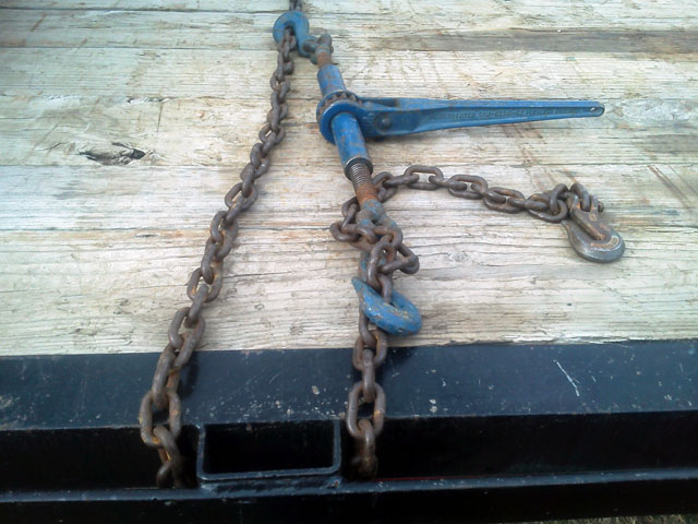

I suck at using rachet chain binders...help

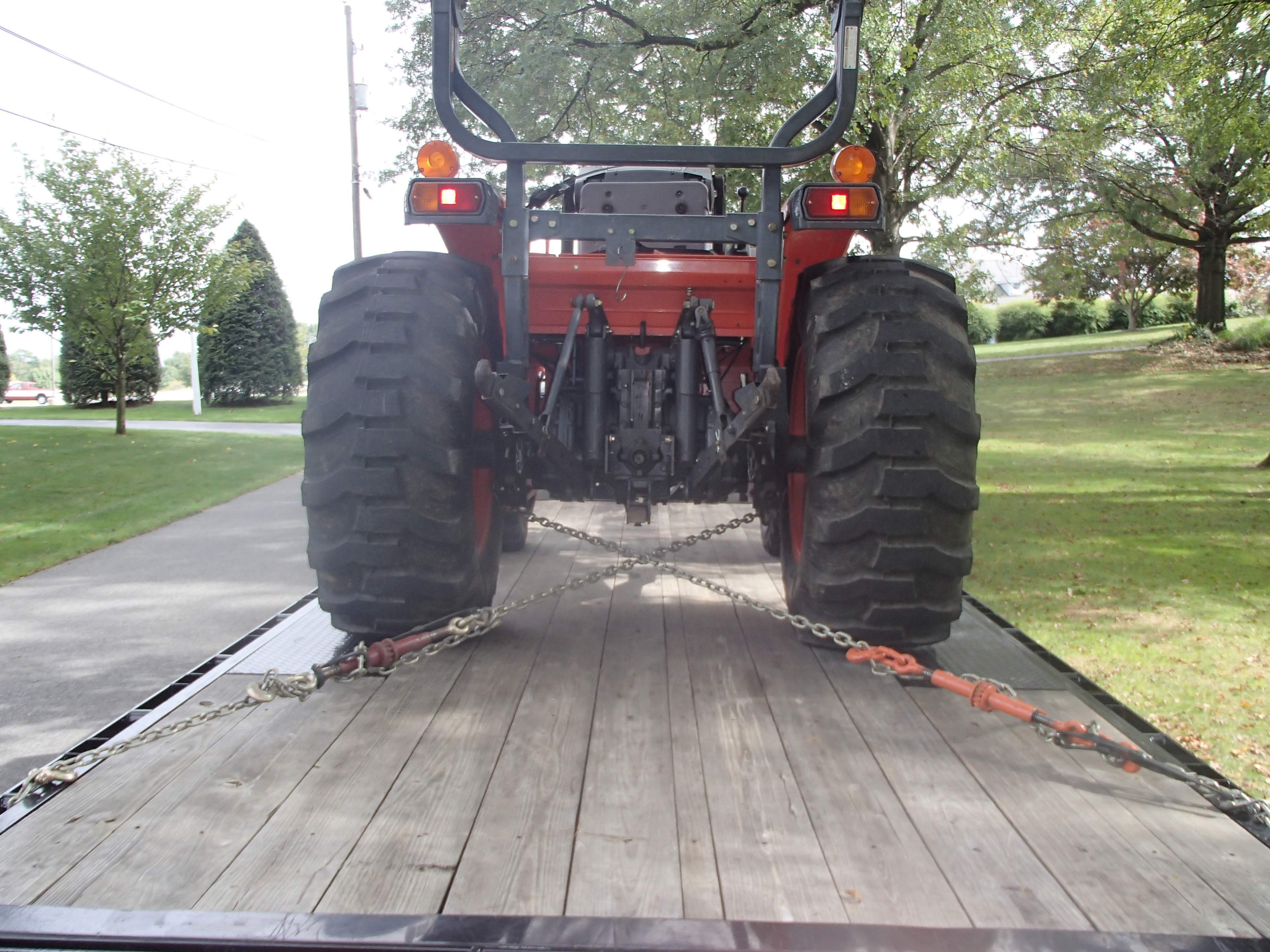

One way you can save a lot of trouble and effort is to chain up the front end as snug as you can without binders and then back up 'till nice and tight and apply the parking brakes.(like squish the front tires)
You then only need to manually tighten the rear end.
That way you have only one binder to bother with.

Make sure the binder is extended as far as it can go and then you pull the chain as tight as you can by hand taking out any slack and then hook the binder to the tightest link you can reach. I use ratchet binders all the time and never have problems. Are you wrapping the the chains around things? Chain doesn't like to slide too well when wrapped around things. Hook it to an anchor point on each end and then tighten.
/ I suck at using rachet chain binders...help #23
I will take a ratchet (screw type) binder over lever type any time. The trick is, as stated already, getting as much slack out as possible first, and having the binder as open as possible and still have 2 or 3 threads catching.
If you use lever binders, intentionally twisting the chain can shorten it just enough when you find one link you hook to, too tight, and the next too loose. Again, only after getting all the slack out.
Looking at the OP's pics, it looks like he's not hooking the chain at both ends, then using the binders to tighten the chain up. This is the way I use my ratchet binders and I've never had any problems.

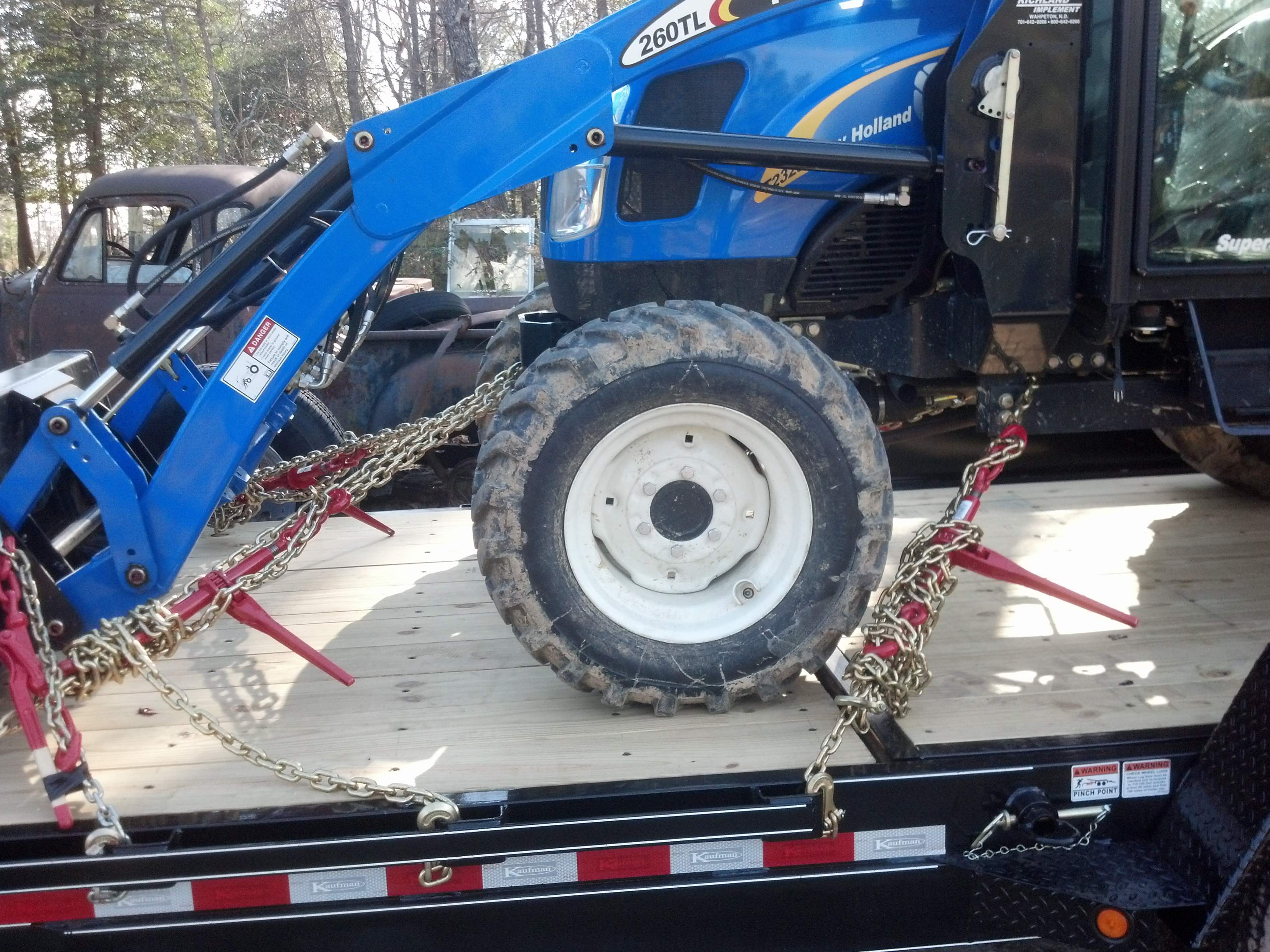

I vote for the ratchet binders. Never had a load come loose with them, and never got smacked in the face with a cheater pipe. I watched a pipe sail over the trailer when I was younger and that was enough to convince me I didn't want to mess with them. Its incredible the amount of tension you can safely put in a chain with a ratchet without risking your skin. If something shifts a little bit when you check your chains like your supposed to, it takes a second to put another turn on the buckle. I like hooking the chain down around the outside of the pocket and then coming up inside it. If I'm cheating, I'll use a single chain attached to two solid points and take a binder off of each side to a pocket. Never had an issue doing it that way. I really don't like dragging chain over a piece of equipment to tie it down. Looping the chain around a hard point and hooking it ensures there is no hidden slack.
Anything with tracks, a ratchet binder is hard to beat, grab a grouser and a stake pocket and tighten it down. In all reality, if your using the correct number of and rated tie downs, you shouldn't have an issue.

I put mine on the front similar to Sterff, but I hook to a shackle I put in the draw bar last hole on the rear. But I do it like Piloon suggested and hook chains on the front to the stake pockets, then back up to tension, and only use 2 load binders on the rear from draw bar to D rings at back corners. Ratchet type. Never had a problem, and I like the control and ability to tighten a bit more if you are going a long way and stop to check. Never tried a lever style, as they scare the bejeesus out of me... Someone could argue the use of one rear tie down point is a weakness, but again, this is not a 40 ton crawler here...

#37
well i used the solid point on the trailer and i was finally able to get the chain tight, so tight infact i was squatting the tire and sliding the tractor over to the side.
Thanks all.
