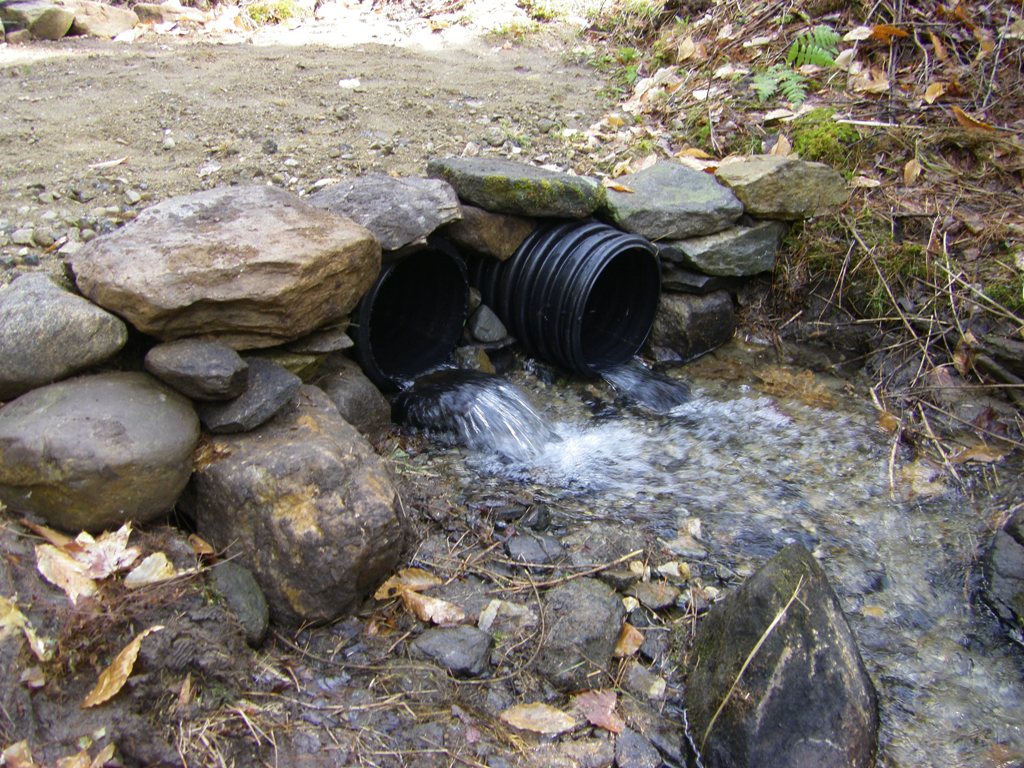

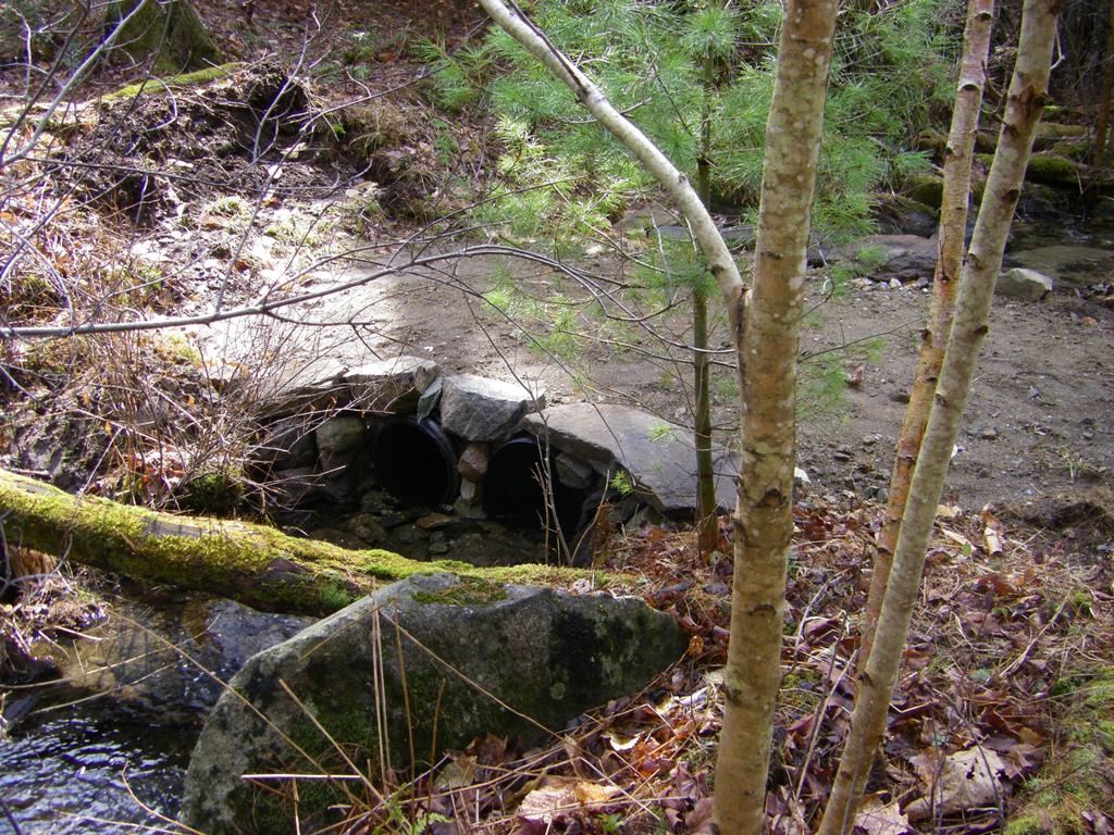

/ I need advice on building a small bridge #15
This was my somewhat simplified solution. It cost about $160.
