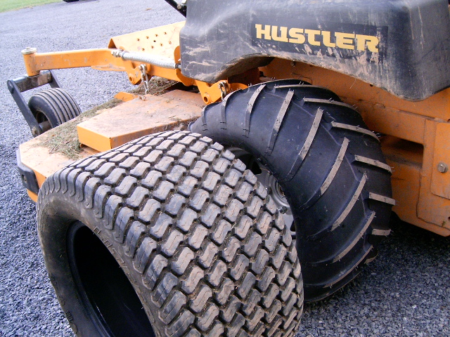

I had the same issues with my zero turns on hills with the stock turf tires
I put Carlisle AT 101 bar tires on my zero turns and those issues went away

Same problem here, i.e. no traction on hills. Do the bar type tires tear up the lawn pretty bad?

They can tear the grass up a little if your not careful. Not enough to concern me. Our grass seems to grow right back
Sure beats not being able to mow our hill or sliding off it out of control like I used to deal every time I mowed using the stock crappy turf tires

My Hustler Super Z, 72" weighs 1600lbs. (the mower in my earlier picture)
The stock turfs sucked on our hills. The bar tires made a massive difference
My other Z turn is a Snapper Pro s200xt 72" . Weighs 1450lbs.
I replaced the stock turf tires with Carlisle at 101's almost immediately after I got it. The stock tires absolutely sucked on our hills.
