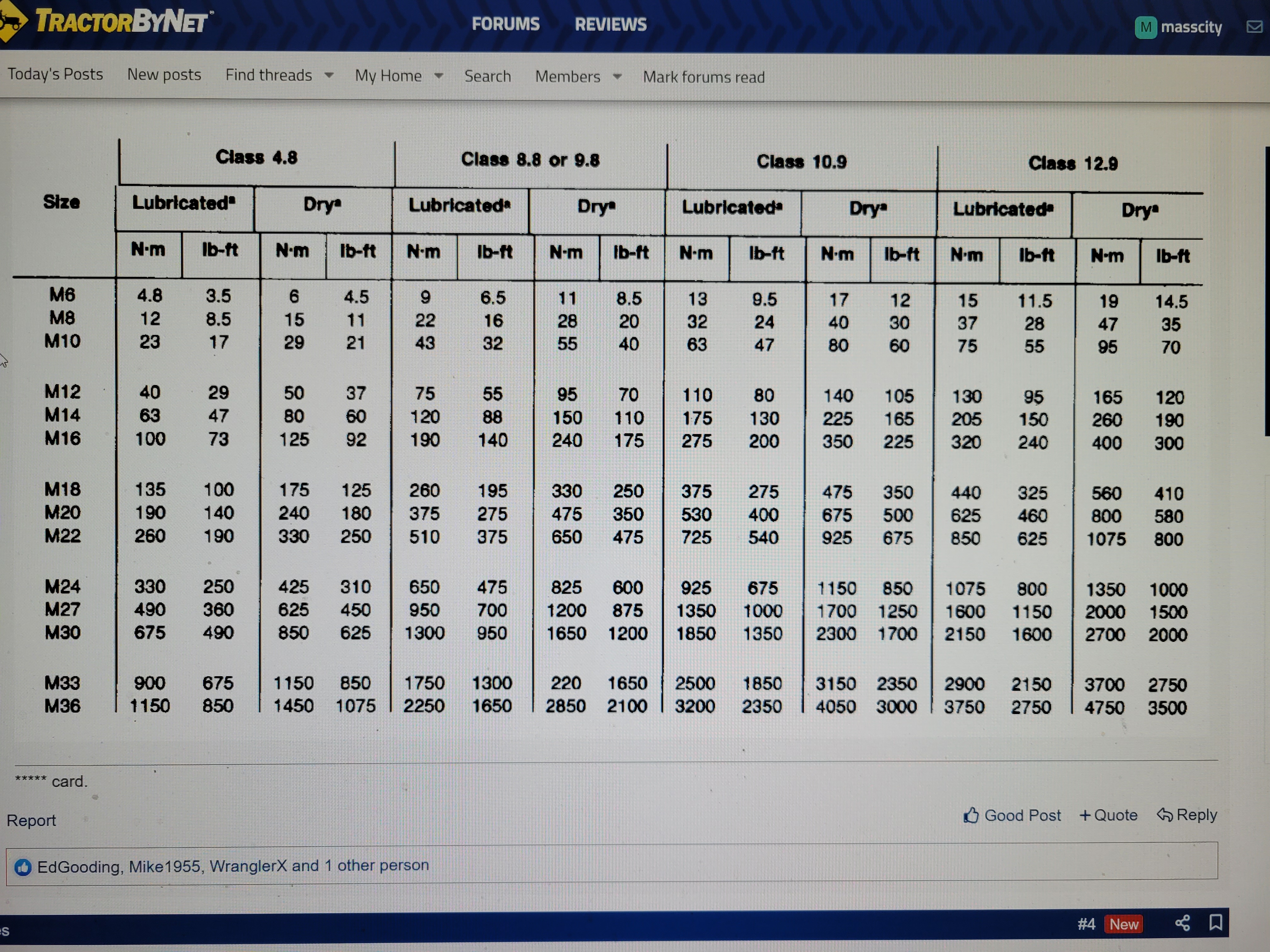

Probably correct in as much as I own a torque master and every time I check them, they are always close to spec. Problem that most people don't quite understand is, if you put an extension on a torque wrench or you don't apply it at 90 degrees to the fastener you are torquing, the value of the torque applied changes. Then there is the wet thread versus dry thread issue as well.
Depends I guess but there is also (other than mechanical torque multiplier) as torque wrench extension.... Are we talking a bar or socket extension...

Actually if you do a real research torque wrench "calibration" is sort of myth as most are within reasonable limits to be accurate enough for just about everything but space agency devices.... Was a few good youtube videos a while back showing several different wrenches in differing conditions and error factor was almost negable....
I'd be interested in seeing that, as I worked in an industry where our wrenches had to be re-calibrated every year, and many were found to require re-adjustment. I have also personally taken brand new torque wrenches purchased without NIST certs out of the box, tested them myself, and found them off by as much as 20%.
As someone posted previously, the beam type is always accurate, if not damaged, and a good method for checking your clickers. But clickers tend to be all over the place, depending on how they're handled and who calibrated them at the factory.

If that is so why do torque multipliers state in instruction how to apply torque (with a torque wrench) above and beyond the rated value of a torquench to tighten nuts and bolts....?
Like 5030 said, very few people read the instructions!! I haven't!!
I do understand the mechanics of a Torque Multiplier, and it would increase the torque going to the nut or bolt. That number can be calculated, but I wouldn't trust it.
