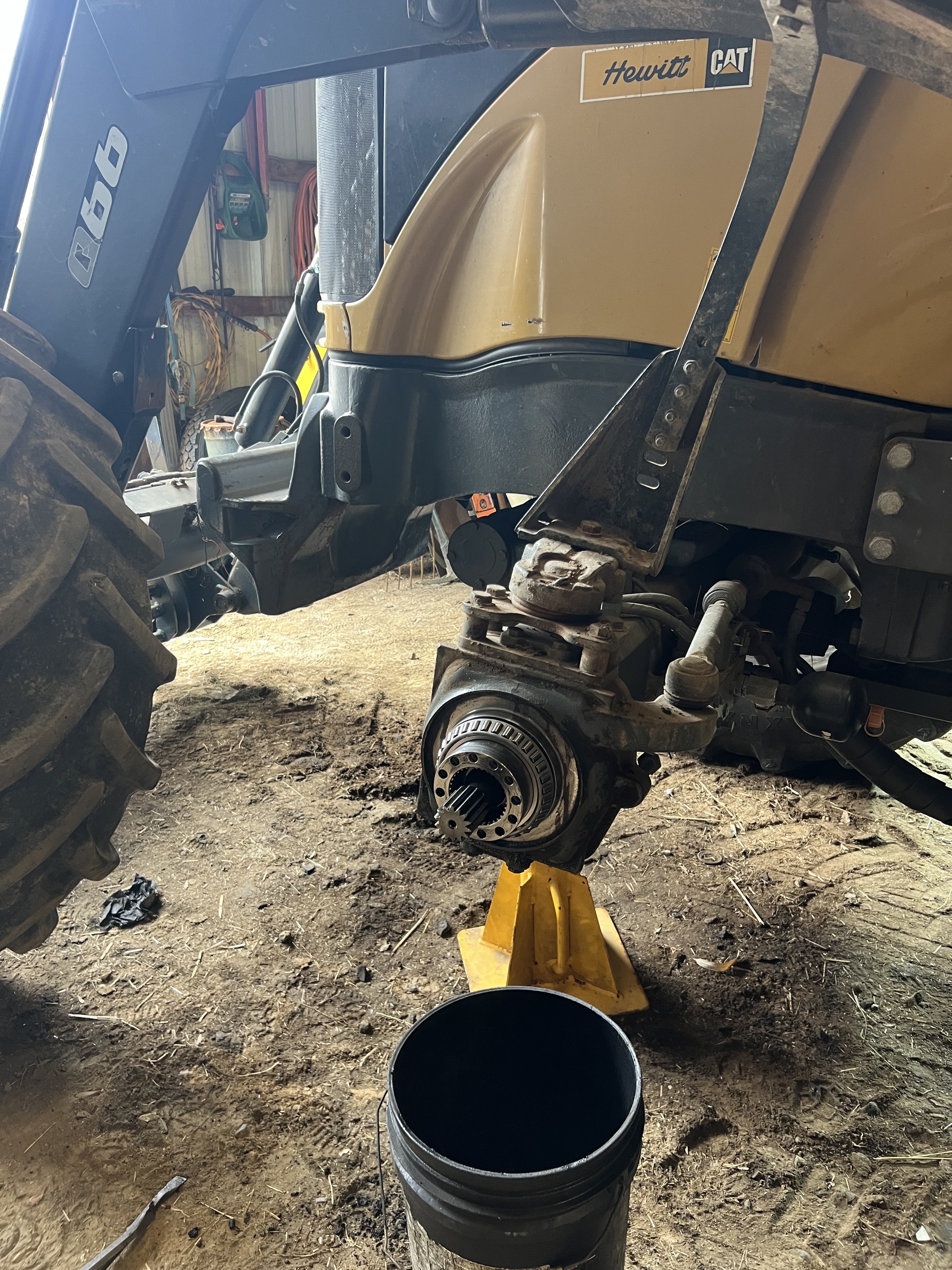

I keep breaking 1/2 ratchets on my lug nuts.

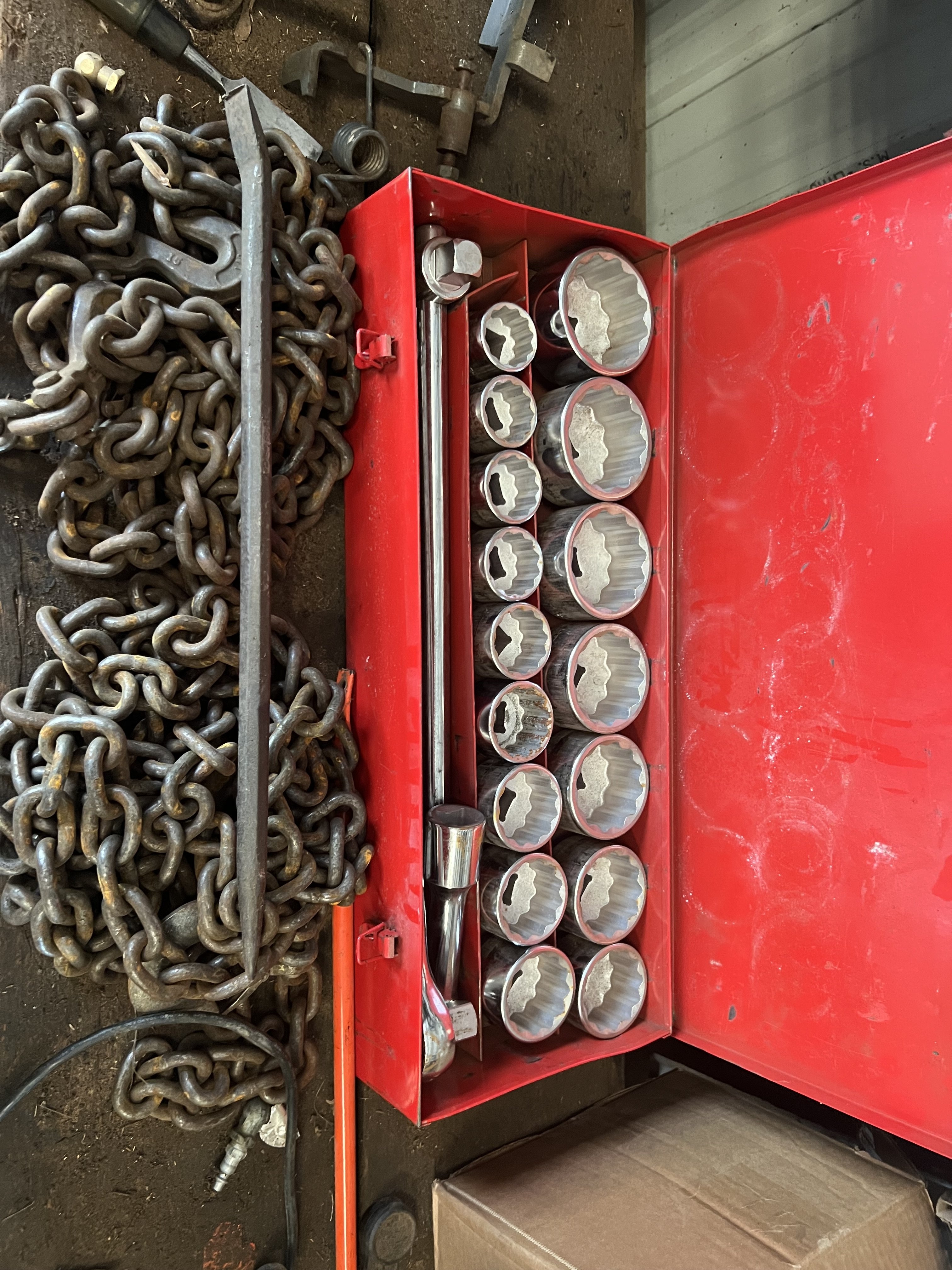

A half inch ratchet in not the right tool. Go with a 3/4" socket set or impact.
I suspect you used a cheater bar.
Absolutely. A proper 3/4 setup is a whole different ball game. Kind of like with a tractor you're better off having the right tool for the job. If you're looking to plow 600 acres worth of fields then you're 55 HP tractor isn't as ideal as a 400 HP tractor, but if you're looking to maintain your pond, then the 55 HP tractor is going to be more ideal. You're not going to buy a .22 LR to hunt whitetail, but you might if you want to kill some tree rats.
If you want to go with a pneumatic setup, and don't want to pend big bucks on a badarse compressor setup that gives you a lot volume, and at a lot of pressure to bring out the potential of a good 3/4 pneumatic impact:
-Get an extra trank.
-Use at least 1/2 hose.
-Keep the hose short. (4' is often recommended)
-Attach the hose directly to the tank with no regulators, or couplers.
-Use high flow fittings for your tools and a quality coupler on the other end of your hose. (3/8, not 1/4, which most 3/4 impacts and 1/2 hose will be setup for 3/8 fittings anyway)
-Charge the tank to 125-150 PSI if your compressor will get you there.
This should give you a lot of reverse torque, but in short bursts. Then you will have to recharge the tank. Or you can invest in a industrial type compressor setup. Or you could go electric. I don't have a large electric impact, but I'm sure they're out there, and are strong.
   / I keep breaking 1/2 ratchets on my lug nuts. #122
everything above 1) buy a 3/4" Breaker Bar, middle to good quality not Harbor Freight junk, 2)get a good quality 1/2-3/4 adapter Impact grade.
Better yet buy narrow wall 3/4", 13/16" and 7/8" deep 3/4" drive sockets. 3) also use anti-seize or moly grease on studs and seat area around the hub. (coating threads of your wheel studs are a must do if wheels are exposed to weather/ mud/dirt/ salt) 4) torque your wheels to spec with a torque wrench everytime ! and re-check a few hours or 60 miles later if a road going vehicle.
and lastly don't use 6 foot cheater bars on ratchets, it gets expensive after a while lol :p

Maybe time for a new wheel. Not sure why you are having to deal with lug nuts so often? I did have that same issue and actually nearly lost a wheel. From having gotten loose, the holes in my wheel wallowed out and no amount of tightening would keep them from loosening. ( the shoulders on the nut had little to grip against.) I got a used wheel from a tractor junk yard. A little paint and replacing the wheel and no lug nut problems for two years now.
