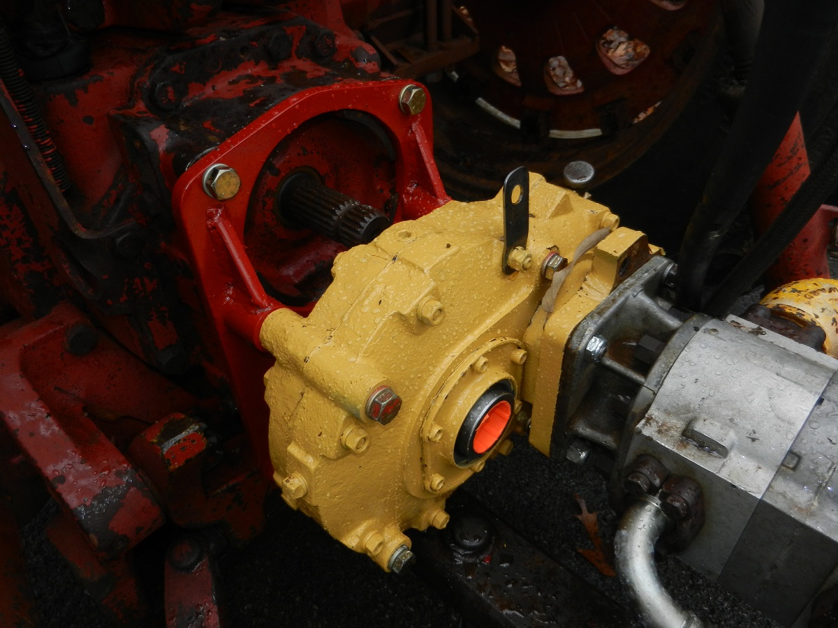

I don't know if I'm spoiled or screwed.
I don't have the collar to pull back....I don't have the pushbutton. My mower is hydraulic so it bolts on. Support bracket bolts around PTO assembly. Speed increaser bolts to support bracket. Hydraulic pump bolts to speed increaser....and done. The bad news is the speed increaser and hydraulic pump (with attached fluid hoses) gets to be a bit heavy and awkward to move about.

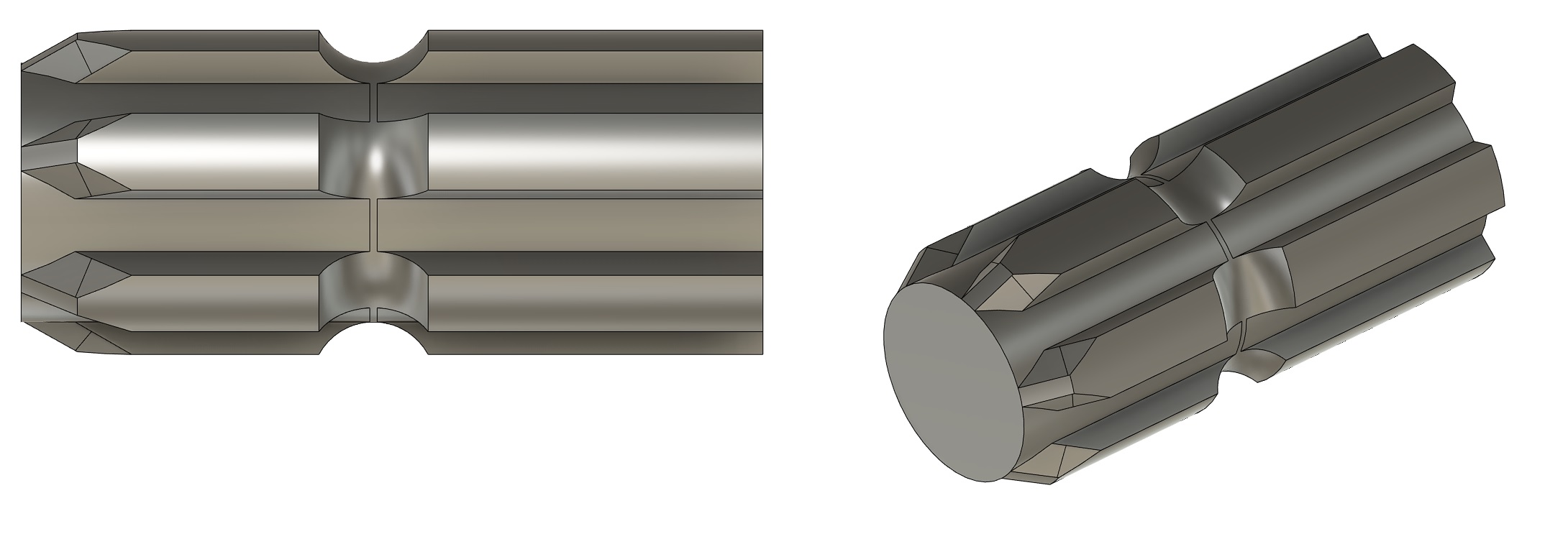

With today's modern machining and processing capabilities, I still can't quite figure out why tractor manufacturers won't just simply bevel each spline on the PTO shaft to help hook the PTO shaft. Pretty much what JD uses on their Auto connect decks.
Made a quick 3D drawing. Hopefully what I'm trying to say comes through. While I don't really have any problems connecting the PTO shaft, I can understand that for some can be tricky. Specially with so much in the way.
Actually a bit of careful grinding with an angle grinder would give an adequate bevel too.
