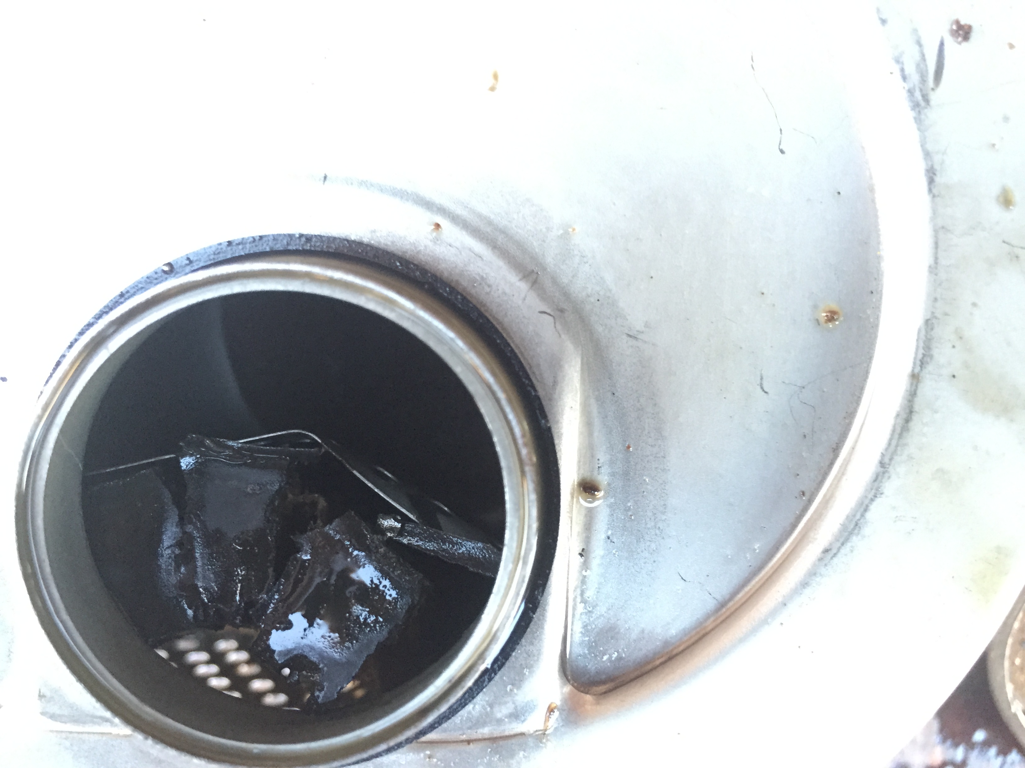

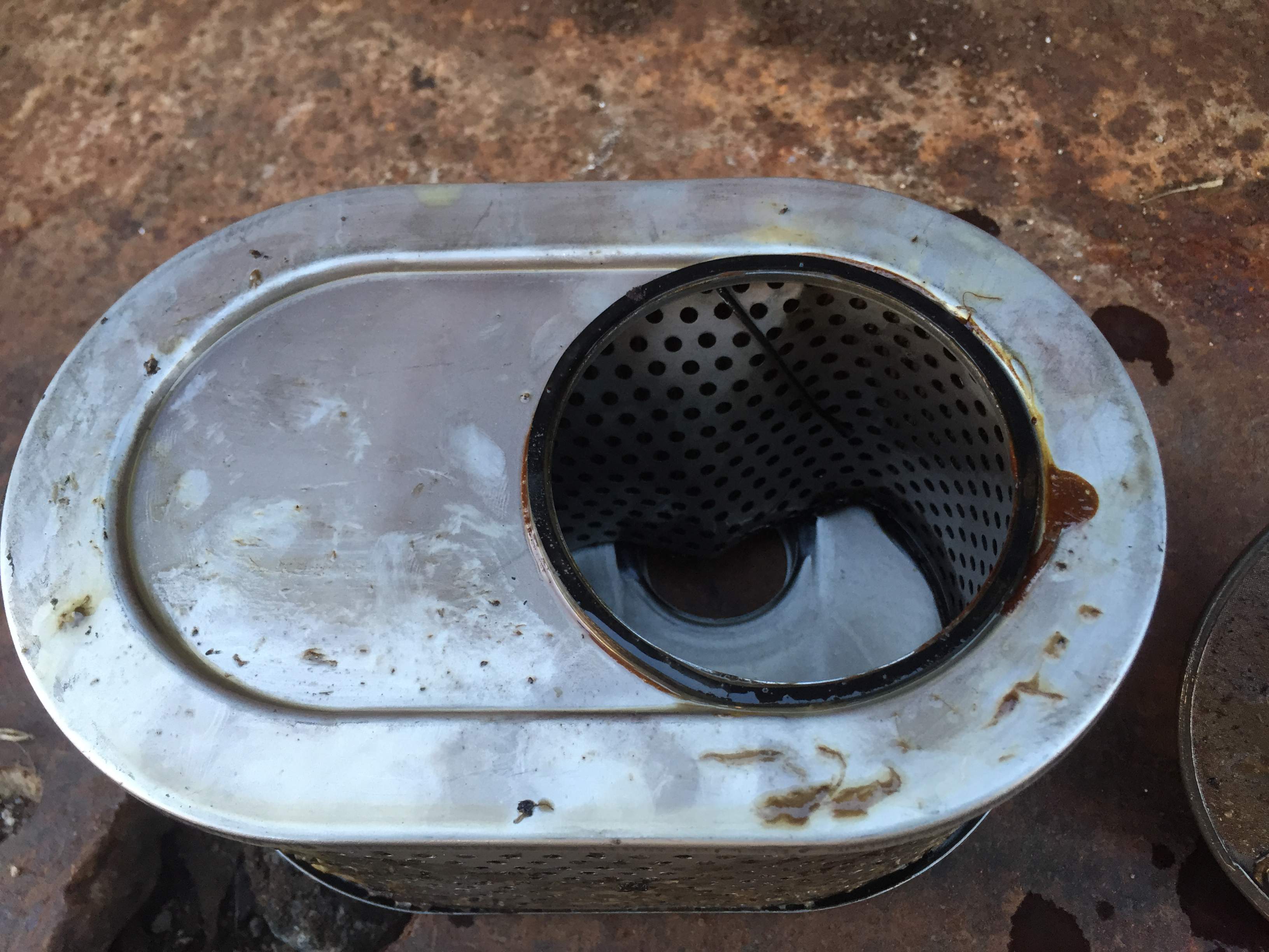

Let's see, hydraulic fluid. Dear God. this was the worst fluid ever. Seemed like it had a ton of water and dirt in it. Can't really figure out how either got in there, but I do know the filters were not changed anytime recently. The suction filter down on the transmission had imploded and been sucked into pieces it was so plugged up.
These are pics of the suction filter. If you look real close in the second one, you can see how it imploded-basically at that point there was no filter.
This is what the fluid looked like in the bucket. Yuck!

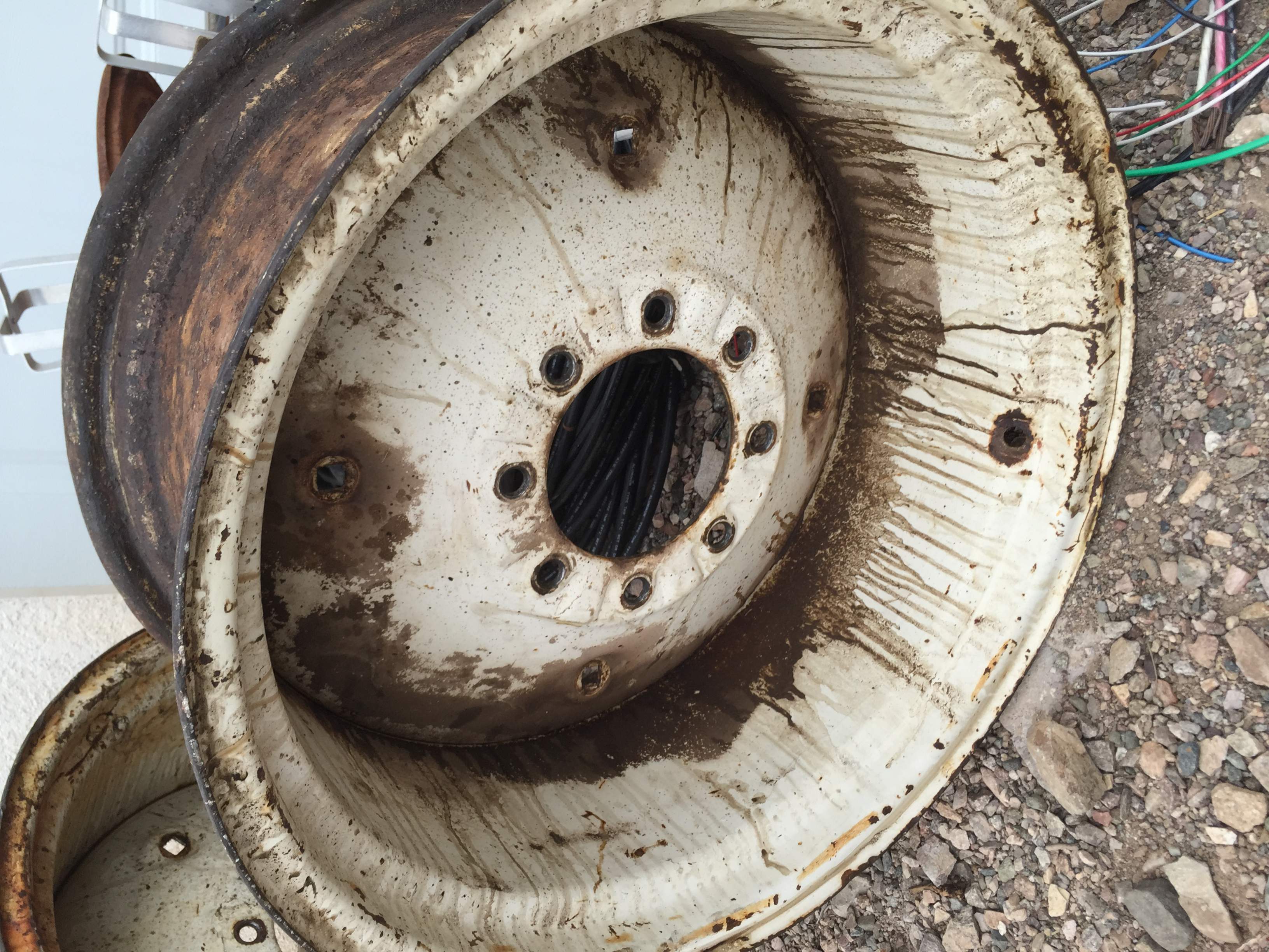

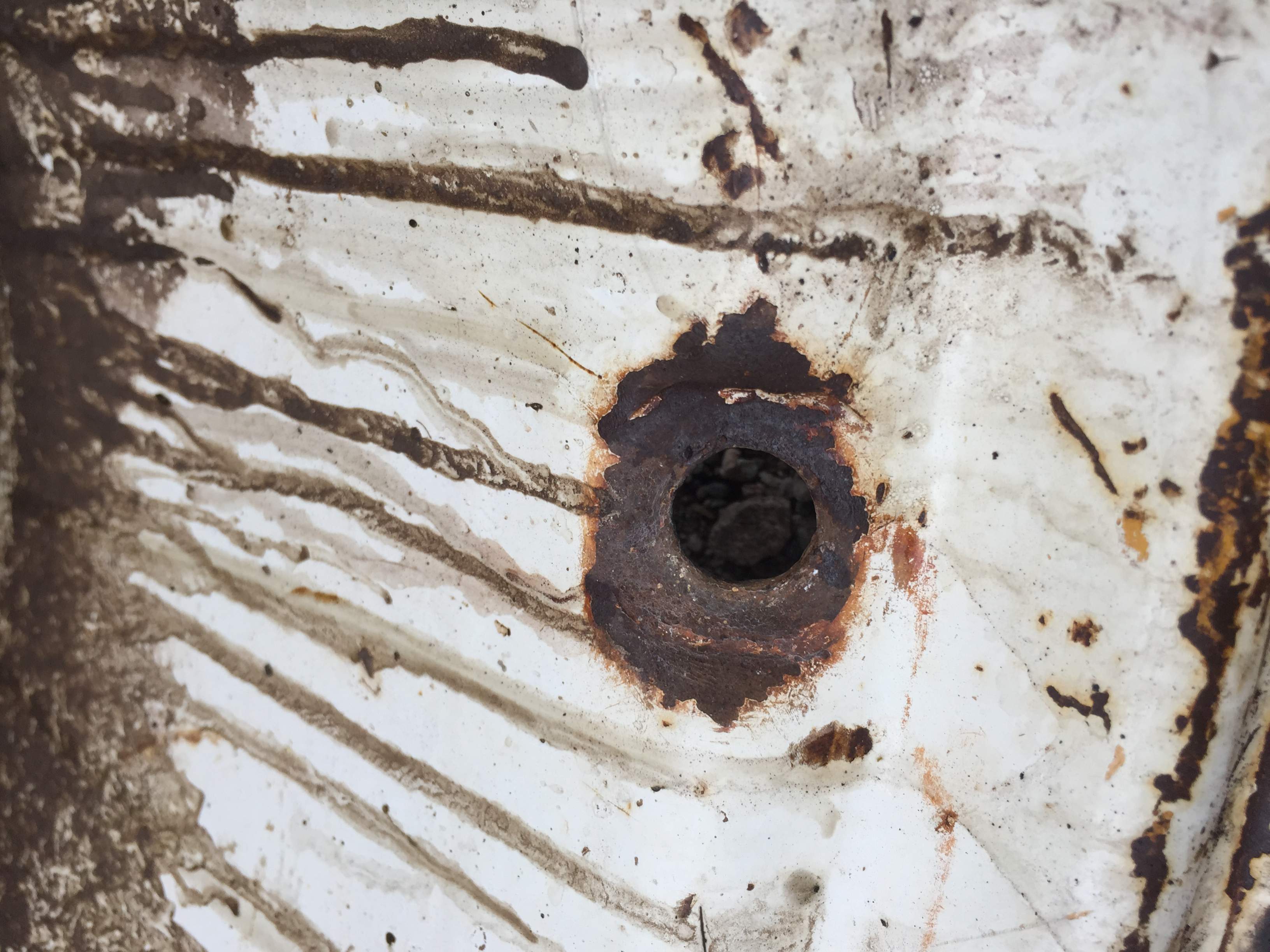

Here is what the poor rims looked like-
A few hours with a hammer, dolly, and a torch for the bigger dents had the rims looking round again, the bead surfaces acceptable, and looking a bit better overall.
As you can see, the valve stem holes were wasted. Well, I couldn't have THAT! I also wanted to run tubeless tires so that if I got a flat, a simple plug kit would save the day-instaed of an expensive trip to the tire store-which is 50 miles away from where this tractor will eventually reside. Seeing as the rims were welded type, this was a good idea-but first to fix those holes.
Here's what I did-
I had my CNC plasma cutter make me a few square parts with round holes in the middle out of .120 cold roll sheet. Then I carbide reamed the holes to .625". Then I used a hand held plasma cutter to cut out a square with the old worn out hole. A little cleaning up of the cut-out, and then I just welded in the patch piece. Welded it on both sides, the ground down the out side. Good as new!
But I didn't stop there-
I welded on a short piece of 1 1/2" pipe, with a matching female cap (removed in this photo) to protect the valve stem, and act as a secondary seal should the valve stem leak. I really like how it came out.
And here is one with a spankin new tire on it. I sure love the smell of new tires!! These are the biggest shoes I have ever bought!
In case you can't tell, I had the rims powdercoated before the new rubber went on them. This actually created a problem-the new tires and rims look SOOOOO nice, and the rest of the tractor looks sooo hammered. HHMMMMMMM...
