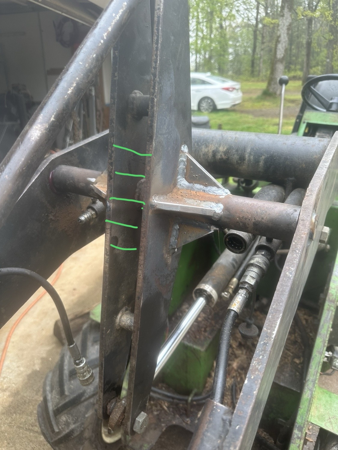

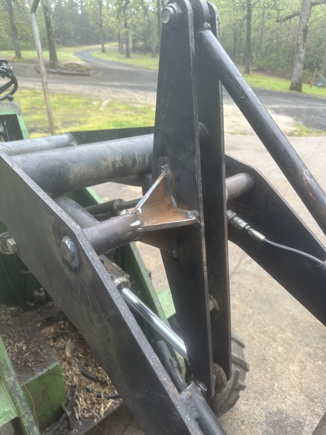

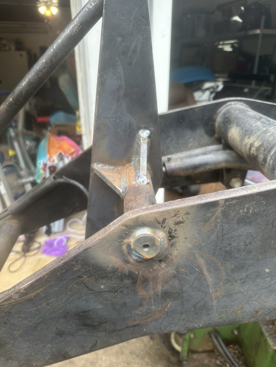

The wheel motors are in fabricated "boxes" on the low profile machines I have seen. Fabricate new extended motor boxes to move the wheels wider apart without any additional stress. Fill the tires with ballast to lower center of gravity.
I think the Z-bar repair looks good if no impact shock in the future.

Metal reinforcement at the center should help resist future breaks since there may be some metal fatigue after the previous break.

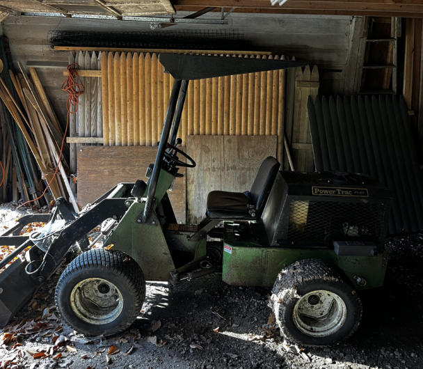

I recall (I think) former PT owner JDbeach (sp) had a 425 that he wanted to use on beach sand. He needed larger tires to float over the sand. Larger tires would effectively gear down the unit and make it weak at slow speeds. He and PowerTrac made an arrangement for them to put larger displacement wheel motors on the unit. That effectively geared it back up again. (I think they were from a 1430). The larger motors took a different mount. I think a BOX was welded to the outside of the unit to mount each motor.
Also, I recall another member putting larger displacement motors on a 425. He got the mounting boxes from PT, I think. It effectively cut the top speed down quite a bit, but made it a mountain goat.
That brings me to the following:
I feel horrible. As I recall, that member passed away. He was a great resource and I think he also had a Simplicity tractor website. I cannot remember his username....
Found it. kentT
RIP Kent Thomas!
Here's a link to some of his videos on Youtube.
This one mentions the larger wheel motors:
2001 PT-425 with Kohler CH25 engine running 48" brush cutter. Wheel motors upgraded from 12.5ci to 22.7ci to increase torque. Wheels reversed and loaded with winter-mix windshield washer fluid and HydroSeal sealant to add stability
You can clearly see it's now wider stance with wheel boxes.
