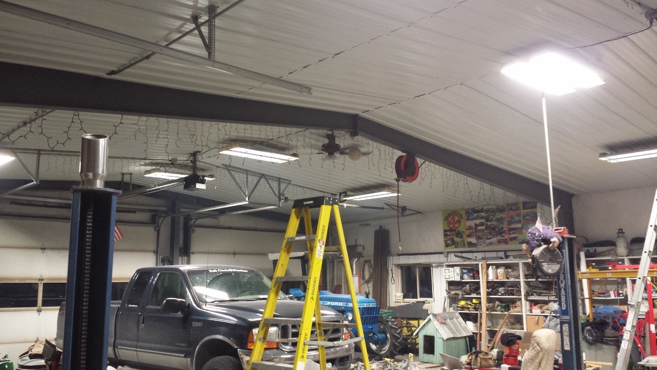

Yep, my shop is all metal. I-beam frame. Center beam is clearspan 42'. Vertical wall beam is smaller at the floor. But roof beam is larger where it fastens to vertical beam and smaller out in the center of the building where they bolt together.
Thats just the opposite of how most of them I see are. But given the pitch of the roof, about the only way that center connection at the ridge can fail is if it pushes the wall out. Most of the ones that I have seen are flat or near flat roofs. And the beams always seem to have a deeper section in the middle of the span, where it is needed for the deflection.
But steel aside, look at any type of wood truss. The "deepest" section is the middle. The end supports where it sits atop the wall, not so much. Only have to be strong enough to overcome the shear.
