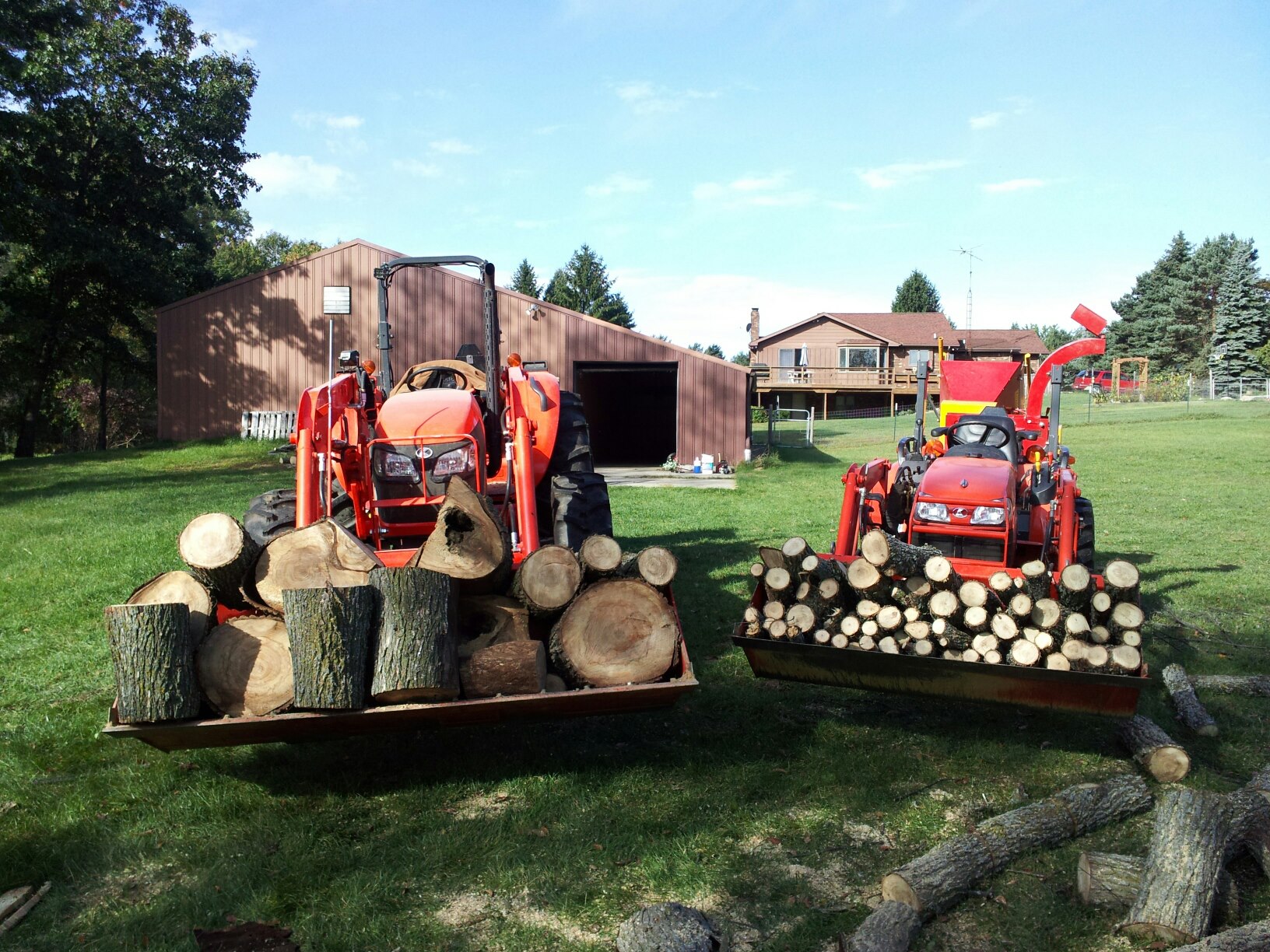

I know another guy who lives about 5 miles away with 17 acres see picture below who has a b3030 right at the 30 hp mark he likes it but really wanted a bigger tractor but a used 3030 was all he could afford at the time. for about 90% of what does your right its perfect he still some occasions times where he could use more tractor in terms of both loader, hp , and ground clearance.
If i could find a used 3320 or L3240 with less than 600 hours for about the same price as a new B series 2920 or 2720 i would opt for the larger tractor
