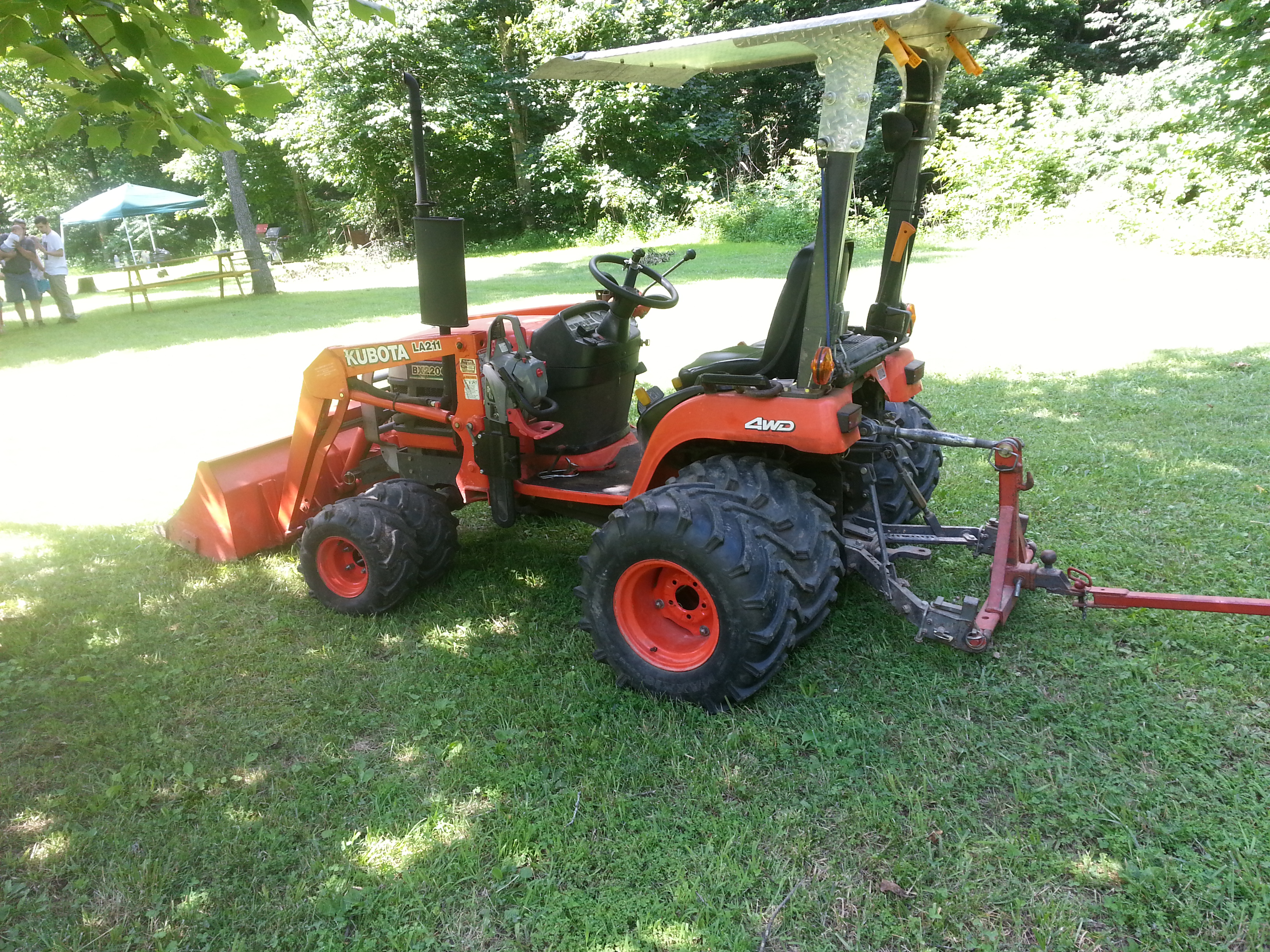

This works well for me on the hillsides, but not big enough to lift what you need to lift. 20130629_160809.jpg
