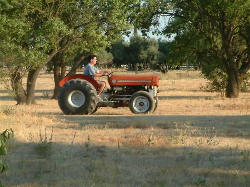

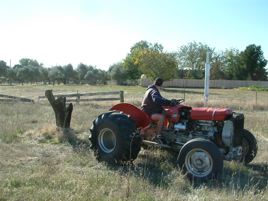

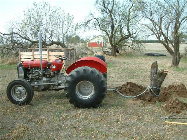

Since you're looking for a used tractor for orchard use, here's my 1964 MF-135 diesel tractor that the previous owner had modified to work in his olive orchard. He replaced the usual tall rear wheels with wide wheels 18" diameter tread on 16" diameter rims and shortened the front axle spindles to keep the tractor level. Wheels this size are typically found on larger ag equipment like combines and bank out trucks. Those trees in the background in the first two photos are the remnants of an old almond orchard on my place.
What's nice about the 135 is that it's a straddle tractor. The transmission is between your legs so you're center of gravity is lower than that in a platform tractor where your boots are on the floor that's attached to the top of the transmission. Most modern tractors are platform tractors.
There are plenty of 135s around for less that $3K that can be easily modified for working safely on your hillsides. Almost any tractor can be modified for low center of gravity. My Mahindra dealer has modified some of his smaller CUTs in the 30-40 hp range to work in orchards.
Good luck
