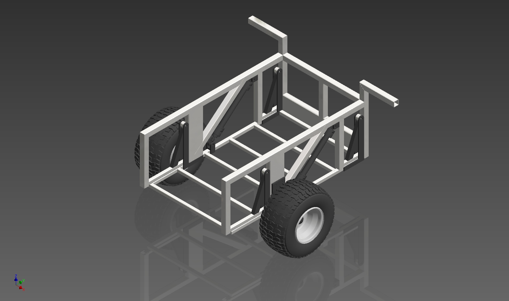

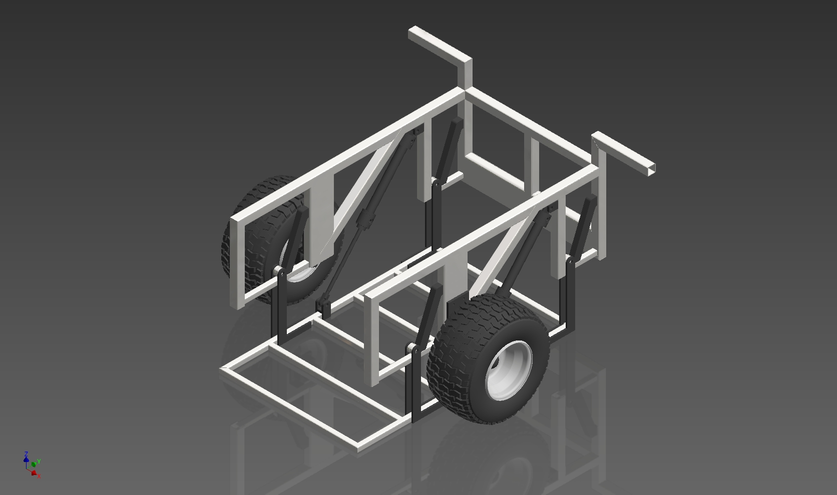

I am starting the frame and am wondering if 1/8 wall 2x2 square tubing is thick enough or even to thick. What are your thoughts on that.
/ Hydrostatic ATV #125
Did you run Inventor's stress analysis routines? I'm not skilled enough with the software to know how to work that part of the program yet.
Gut feeling is that 1/8" thick is the bare minimum, and 3/16" the maximum. Though I think 3/16" would be overkill. Mind you that's a guess.
/ Hydrostatic ATV #126
The area around the articulation joint and those parts I would do out of 3/16" wall . There is going to be a tremendous amount of force from different angles that the structure needs to deal with.
The rest of the structure I would use 1/8" and double up in areas of higher stress.
/ Hydrostatic ATV
#127
Yes I have played around with the stress analysis but not that confident with it.
I planned on making the joint area heavier than the rest. Your right that it will need to be strong. If that fails I'm screwed. It defiantly the most important part of the machine.

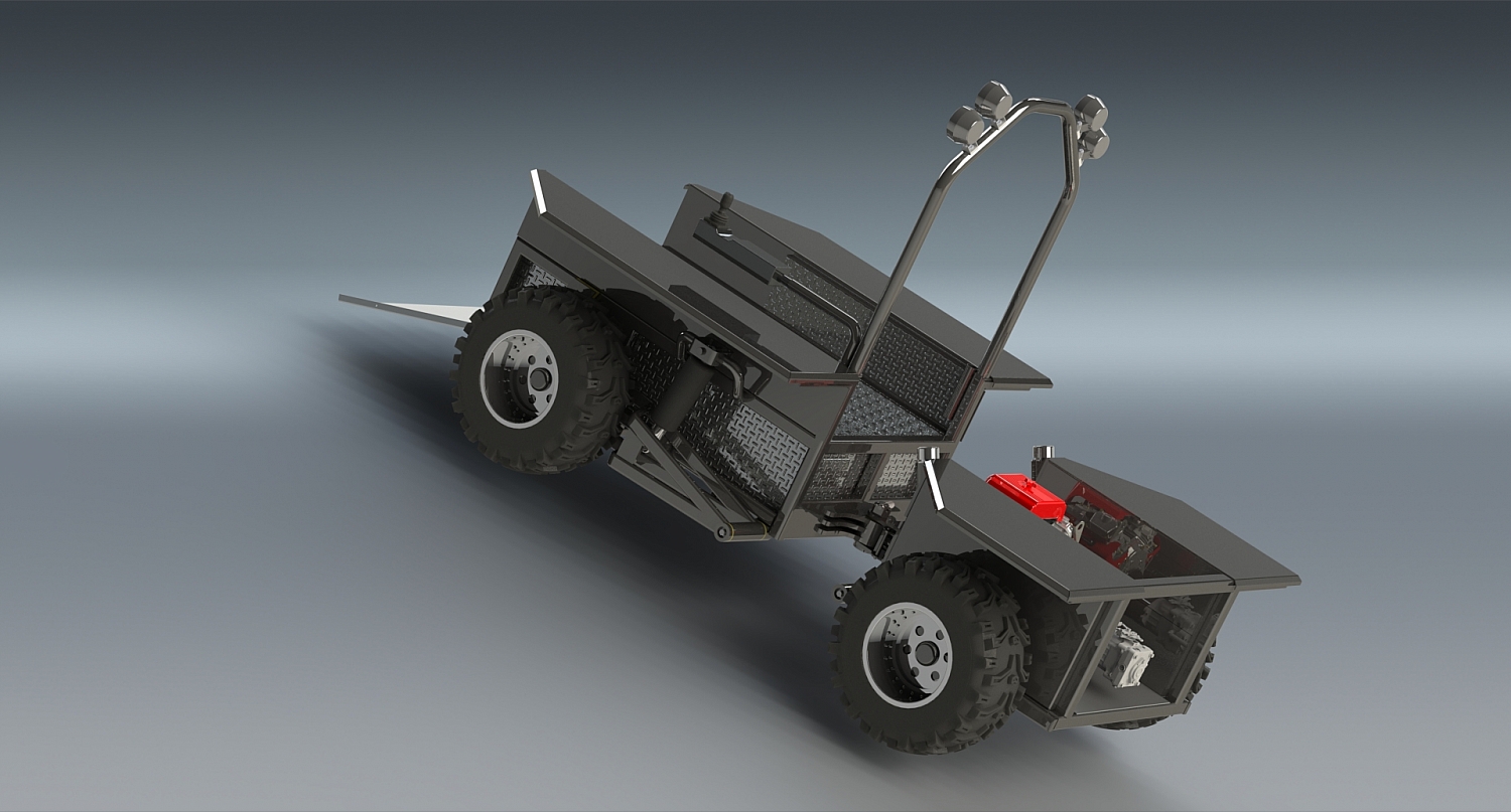

That is correct, it's been a while since I've commented on this thread, we've got way past the main design now. We're working on the front suspension system. The best thing that I can think of is to go with an air ride that will serve a dual purpose, of being able to lower the front end and also work as suspension.
It's not a cheap alternative but it should function well.

I planned on using ride tech airbag suspension. They built a suspension for ATVs that should be for the perfect weight of my machine.
Also the reasoning for multiple pumps is that one pump will run the right side and the other pump or run the left side. Apparently this is common practice with four-wheel-drive machines, they do it for steering purposes.

Very interesting. Yes I imagine the wheels turning at different rates would be an issue.
Your two wheels on the inside of the turn will need to turn slower than on the outside of the turn. But I'm not sure how this is controlled when you use articulated steering. Is there a valve that reduces hydro output pressure to one side as the vehicle turns?
/ Hydrostatic ATV
#139
The electronic actuator on the pump will control the flow to each side for each pump. So there doesn't need to be a valve. Just a manifold to control the flow to each motor on each side. I guess theoretically the machine could be steered that way without having a hydraulic ram attached to the articulated steering system.
